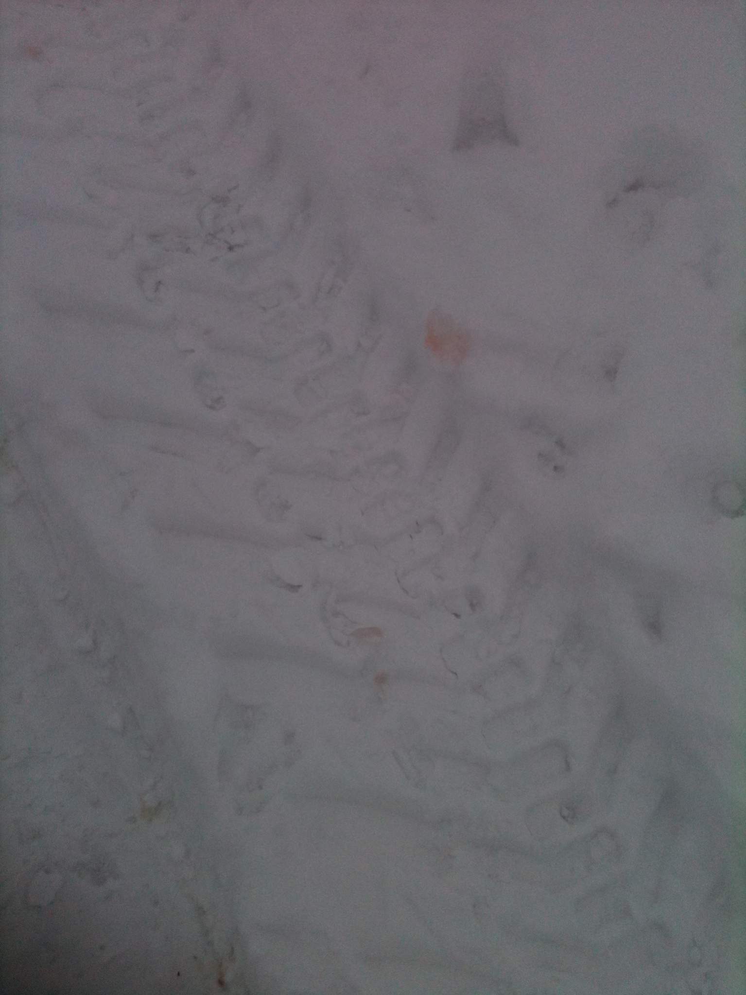

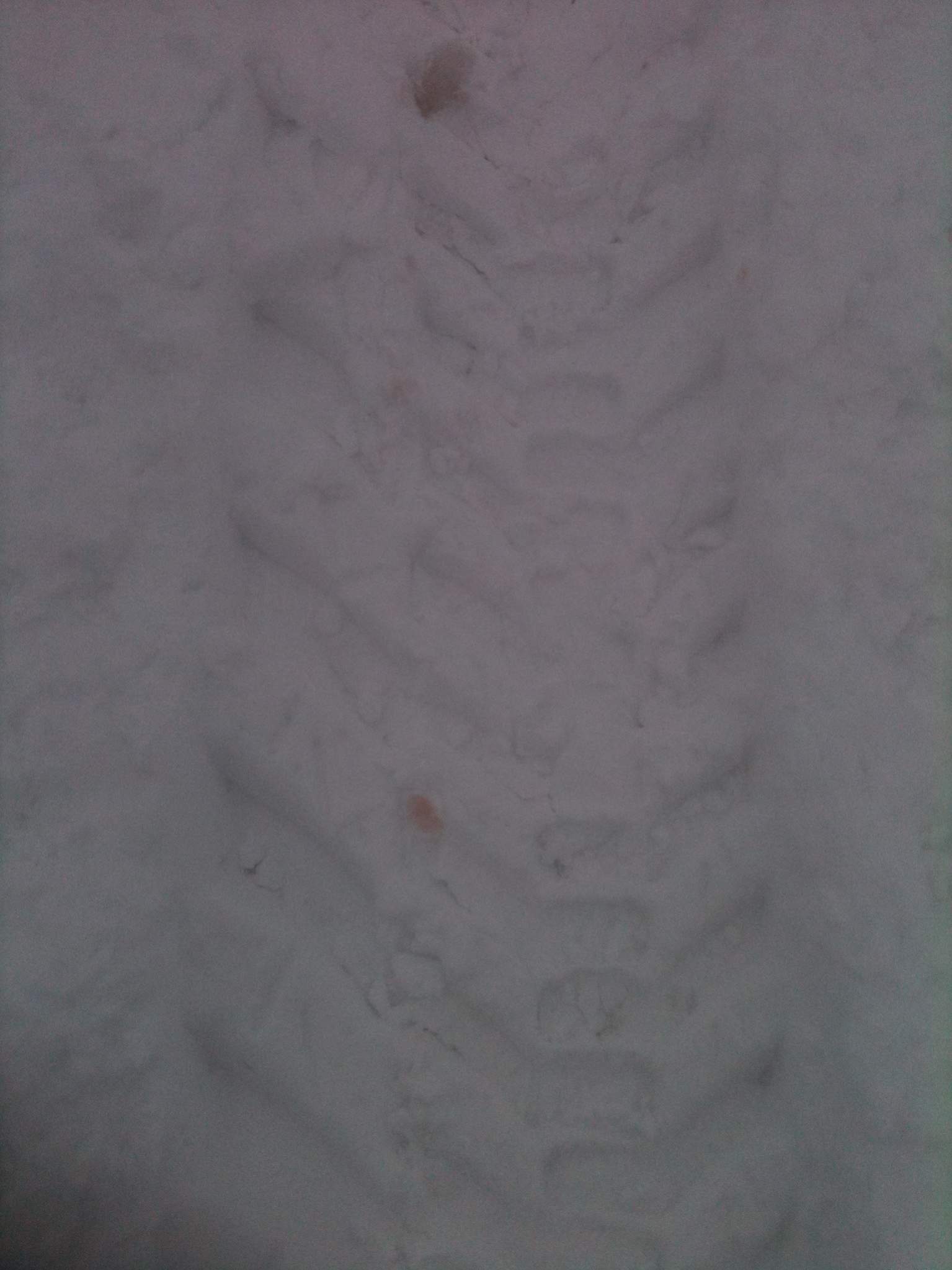

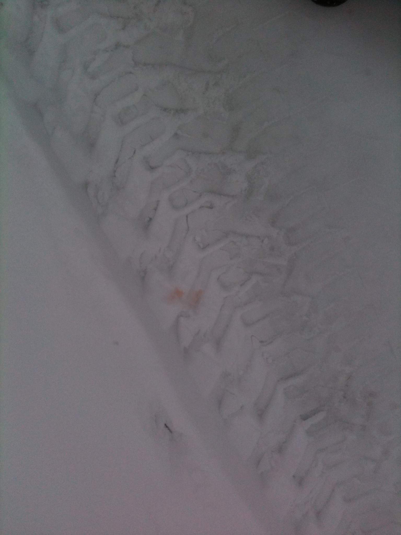

Pics.... no smell, feel of oil, taste:eek::eek:lol No clue after 4 yrs as to what it is... maybe Deere's way of marking their territory:eek::eek:

Is it always in the tire tracks?
   / Getting pink spots on snow when using 3032E #40
Does the trans have any vent that vapor could be coming from when it's worked real hard?
Any grease fittings weeping? That's if red grease was used.
