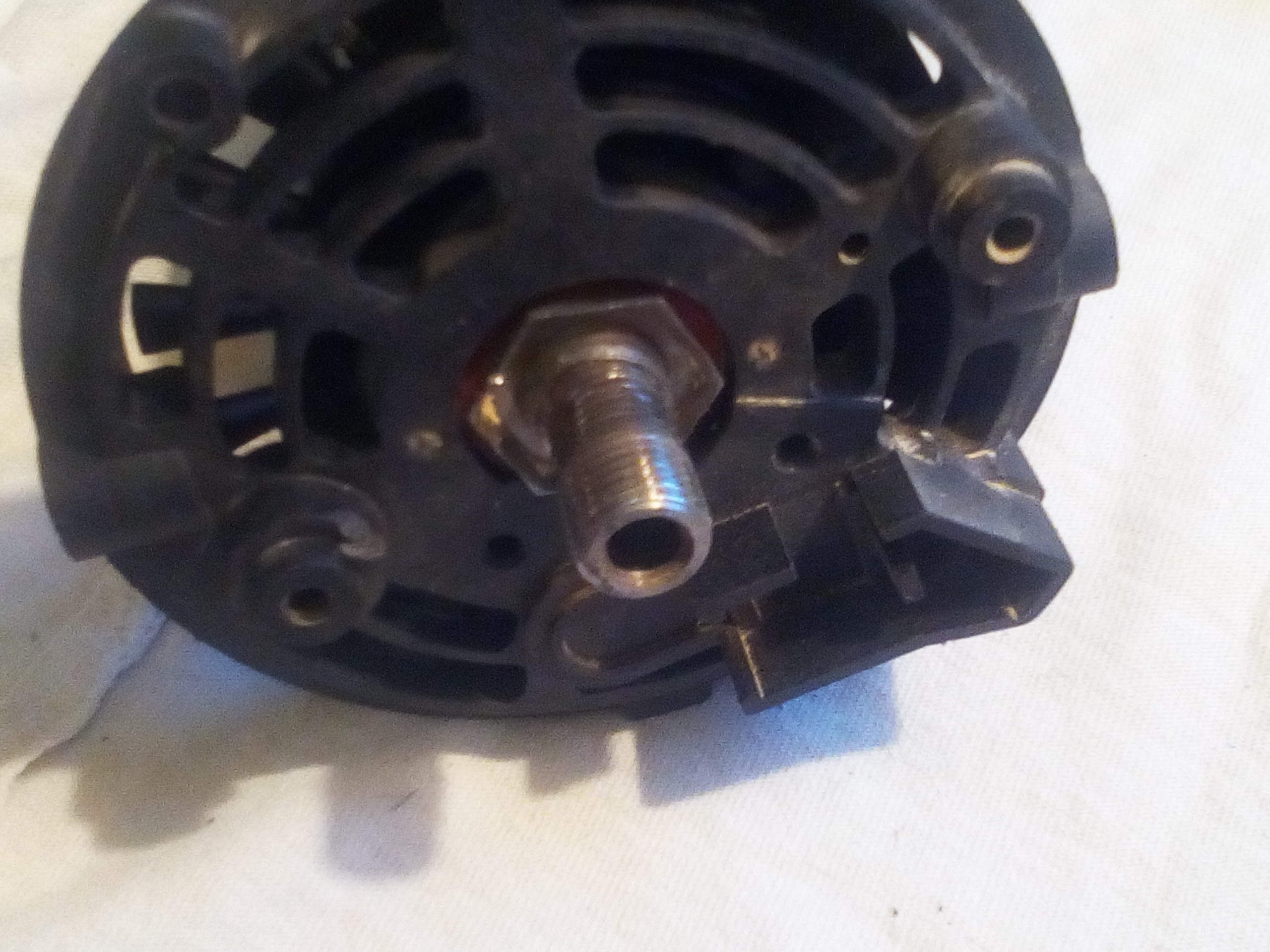

Not tractor related, but since we don't have a tool thread and since this is where the HF thread is...
Picked up a B&D 7613 type 4 router that has a bit of play in the lower bearing. There is a formed nut holding the armature against the bearing, which is secured from inside the spider. The nut is recessed, and there isn't room to get anything on it to hold onto it.
It looks like it's 7/8"; I suppose I could turn down the end of a socket and hope it holds together, or hog out some of the plastic around it and hope that it leaves enough meat so the bearing seat is not compromised.
Normally I can whip these kinds of problems; I imagine that they have a special socket to install these so they aren't user friendly. I've already gripped one side with a very thin set of pliers, it's on pretty tight. Any ideas appreciated.

Could you put a thin chisel or a screw driver against the edge of the nut and tap it. Often to get a stuck nut going in a tight area I will do this. Once it free you can then spin it off by hand.

Buy a cheap deep socket and turn or grind it down till it fits. ( than use an impact if you have one )

either one of two, either the socket they use fits inside the nut, or the socket they use don't have material where the points of the nut are, which just leaves fingers turning the nut. it appears to be a formed steel nut, not available anymore. #62 on the diagram. you'll have much better luck here. Router Forums - Router Forums

How about doing the 'double nut' on the shaft itself?

I worked in an electric motor shop for 30 years, but not on motors that small. Most have a bearing cap on the inside to capture the bearing in the housing. I would take the two screws on either
side of the shaft and see if that lets the housing slide off of the bearing. It may not come easily but don't get too western with it that you break it! That should leave you with the bearing exposed and full access to the hex nut.

With your calipers, find a nut that would fit snugly inside that formed nut,
Clamp the nut in your drill press and drill out the I.D. until it will slip over the shaft.
Slide the drilled out nut over the shaft and press into the formed nut.
Remove with a deep socket.

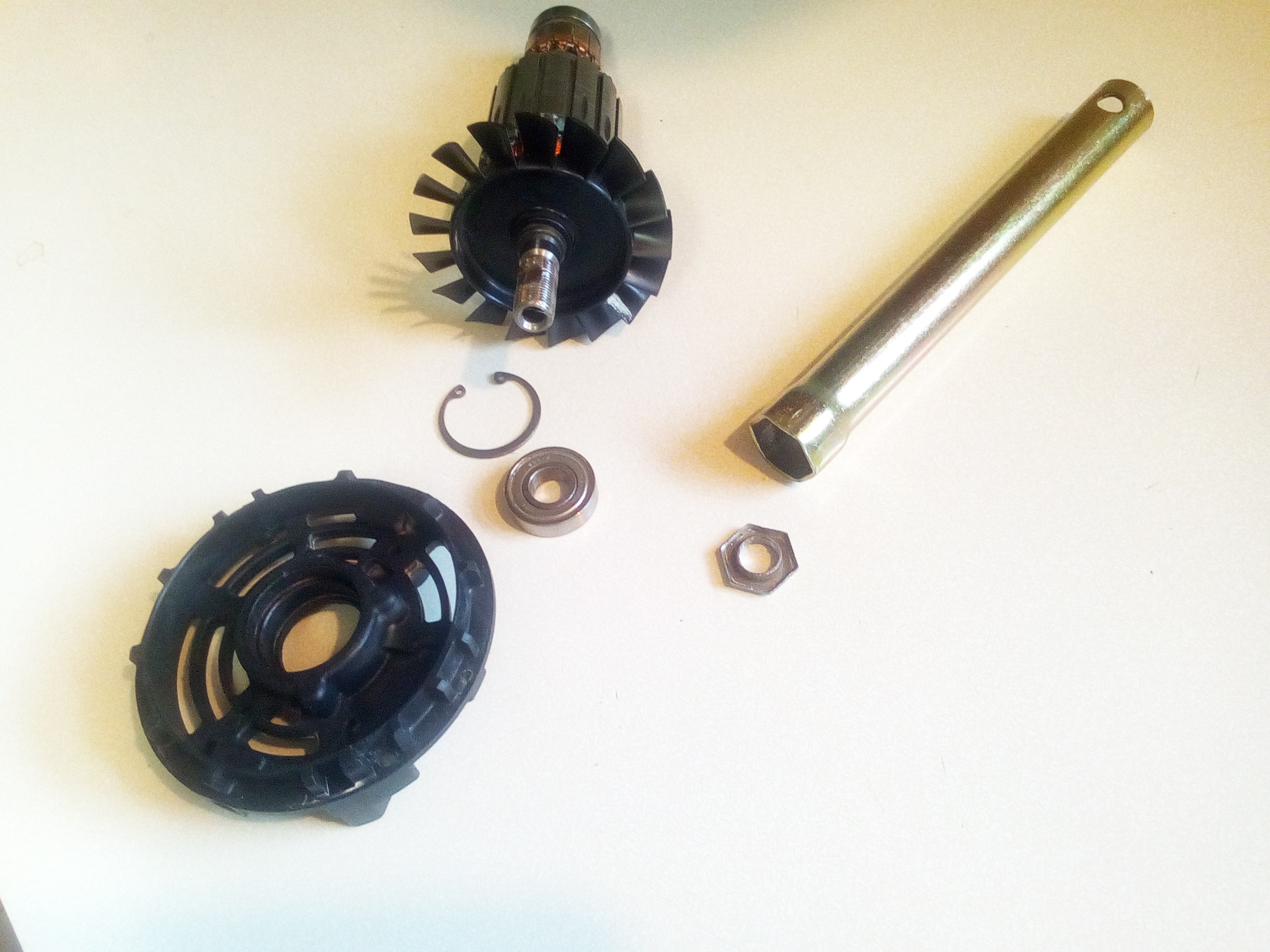

The fan, which is bonded to the armature, is immediately behind the plate, so there is no way to get to the back side of the bearing without the formed nut coming off first. There are no utube vids or anything I can find regarding this. Apparently B&D considers this a disposable item.
I'm going to try a chainsaw sparkplug wrench if I have one in that size. I suppose if worst comes to worst I can cut it off with a Dremel skinny wheel and make another with pin holes, like a grinder has. Don't want to go to that much trouble though.
The sparkplug wrench worked; it was one that came with a HF chicom engine, but it took it right off. Didn't need an impact, it wasn't on that tight, put the wrench in the vice and turned the armature. The bearing was stuck to the shaft pretty good, but the smallest of a HF 3 jaw puller got it off without damaging the plastic.
Now the problem appears to be that the bearing is good, but the play is from the pocket being wallered out a bit, the bearing fell right out when the snapring was removed. I need to check my brass shim material and see if I can make a foil band to take up the slack.

On the assumption that the housing is white metal or aluminum brass might not be the shim of choice, (dissimilar metals) and cause corrosion related problems.
Maybe epoxy set the bearing?

Housing is plastic, and since it was so close a couple wraps of aluminum foil took out all the slack. Not perfect, to be sure, but it will be at least as durable as the ABS housing, and by not forcing it and letting the bit do the work it should last for quite a while, given my limited usage. I did put in a new bearing, since I had one in the bearing box* and it's all back together and running very smooth. While it was apart I chucked the armature in the lathe and burnished up the collector ring with some abrasive tape that was made for polishing video tape heads, a find on American Surplus that I've used a lot for this.
