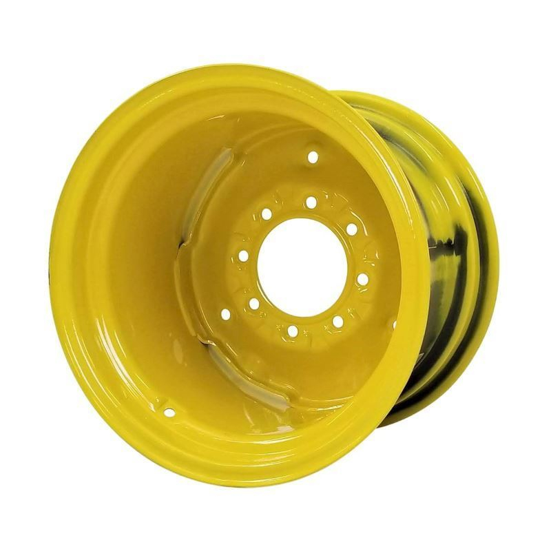

The dealer is incorrect.... an R4 rim is much wider / deeper. You cannot "turn them around or swap side to side
Vs. an R1 rim:
Don't forget the R4's are much wider to begin with. The new R14's fit on R4 rims and are also wider.
Vs. an R1 rim:

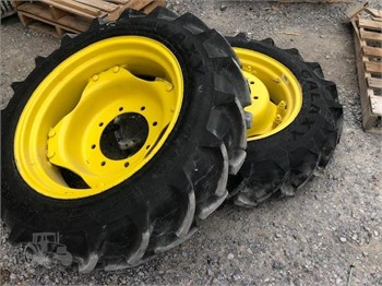

You are correct, 1 piece R4 rims as you have pictured cannot be turned. The OP has a picture of R4s on 2 piece adjustable rims on the tractor that he wants.
His posted picture is an OEM brochure picture with factory supplied tires and wheels. The 2 piece R4 rims are common on full sized utility tractors, I have them on my tractor. Maybe Titan has not caught up with their back logs, but the 2 piece R4 rims are indeed available and were a std item for Mahindra utility sized tractors.

I bought R4s for 2 of my tractors. I was thinking the wider tires would be better on hills. I was wrong, They slide sideways on hills, don’t grip well. Last tractor I got R1, which are almost as wide as the R4s I had before. Will never get R4s again.
