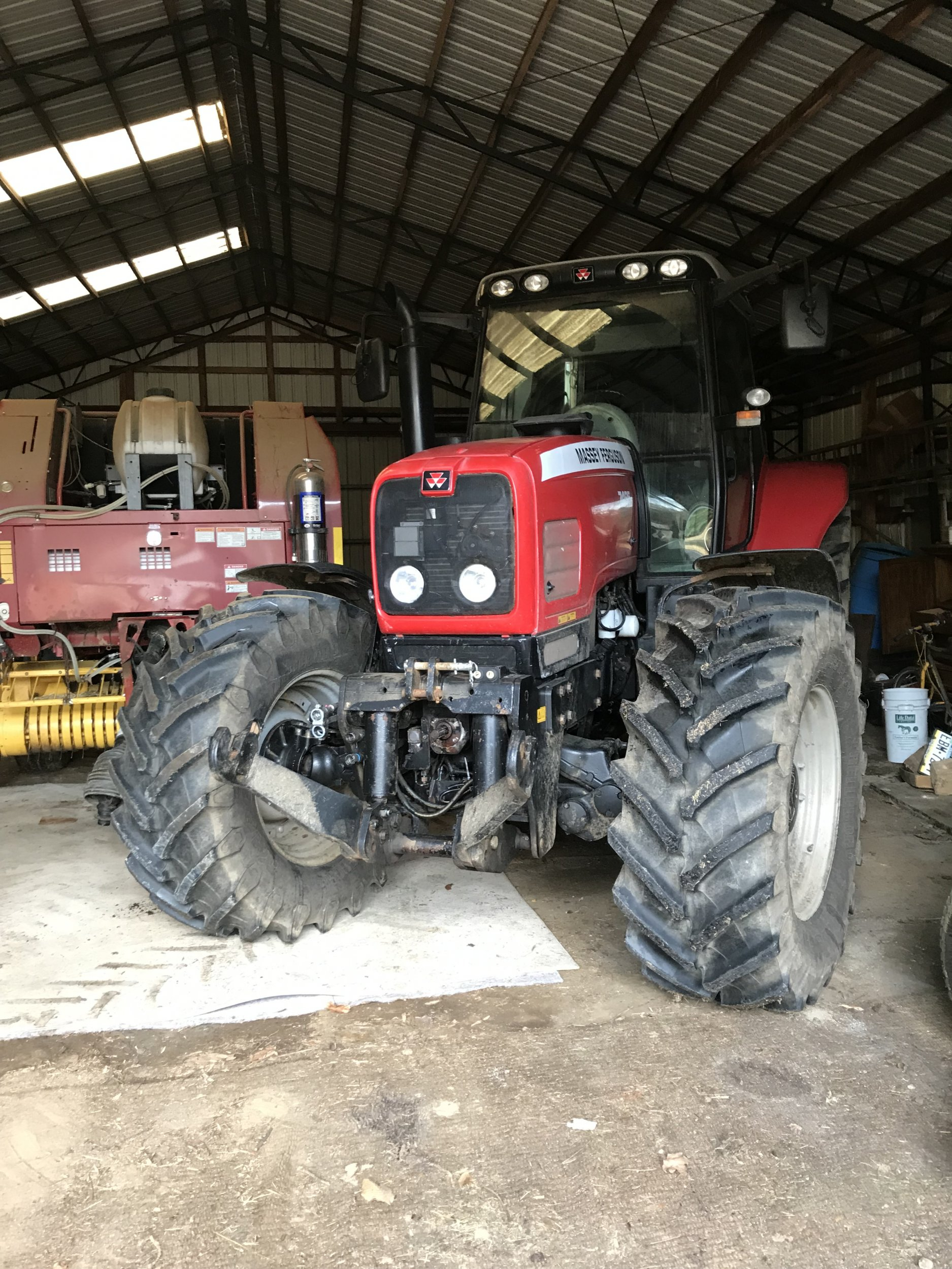

Here is a good example of what Hay Dude is saying. Standard R1 vs R1 Radial tires. Noticeable different not only in footprint but comfort, wear, performance, and so on.
Is it safe to assume the narrower R1 has better traction though? I'm not a physics expert, but i would think same power over less area. That may be situational though.
   / Getting the wheel/tire combination I want on a new tractor #18
The R1 Radial will provide a lot more traction. Hard to tell from the picture but it has slightly deeper lugs and just the overall footprint makes a big difference.
Plus, these tires run at very low pressures to the point that you may look at it and think you have a flat tire but it isn't. It will squat a lot and it's meant to run that way and increases traction big time.
