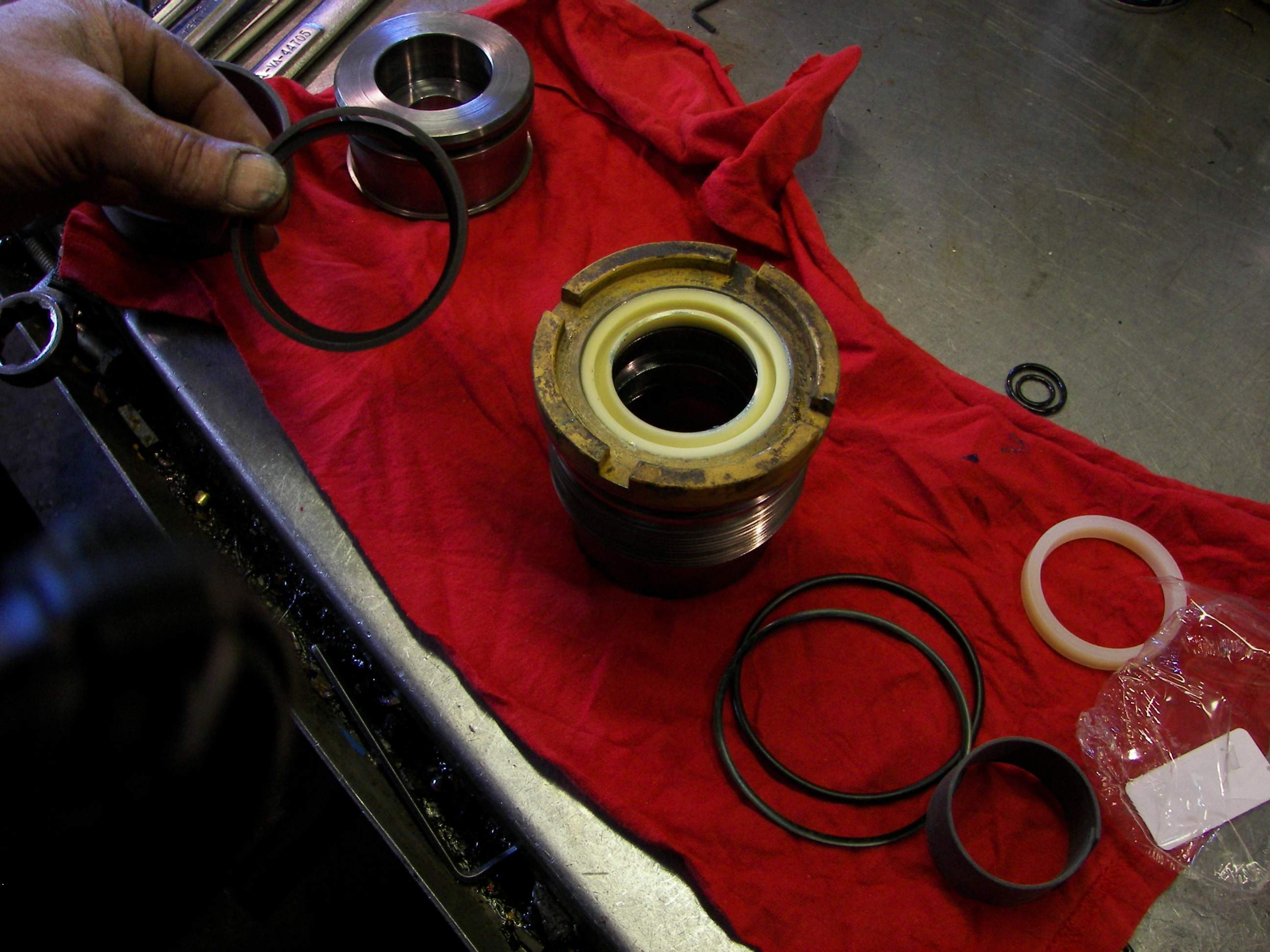

The piston seals on these Cats work under extreme pressures, here's what your piston seal looks like....(This pic was today repacking a Cat 416 Boom Cyl) it's the same seal kit in your tilt cyl......1.875 Rod X 3.250 Bore......
Anythings possible when it comes to hydraulics....These seals can hold in one direction only if its damaged or the bolt loosened up......
The seal being held is the 2 piece piston seal.....that seal holds up the entire bucket when its working right.....
