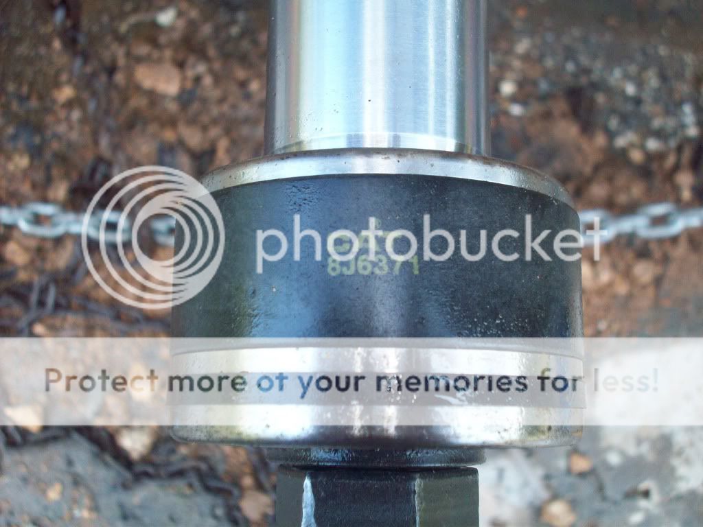

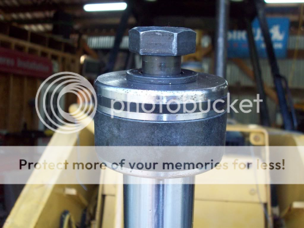

I finally got the cylinder apart and everything looks good inside of it... I will post pics in a bit so you guys can tell me if you see anything wrong, but I doubt its the problem. Im at a loss here, the valves have been re-done and the cylinder is good.... What else could it possibly be??:confused::mad:
EDIT:: Pics attached. The bolt was completely tight when I pulled the cylinder apart... In the pics its loose, I took it out. On another note, if its not the cylinder the shop that re-did the valves "gulf hydraulics" will repair the machine on site at not charge to me or I will take them to small claims court.

Don't forget to put a straightedge on the outside of the cyl barrel in several spots....(in case it's blown/swelled out)
