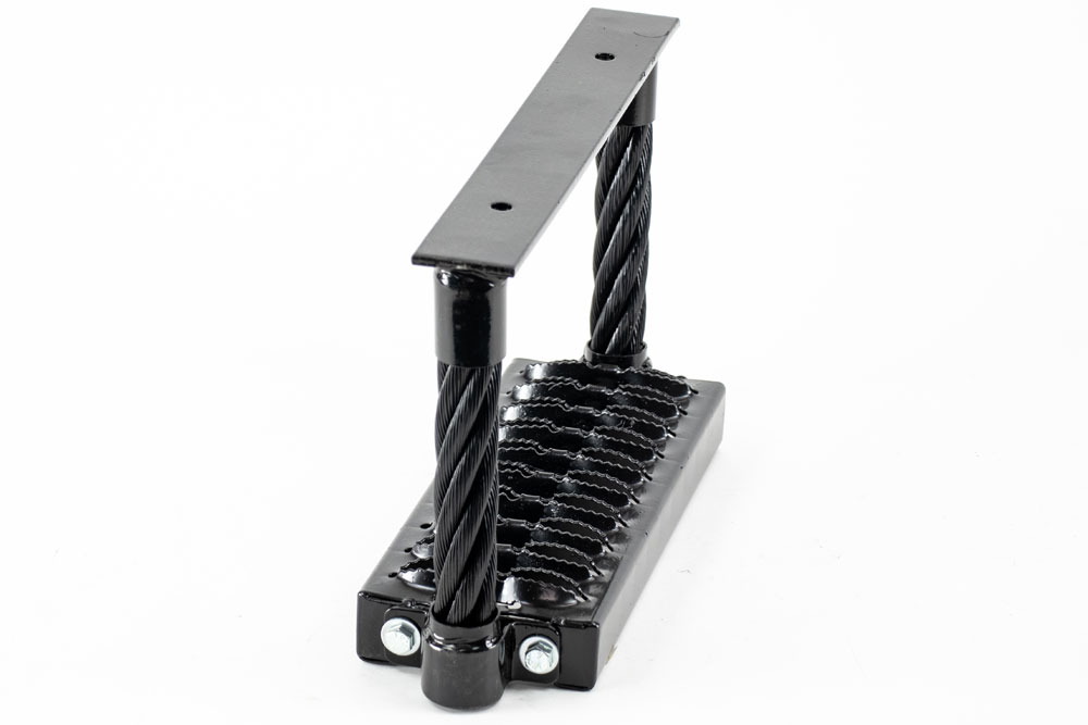

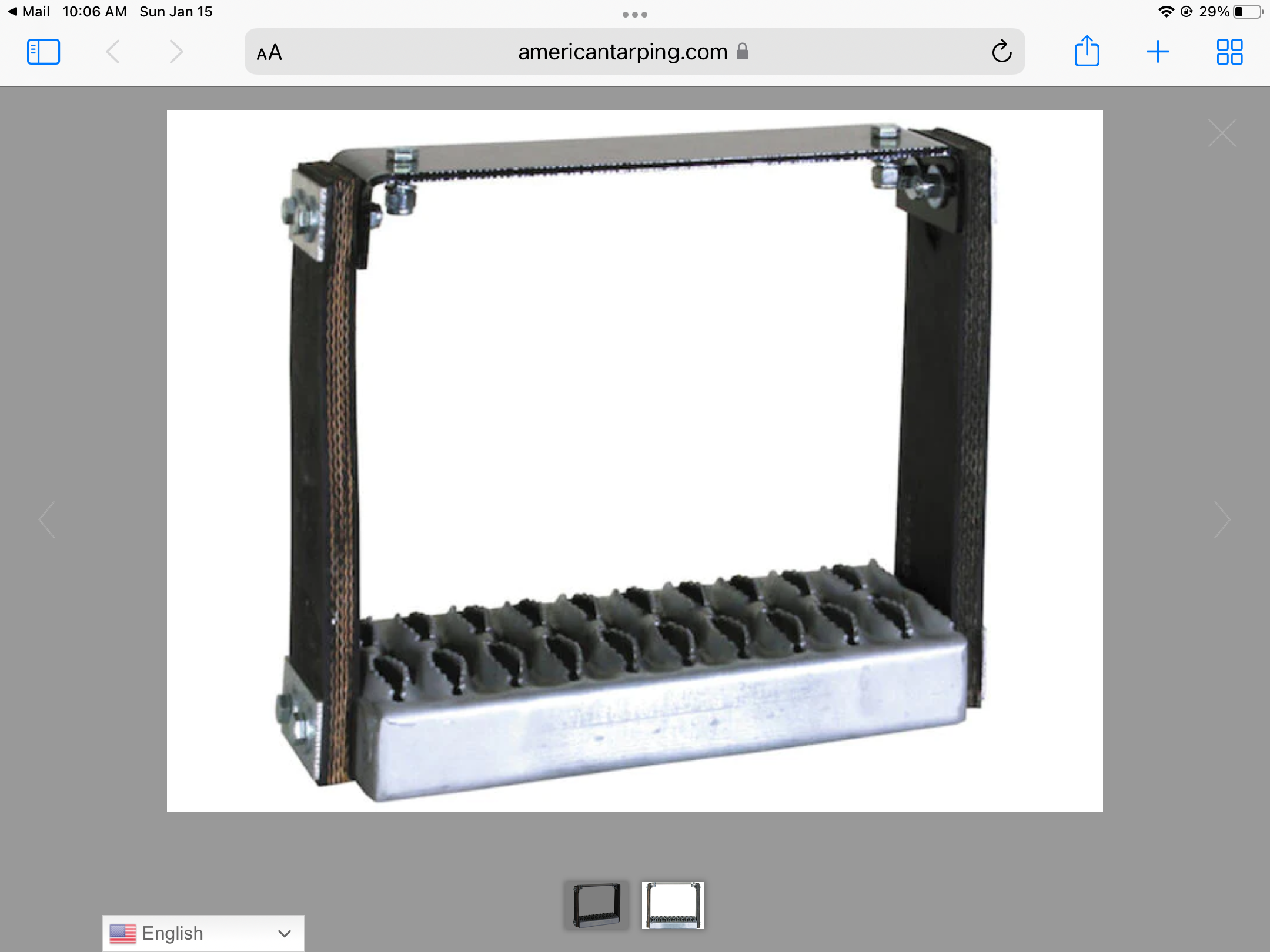

For a home-brew step on a tractor, I'd borrow the idea on a lot of utility trucks' rear steps- make the uprights from 3/4" to 1" steel cable. Stiff enough for support; flexible enough to survive hitting something.
A picture is worth a thousand....
The second one from a scrap tire might be easier, especially with multiple rungs.
