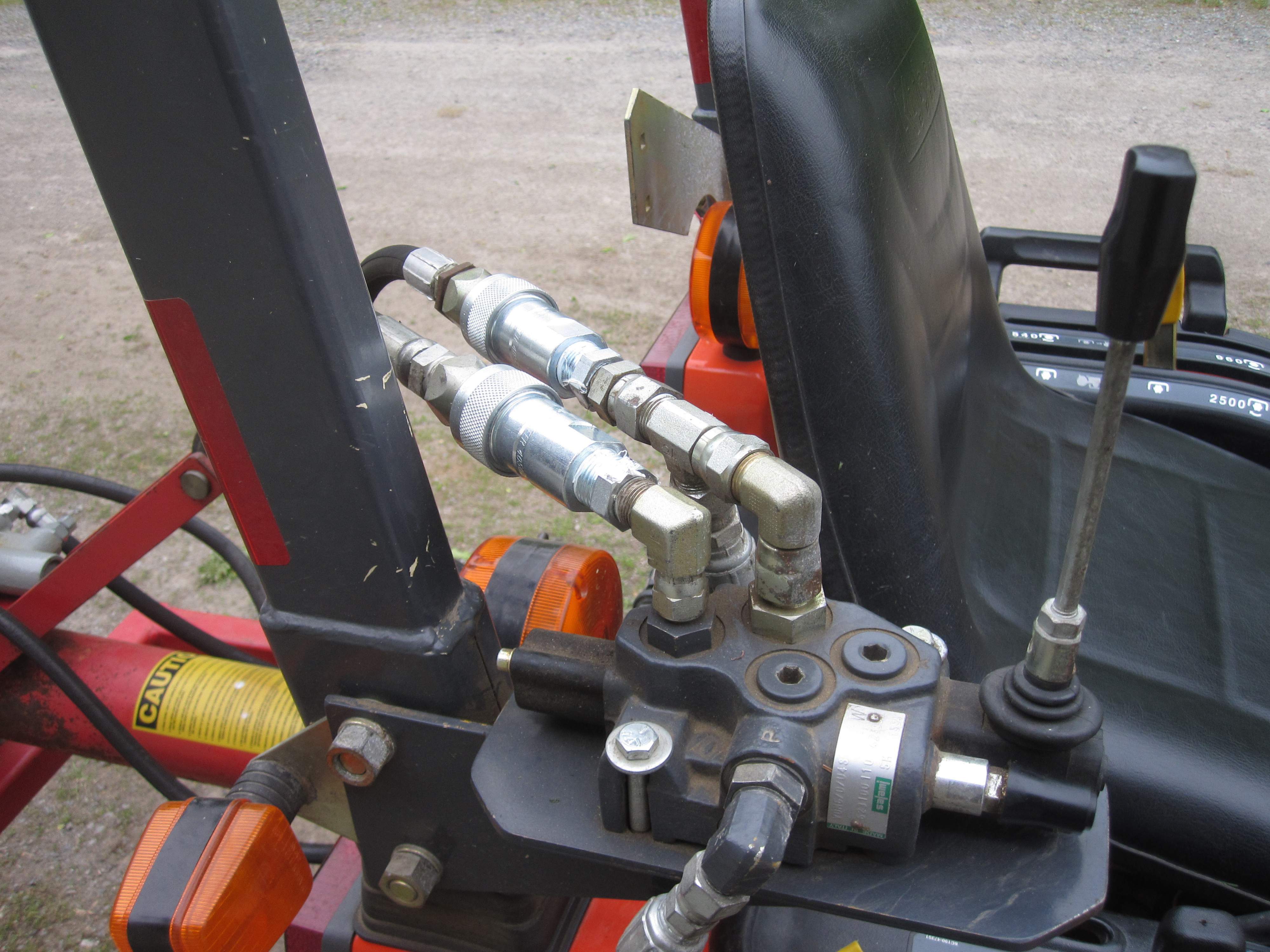

- Remotes: I switched the ends to fit my log splitter and tried it. Not bad at all. The splitter seems just as fast (not very) as when mounted on my 35 hp. TAFE, maybe a bit faster. My line pressure gauge reads 2600, which seems high. I tried to adjust the nut. The lock nut came loose easily, but the inner nut seemed to be soldered to the larger round end on the housing. Is the whole thing supposed to turn? I put all of the force I judged appropriate onto the end of a 9/16" wrench and nothing moved. Perplexed.

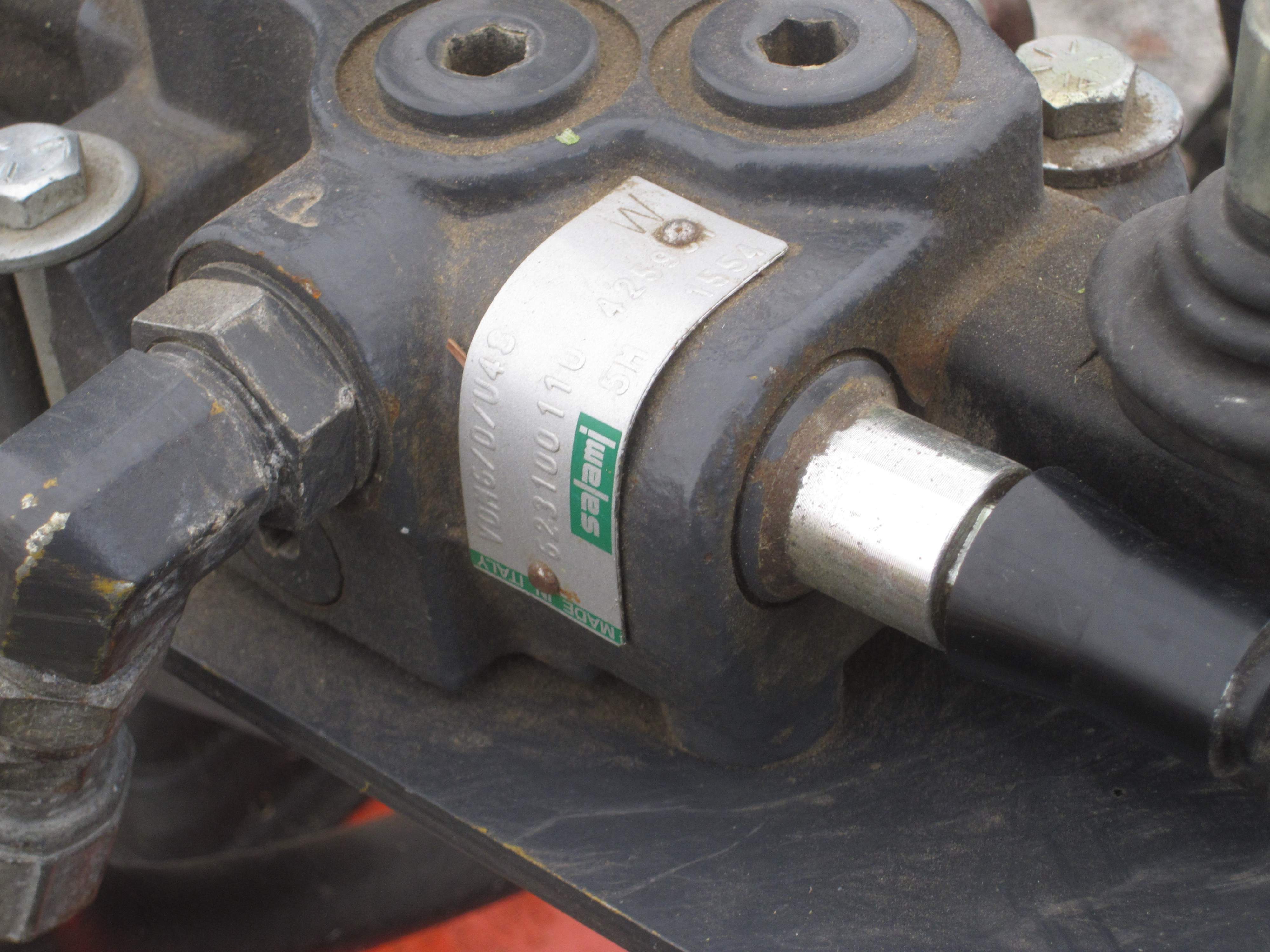

IMG_6489.jpg I'm still stumped by the adjustment of the relief valve...

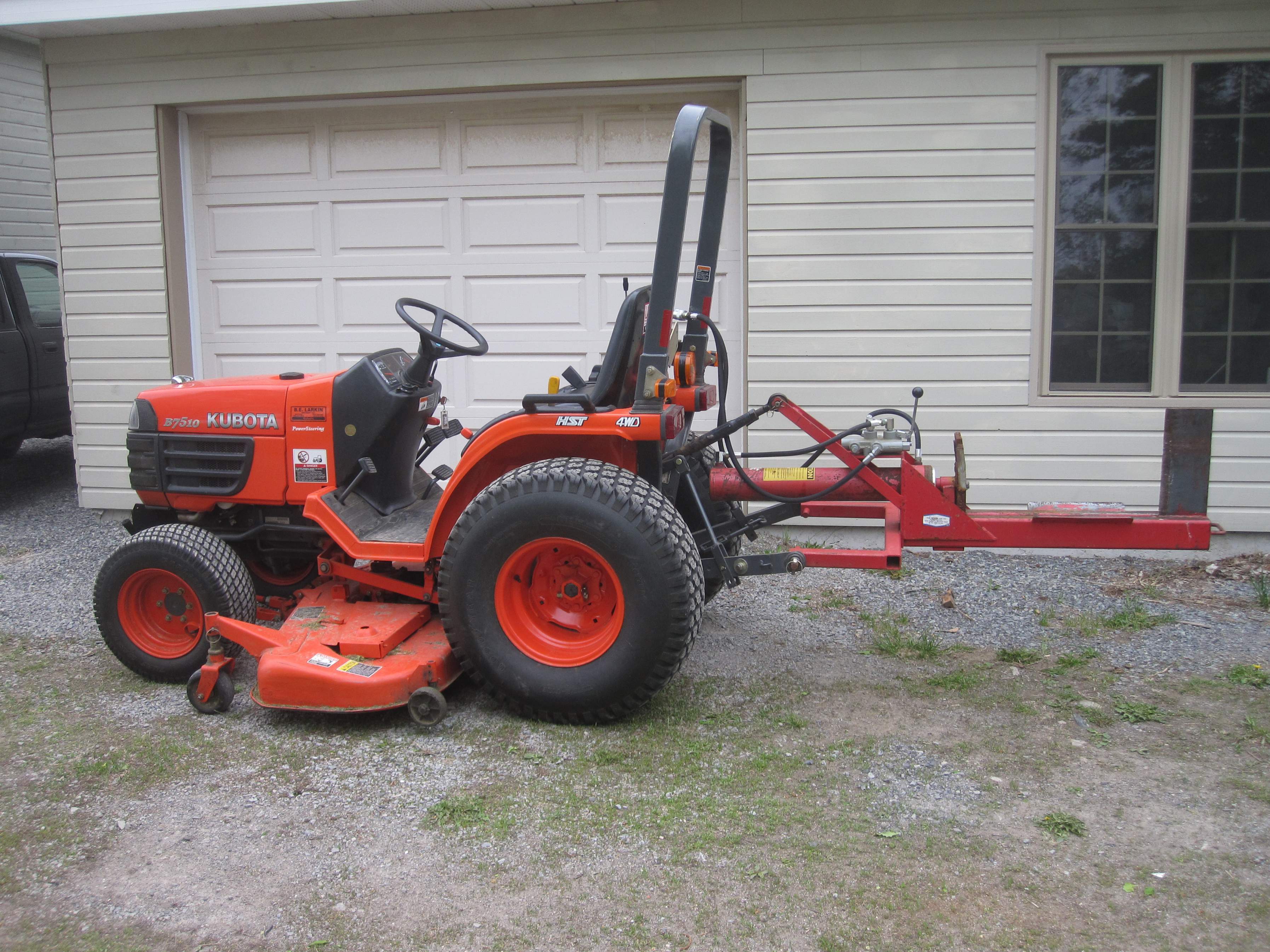

On the other hand this morning I mowed an area which I believed only my Bolens in 4WD Lo could cut, and the 'Bota did it with insolent ease.
The row is basically a pile of small boulders with a bit of soil attached, tossed up by a backhoe digging a ditch. It happens to back the 400' flower bed which runs to the road, so I have been under considerable pressure over the years to keep it mowed. When we bought the Ranger I did haul enough topsoil into the area to allow a mower to roll along the ridge without high-centering or falling into the ditch, but at considerable risk to the blades. Anyway, the Kubota with the mower lifted trimmed the stretch just above the jutting rocks and with improved safety and control.

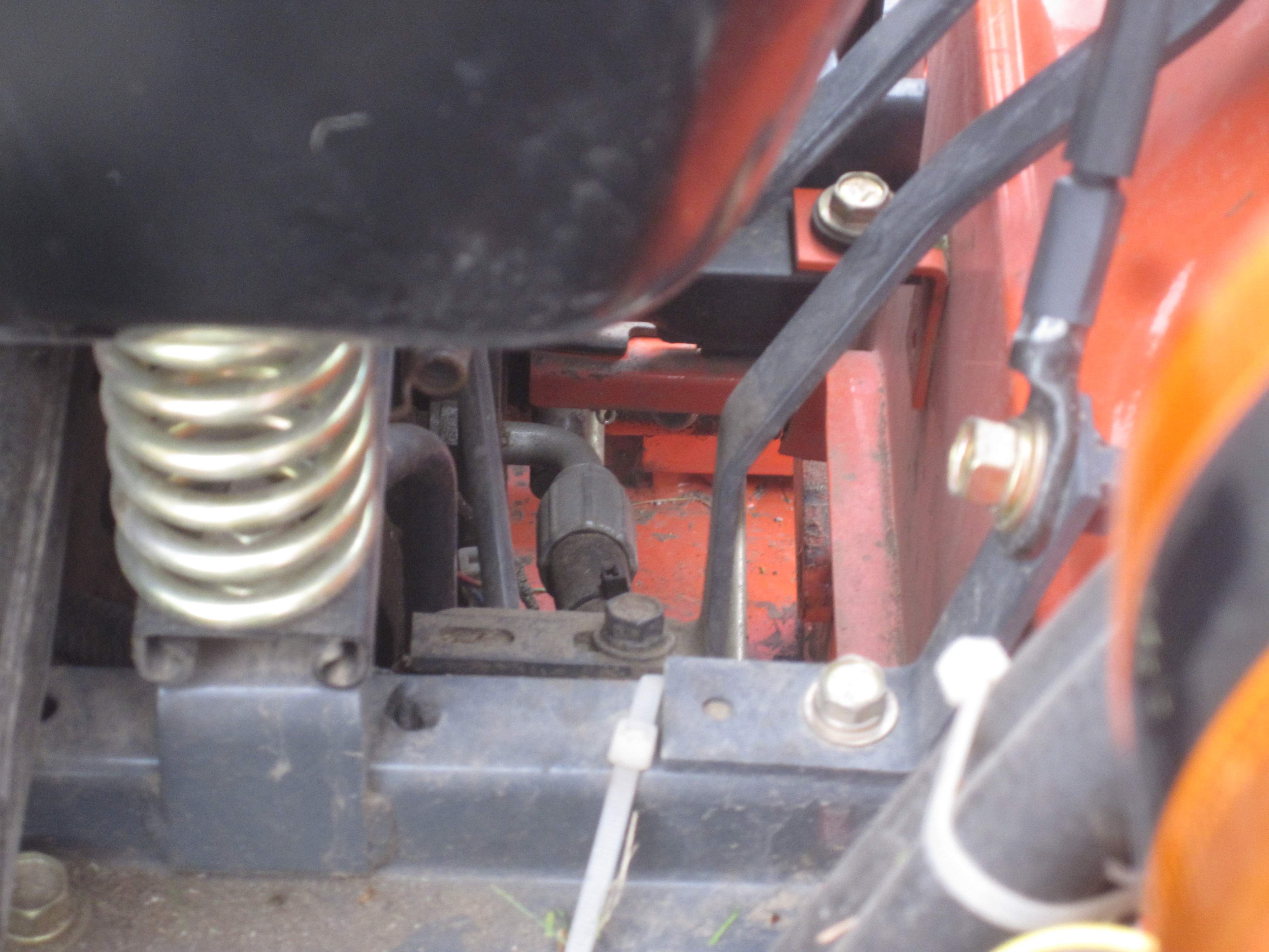

Where are the other end of the two lines to that valve connected to the tractor??
The third line which makes a 90 degree turn toward the centre of the tractor is from a T on the outfeed line. The other two come to the block pictured just below the right foot controls.
I looked up the Salami VOM6 hydraulic control and downloaded a diagram. The nut I tried to turn in an earlier attempt is in fact the adjustment. I just have to turn harder.
