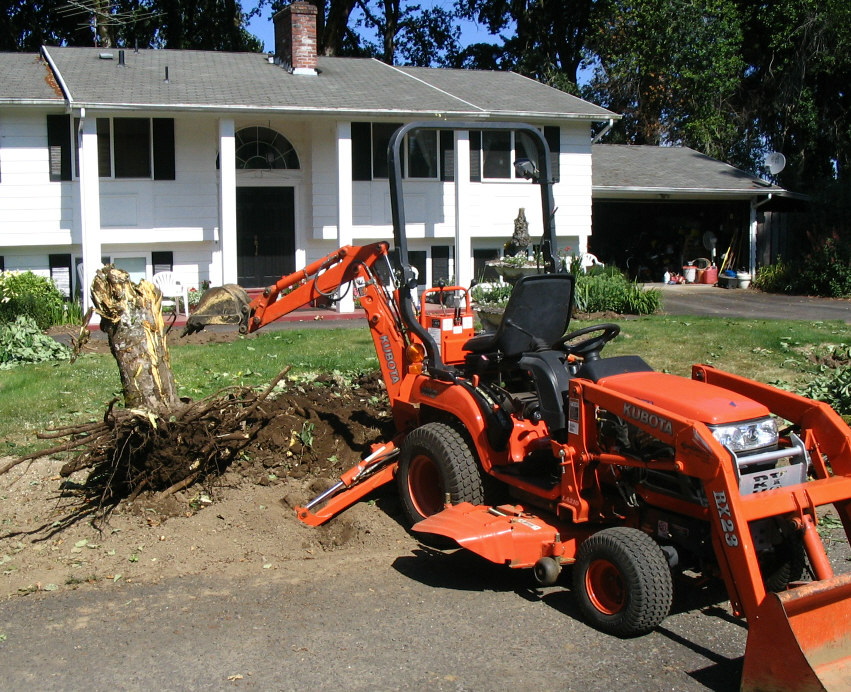

I own/use a BX23...Best investment (so far) I've made...Has a 54" mmm along with the backhoe and front loader...HST and is So easy to use...Good luck.
Don
