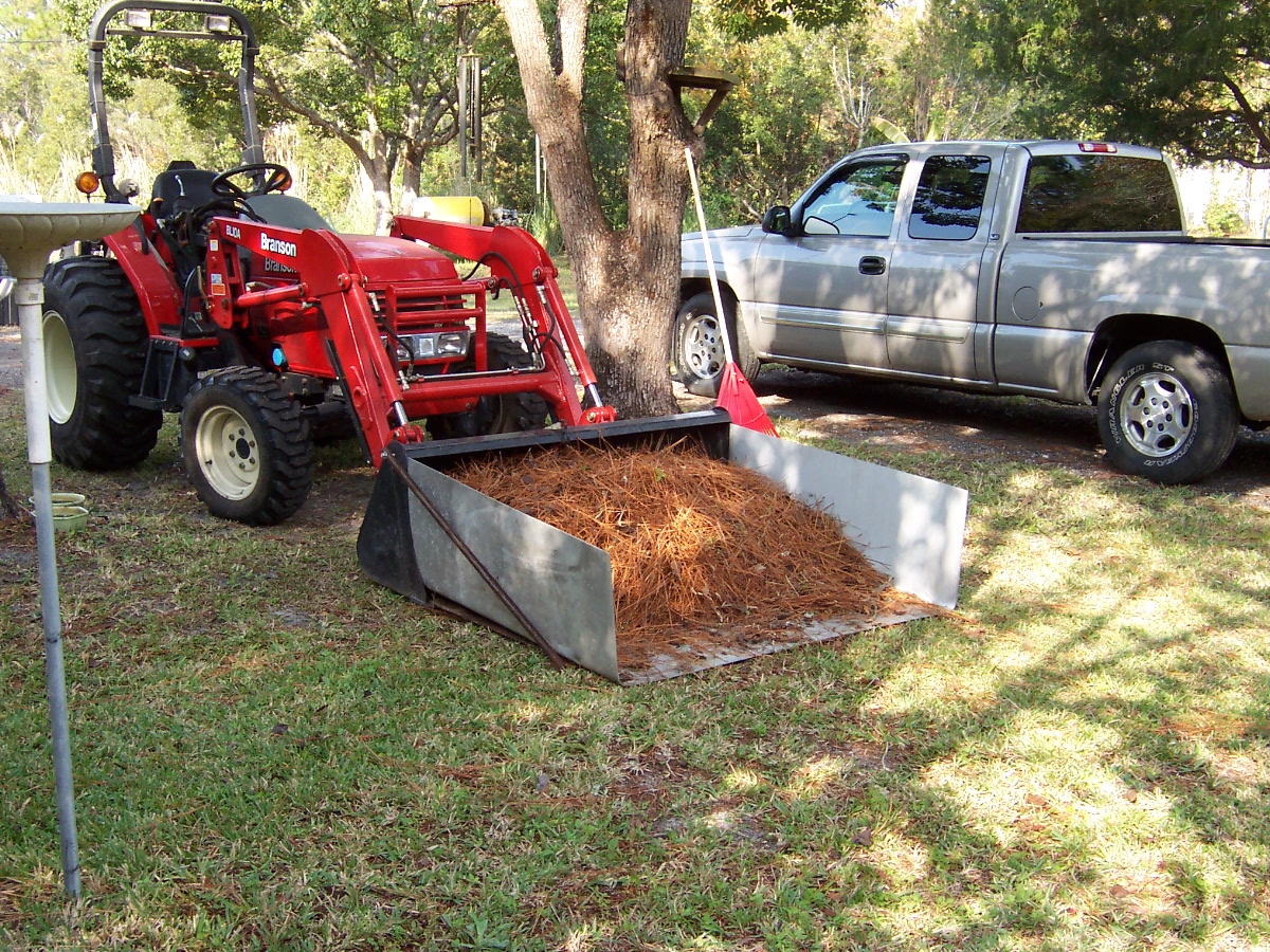

   / Girl needs sub compact tractor purchasing advice #69
Here is a pic of my tractor with R-4's. I would not have any other tire! They are easy on my grass and with 4WD hard to get stuck.
