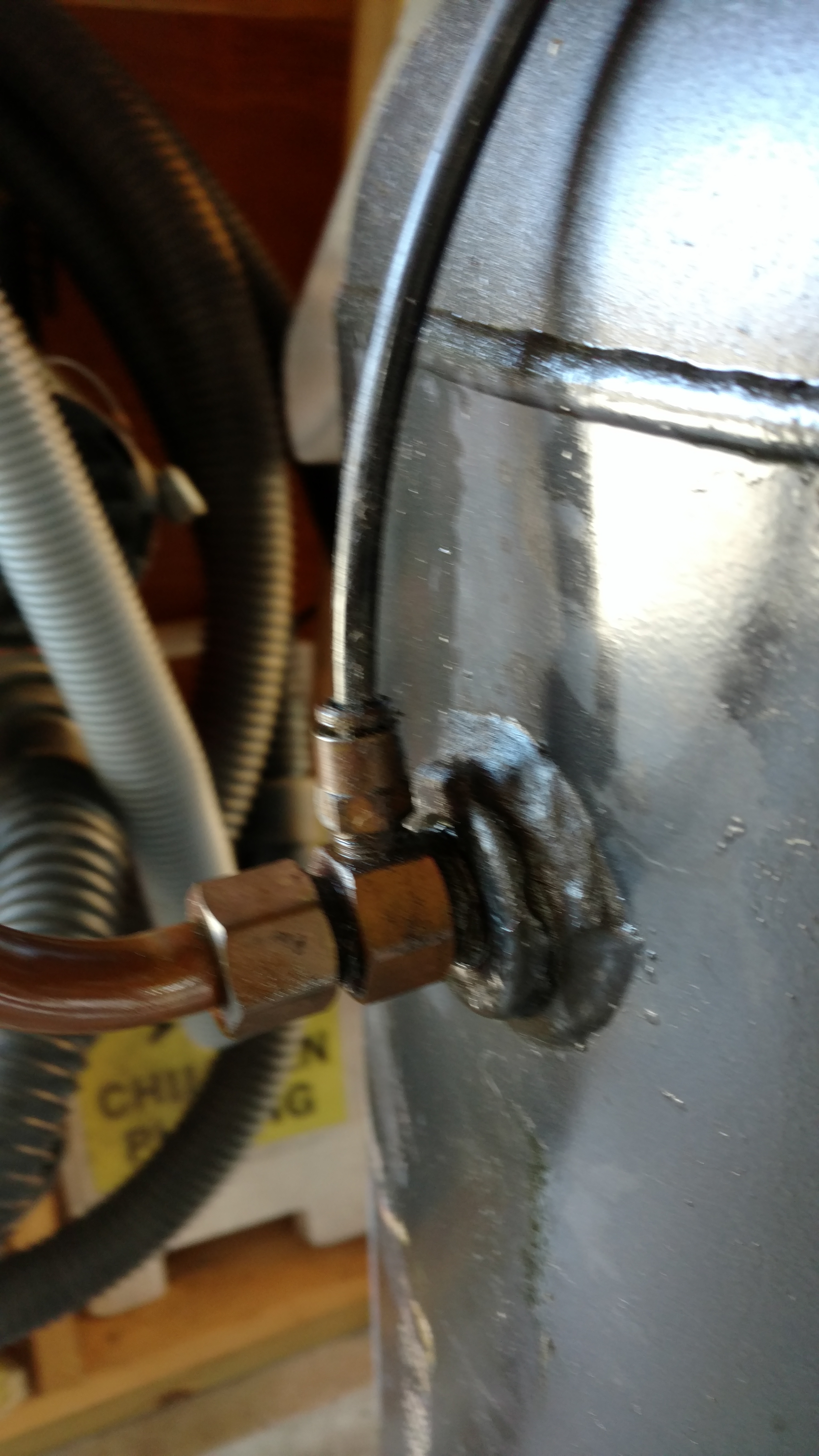

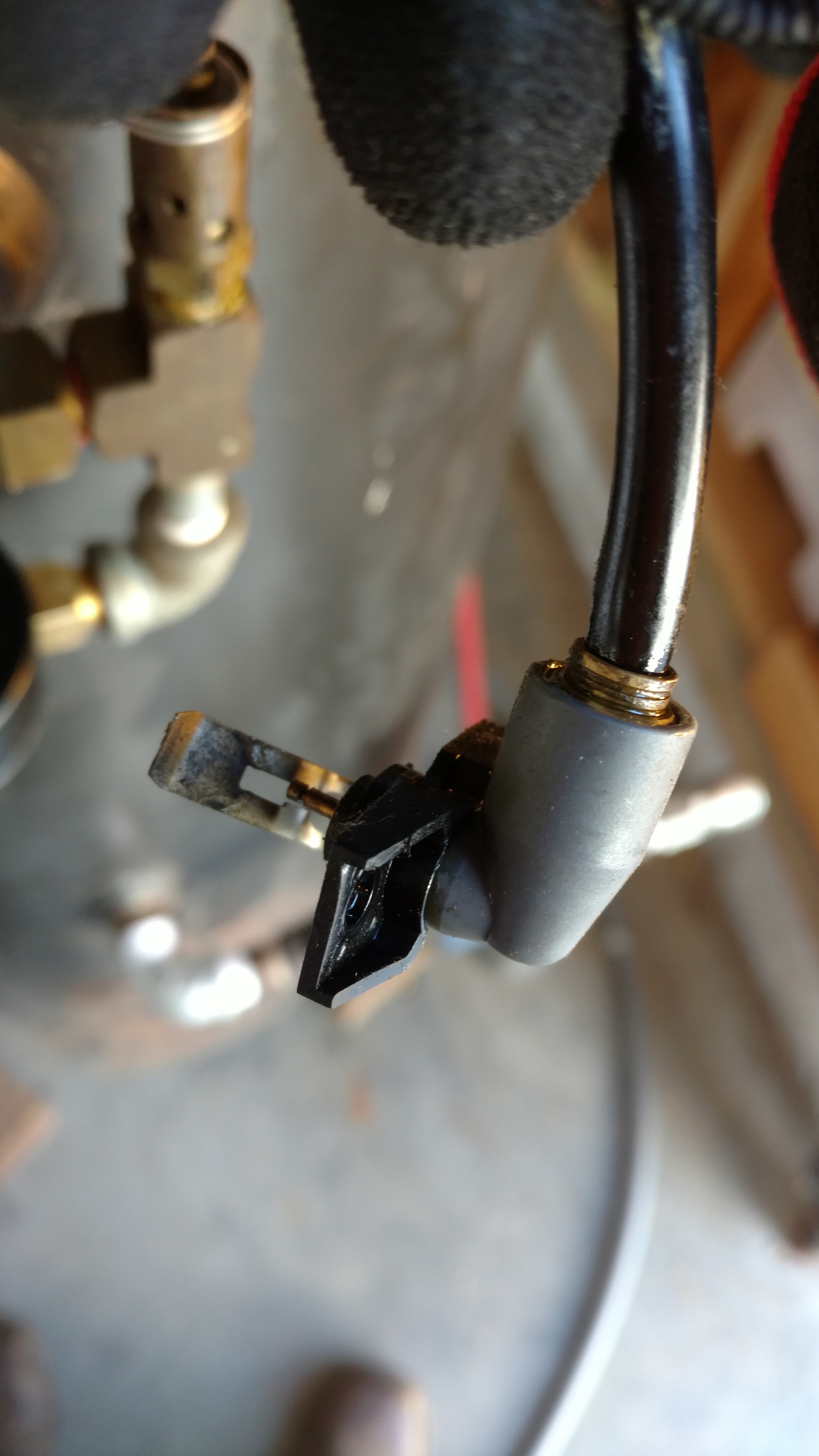

Ok, need some help again. I feel kinda silly but I went to install the new switch today and noticed the switch has TWO pressure lines going to it. I think the one I hadn't noticed is a safety shutoff if the switch malfunctions and the tank over pressurizes? The switch I bought has only one pressure input. I think I can just remove the second pressure line and be fine. here are some pictures:
Origin:
Where it actuates on the pressure switch
   / Given an Air Compressor Today #43
One line unloads the compressor head (so the compressor starts with no pressure in the head) and the other senses the tank pressure. You have to start the compressor unloaded or it won't start...too much resistance on the motor.
   / Given an Air Compressor Today #44
Origin:
View attachment 466830 View attachment 466831
Should be an unloader line. Takes pressure off the compressor when off so it starts w/o load. Does it connect to a check valve on the tank end? ... That connection looks too close to the hot line to be using plastic.
No check valve on the tank side (first 2 pics). Could be bulit into the switch side (last pic). The pin you can see moves in and out and mechanicaly contact part on the on/off switch.
