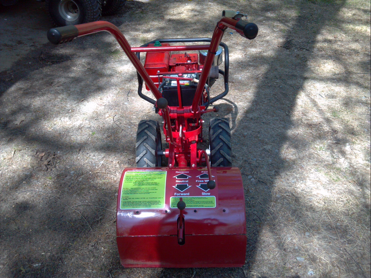

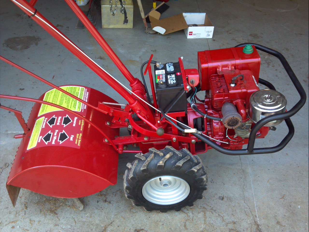

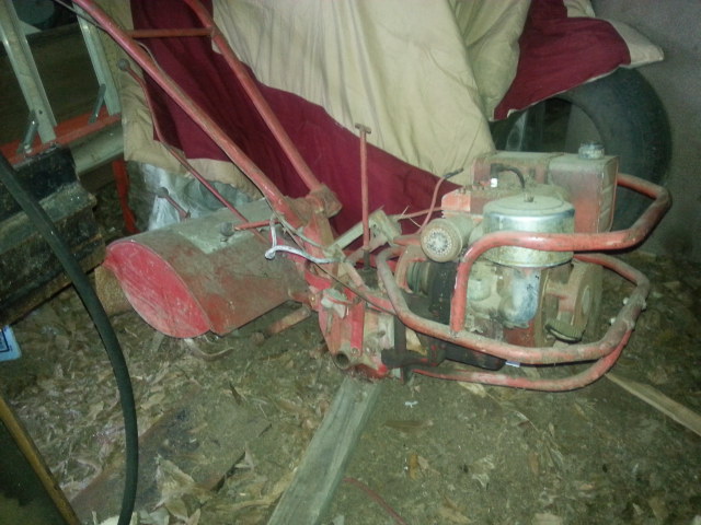

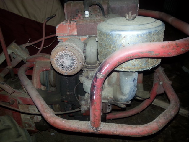

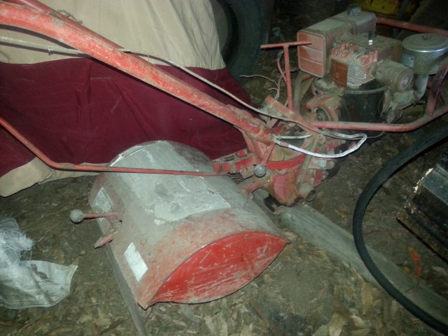

I know this may sound crazy to you, But I have a troy bilt horse 2 made in the late 70's from what I can find on it. Just rebuilt it from the ground up after finding it in a barn in pieces. I have been running Mercury Quicksilver High performance gear oil in it for the past 3 or 4 years with no problems at all. I do check it to see if it has changed color (its a nice looking dark green when new) and so far again, no problems. Here are a few pictures of it when I got it verses what it looks like now.....
These are before.....
These are after a rebuild....
