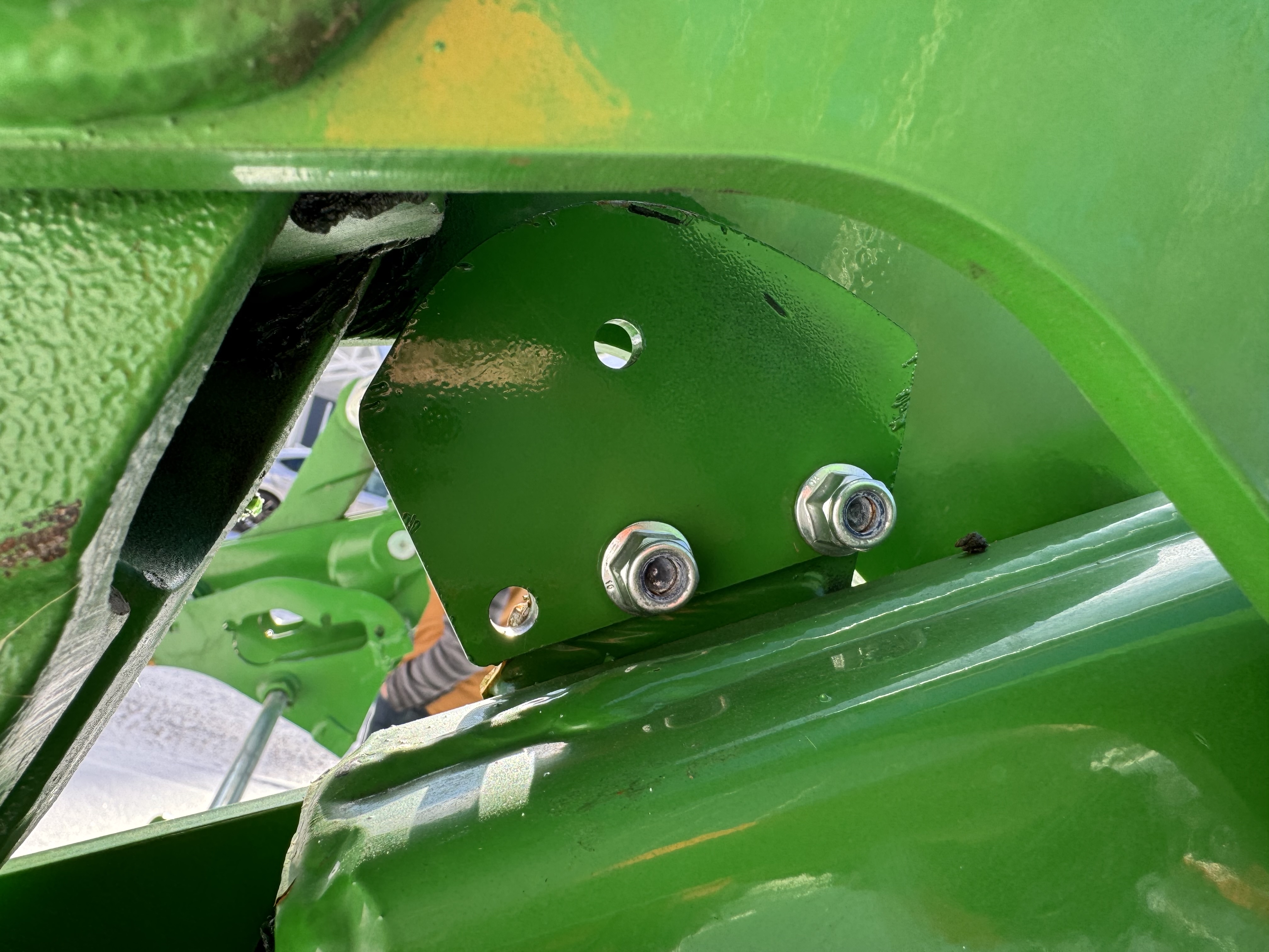

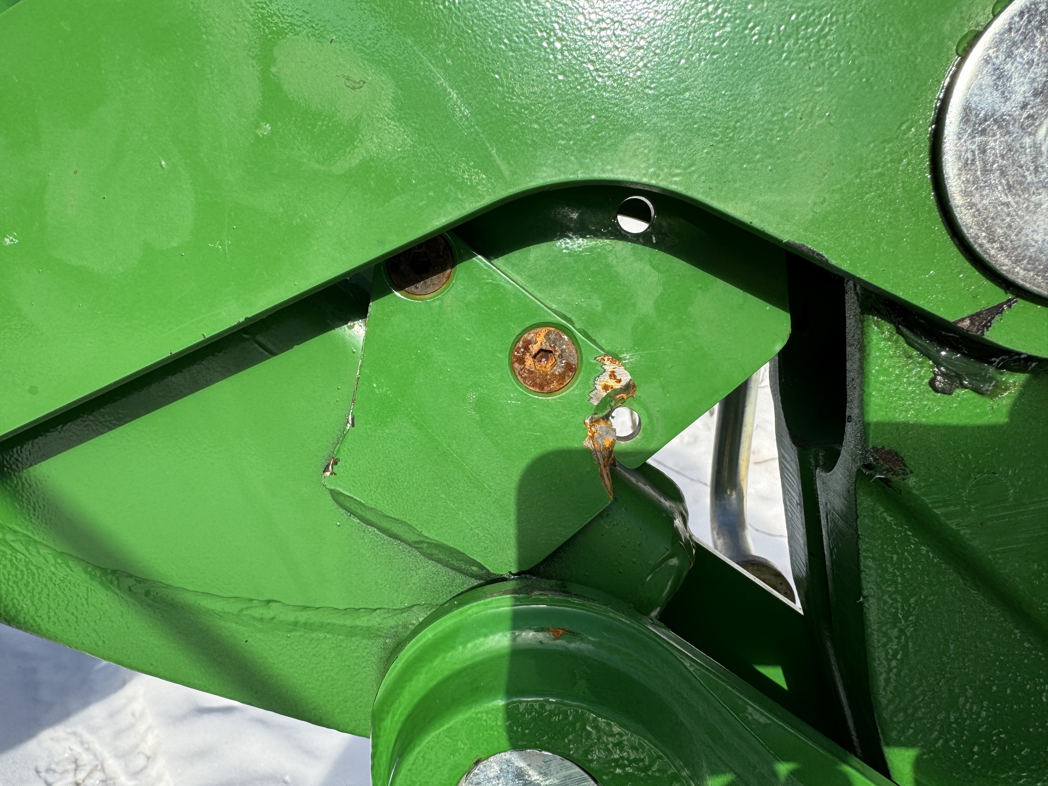

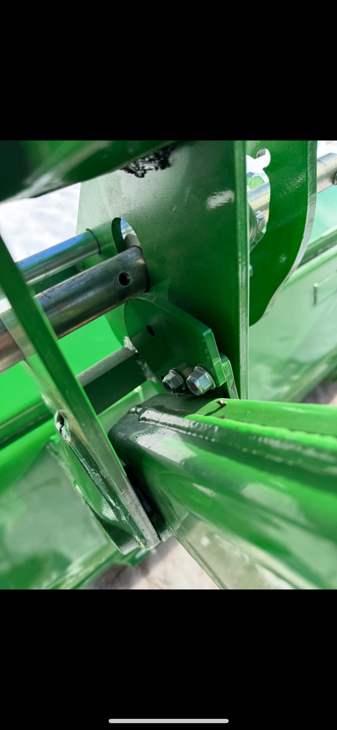

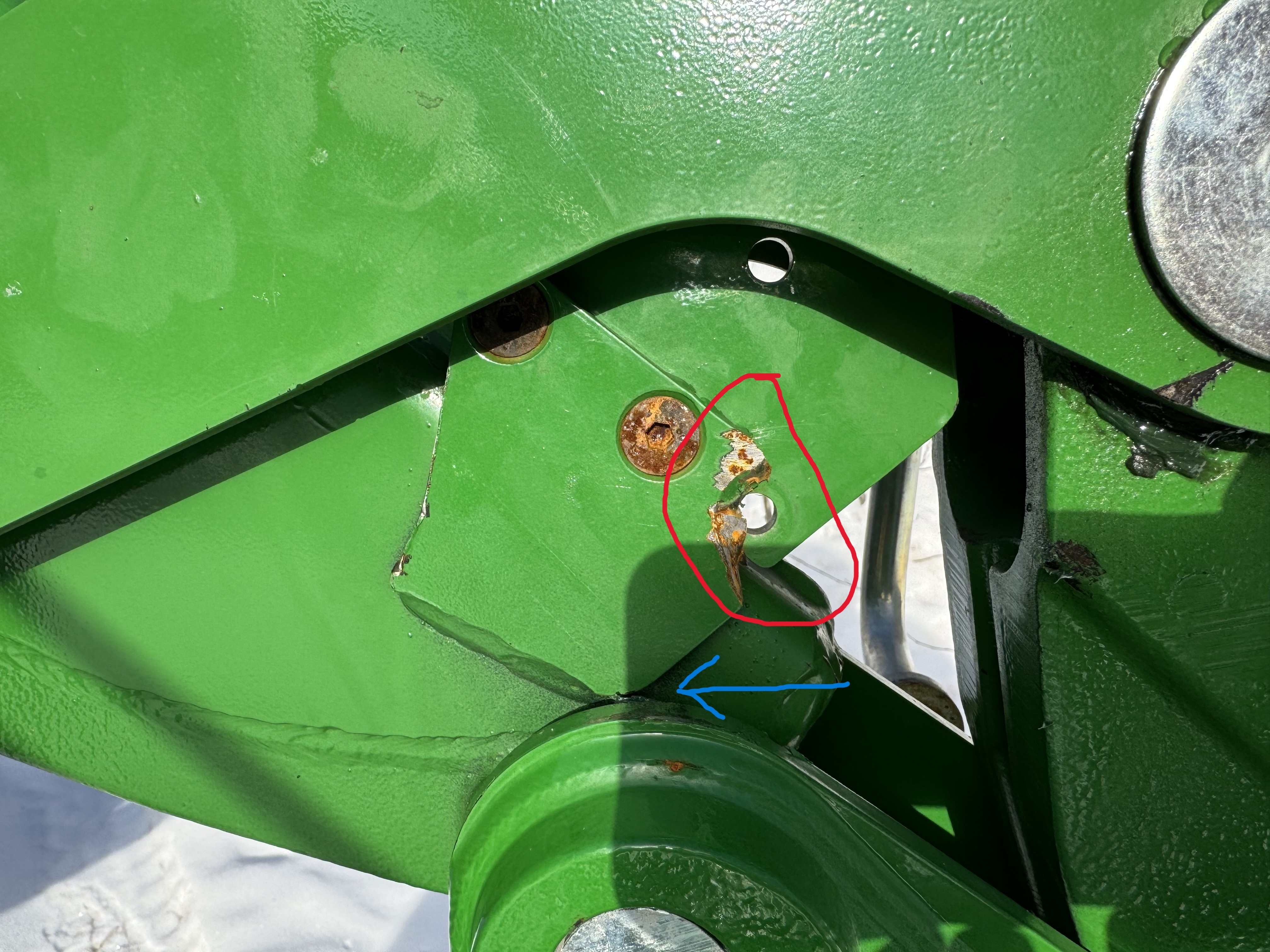

There is some damage going on. The welded plate got pushed back, which may explain why you have a gap. You can see the weld tearing in the bottom.
Then there is the weird stuff going on with that 3rd hole. The bolts also look awful rusty.
Is this a new tractor?

Yes it’s a new tractor. It’s back at the dealer for a list of other issues and I added this one to the list but I was hoping to better understand myself. I’m not a welder, can you tell me more about the tearing? I’m not sure I see what you’re seeing. Thanks.
   / Global / euro not automatically latching #23

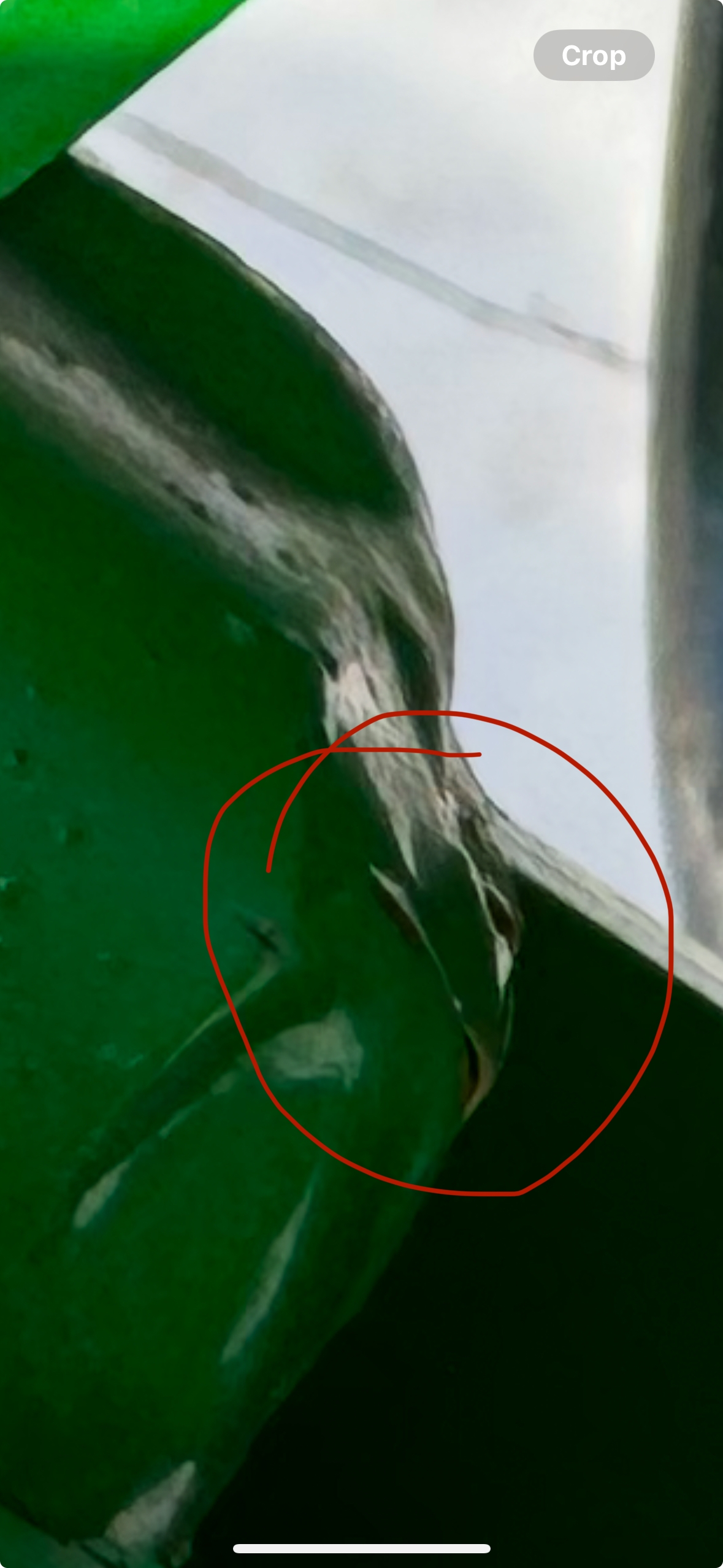

I added some markings on the picture. It should help.
In the blue arrow, you can see the weld tearing apart, cause by something that forced that plate backwards.
On the red circle, looks like there might be a chunk missing, that somehow got broken.
The broken part won't cause your issues I believe, but being a new tractor, I would expect to be in the right condition.
However, the welded plate being pushed back, means it can't trip the mechanism so it won't latch.

Thanks I see it now. And yes I agree and noticed earlier about the chunk missing. But I think that tear and push back is more of a problem than the chunk missing. I imagine they can grind and re-weld a mounting plate in the right position.

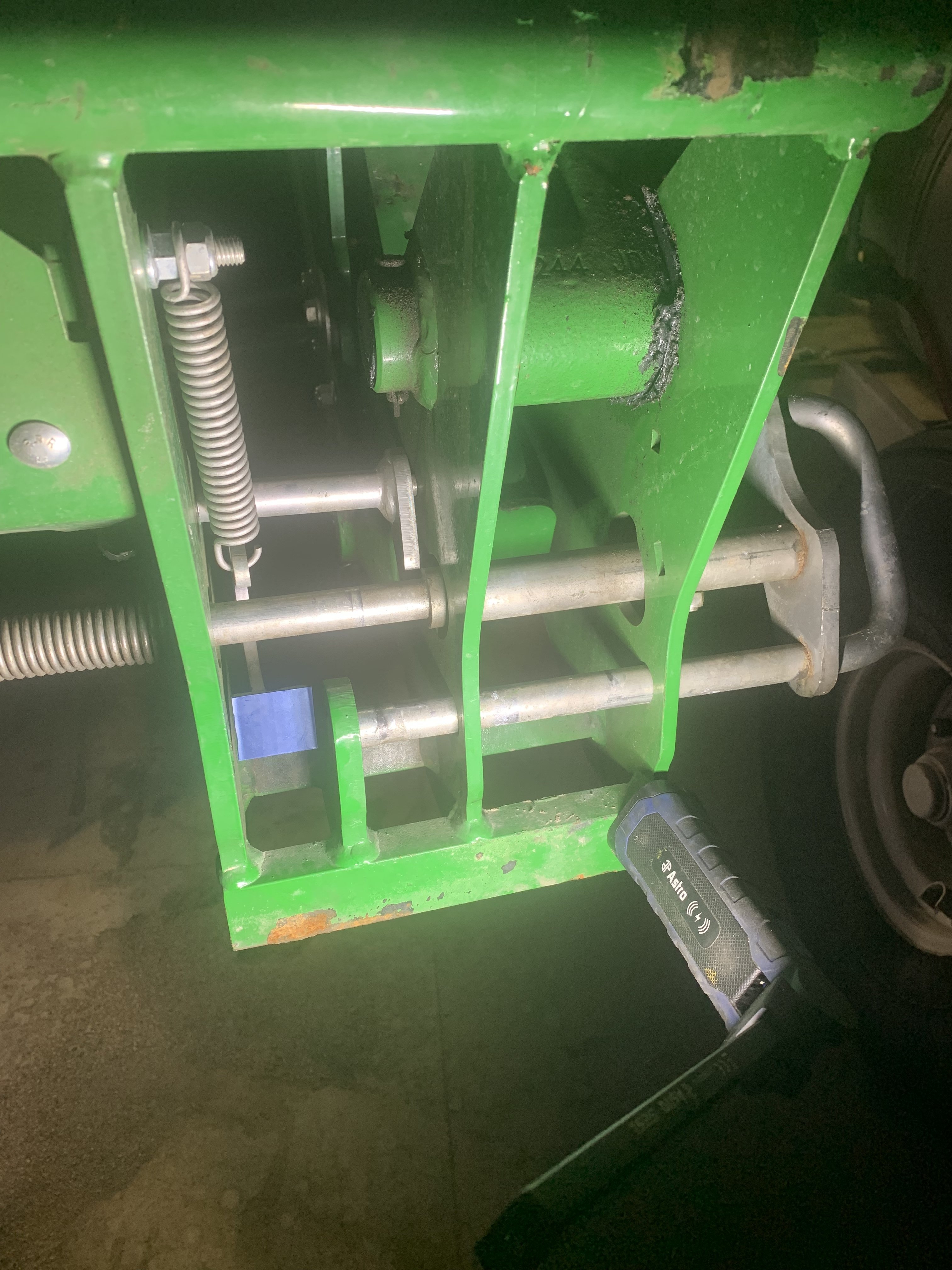

Separately, looking closer, are these gaps normal? More cosmetic than structural I imagine.

I see what you're saying but it's a bit hard to tell from that angle.

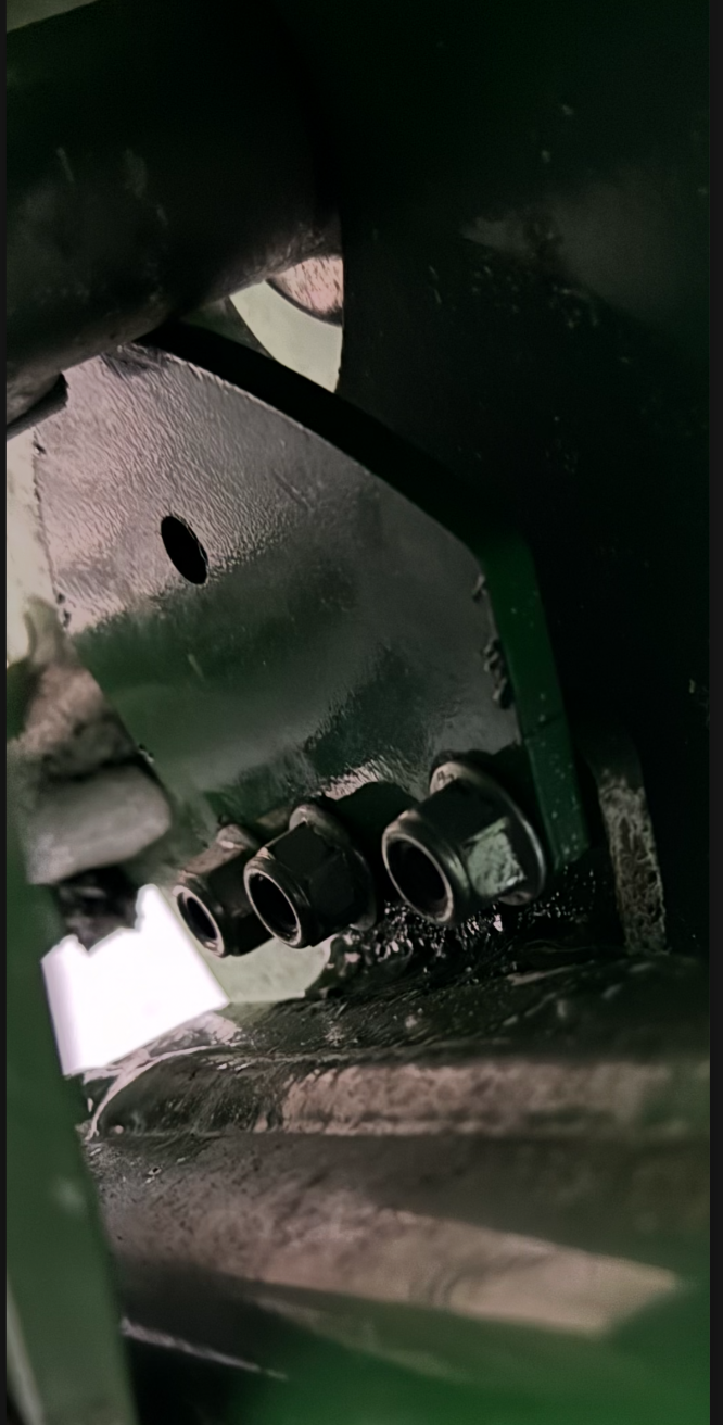

This one might help. Thanks again!

   / Global / euro not automatically latching #27
img_6038-jpeg.2099970
That actually appears to be a defective welding job. Automation at its finest. Makes a great-looking bead that isn't melted into both pieces-making them one.
   / Global / euro not automatically latching #28
Here’s what I think happened; If you’ll notice the bolts are one size too short for the nylock nuts to grab bolt threads and keep them from loosening, because of this that front bolt that’s missing unthreaded itself out enough that the framework of the carrier grabbed the bolt head when it was curled back....
When this happened it first pushed the welded plate back out of position then snapped the corner off at the bolt hole.
All this because the assembler didn’t bother to use long enough bolts 😆

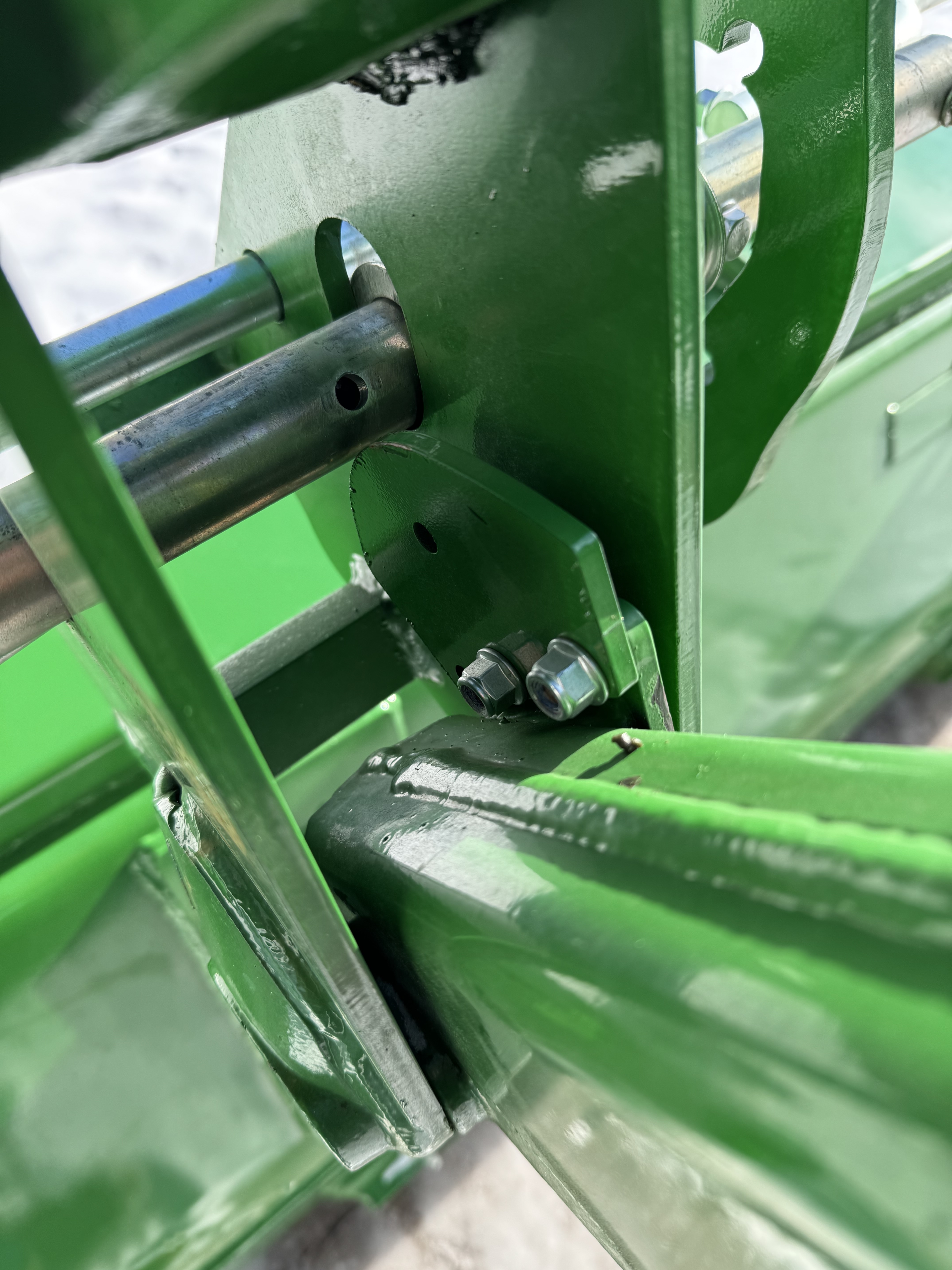

Little update. Took a close look at my 3 bolts securing trip plate . Same as OP’s too short to thread into nylock ring. Must be a Deere oversight. Original are 8x1.25 x20mm ,went to local hardware and got 25mm length, also applied a little blue locktite. For the tiny cost and time well worth doing to avoid Op’s Situation.

Quite certain these 5 series loaders are not made in China. I believe and somebody correct me if I’m wrong there assembled in Mexico. I will say they have a impressive build quality to them .
Scratching my head though why they’d use a bolt that’s one length too short to reach the nylon lock ring of the nut🤔.

Update: dealer replaced the welded mounting bracket and everything works as intended now. The spring pin will release when fully curled even without any attachments.
   / Global / euro not automatically latching #35
Good news, did they bother to use a bolt one size longer than the original so it actually goes thru the nylock lock ring on nut?

Nope, they used the Deere spec bolts. I wonder why they are so short?
   / Global / euro not automatically latching #37
So those bolts don't even start to touch the nylock part of the nut.

Evidently Deere isn’t aware there just a little too short to reach the nylon lock ring. Or 99% of the time they hold until your warranty expires 😁.
For less than $5 and about 5 minutes I’d certainly replace them with a 25mm length like I did in my previous post.
You’re Dealer did cover the repair under warranty this time I’m sure. Once that expires it only takes one to rattle loose and you’ll be back in same predicament.
