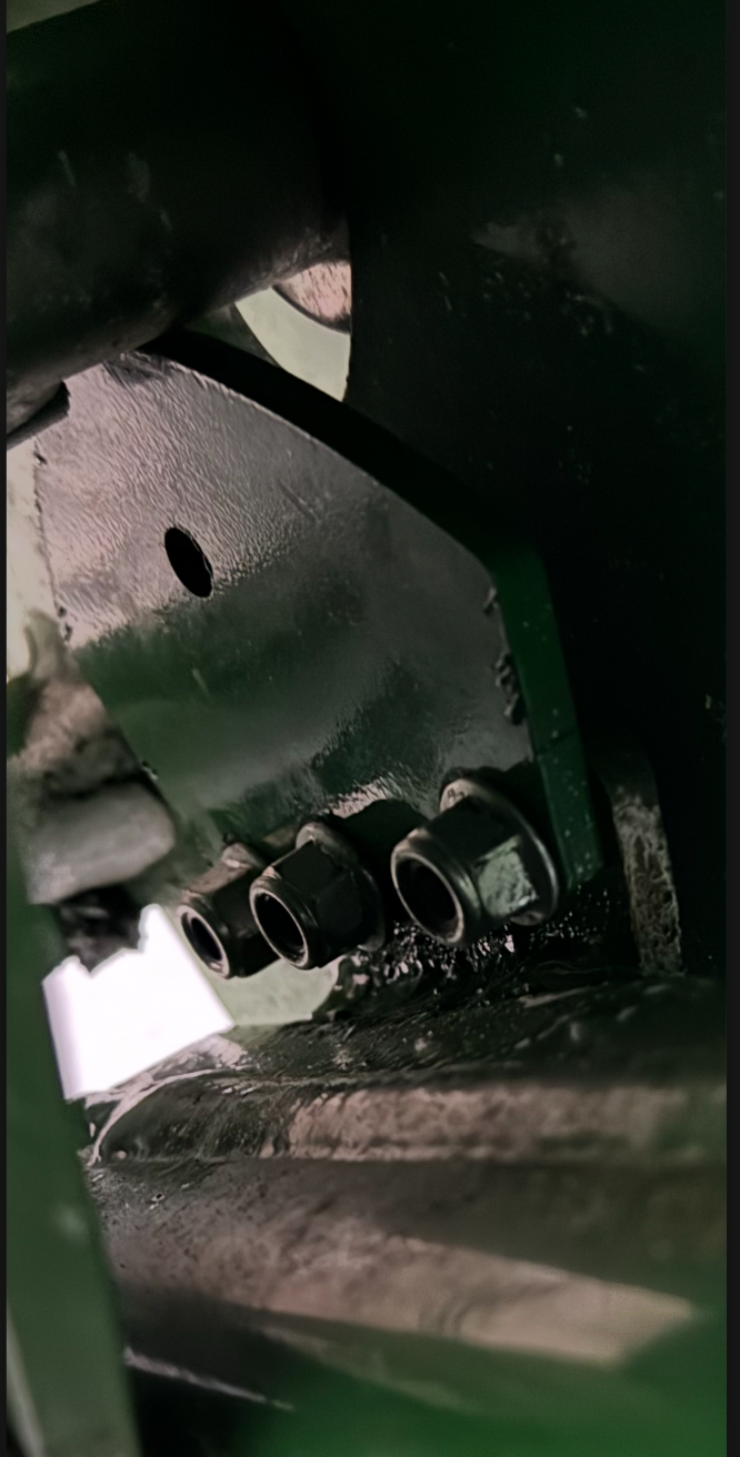

Quite certain these 5 series loaders are not made in China. I believe and somebody correct me if I’m wrong there assembled in Mexico. I will say they have a impressive build quality to them .
Scratching my head though why they’d use a bolt that’s one length too short to reach the nylon lock ring of the nut🤔.

I do agree the bolts are too short though.

Update: dealer replaced the welded mounting bracket and everything works as intended now. The spring pin will release when fully curled even without any attachments.

Good news, did they bother to use a bolt one size longer than the original so it actually goes thru the nylock lock ring on nut?

Nope, they used the Deere spec bolts. I wonder why they are so short?

So those bolts don't even start to touch the nylock part of the nut.

Evidently Deere isn’t aware there just a little too short to reach the nylon lock ring. Or 99% of the time they hold until your warranty expires 😁.
For less than $5 and about 5 minutes I’d certainly replace them with a 25mm length like I did in my previous post.
You’re Dealer did cover the repair under warranty this time I’m sure. Once that expires it only takes one to rattle loose and you’ll be back in same predicament.
