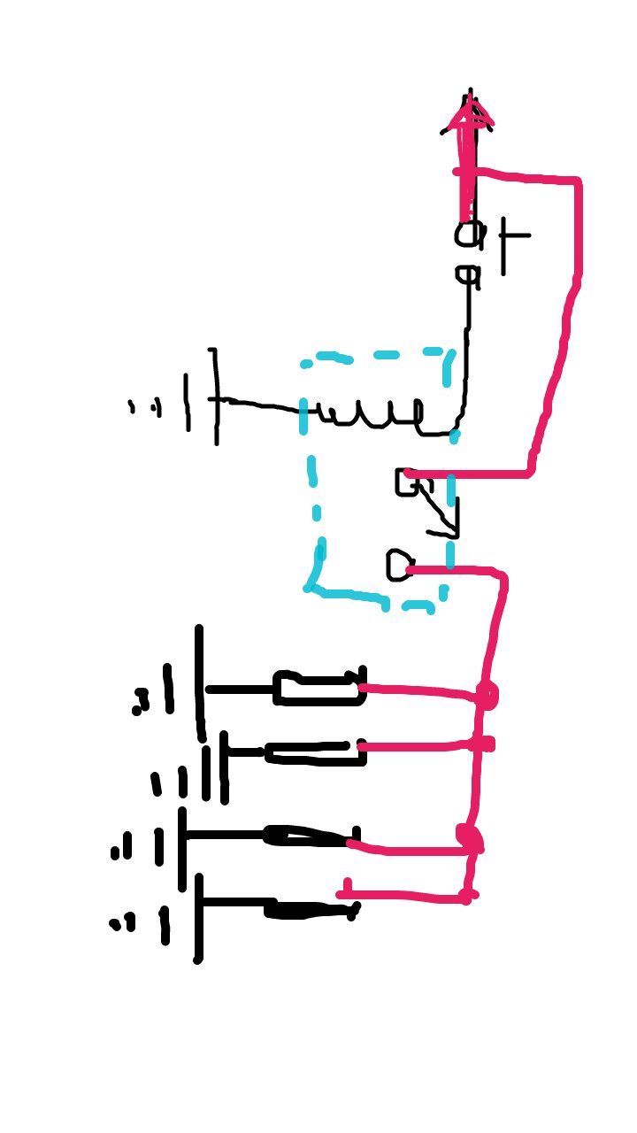

I'm fixing up an old Ford CL65 skid steer. Most all the non-essential wiring / gauges / switches were stripped out of this thing including the original ignition switch and the entire glow plug circuit (old owner just squirted a bit of starting fluid into the air filter whenever he wanted to go). From what I can tell from the schematic the ignition switch turns counter-clockwise to engage the glow plug circuit. When the indicator "glows red", you then turn the key clockwise and start the engine. The glow plugs are the pencil type wired in parallel. Here's an image of the ignition switch schematic and this mysterious "glow indicator": e7ZDYVwl.jpg . So here's some questions:
1. Whats happening inside the ignition switch with respect to terminals #19 & #17? (the extra wire off of #17 goes to the plugs). I'm thinking that in "pre-heat" mode terminals 30 and 19 are connected, but then what's #17 for?
2. I was going to bypass the indicator completely. I don't really see it as particularly useful, but it occurs to me that it may be providing some resistance and thus dropping the voltage down below 12V. Can I delete this indicator?
Just some additional info: There is no block mounted "block resistor" in this. The wire you see coming off terminal 17 goes directly to the plugs. They're all wired in parallel. I pulled them and they all seemed burnt, so I just ordered some NKG Y-107V plugs

You can wire directly with a HD switch (curent is high) and simply count off a few seconds and repeat if not successful.
(I knew one guy that simply had the 2 wires in his cab and simply held them between his fingers and counted)
Generally the plugs should be in parallel and grounding is via the engine block.(you will note all the plugs will be on one HD wire or buss strip)
Various timing mechanisms are generally incorporated to eliminate human error but the simple switch can do the job.
Just don't power up too long as U can burn out those glow plugs. Start off with, say 8-10 seconds and repeat if necessary or add a few more seconds next time.

Maybe call NKG who can tell you how long they can/should be on. I'm thinking your best bet would be to wire in that device DL posted, it looks like a high current glow plug light assembly made for them.
NKG can also tell you current draw.
A Ford site (V8 truck) said "all 8 draw about*190 amps, so figure each one would draw almost*25 amps."
So a 4 cylinder would be about 100 amps, so you would need a hefty switch and wire, although they're not on long.

A simple push button with relay to connect 12 volts to glow plugs would be simplest... If Autozone universal ignition switch is working why change it unless you are doing antique restoration.... Might consider putting glow lamp in circuit just in case its a inline resistor to drop voltage and it would also indicate GP's were getting power... Also agree it would be good to know what voltage/amperage requirements of PG's are...

A simple pushbutton and relay will work. You need a relay with 100 amp contacts and 1 gauge wire though. You could branch off to each plug with 8 gauge.
