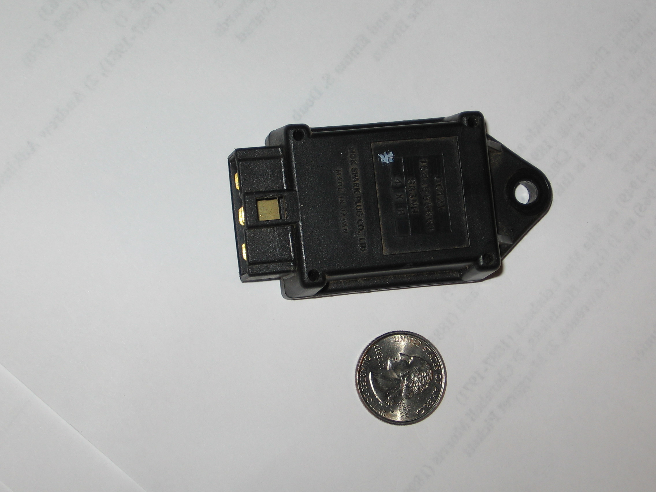

Can someone tell me which one out of the three units is the glow plug controller. I have read the threads on this subject and I also have the dash apart right now. All three units are on the right side and the previous owner replaced the relay on the front side and the way I understand it one of the two on the back side is the controller. If someone knows which unit is the controller I will try and replace it. I know one member used an aftermarket switch to manually power the glow plugs but unless he can send me a detailed how to I will stick with replacing the controller. The way I see it if the controller don't fix it I have three more possibilities glow plugs,engine temp sensor, timer. I just bought this tractor and will be purchasing the service and parts manual.

It just so happens i have the old glow plug controller from my l4200 dt sitting here on my desk. Mine was not on the firewall but on a metal brace that was close in location to the glow plug relay which was on the firewall. It is labeled NGK spark plug co. DC12V
164156661 S33NH
/ Glow plug controller-l3600gst #3
oops here is the pic

Thanks fellas, hopefully mine will say the same thing and look the same as that one (will have to look this weekend).

The controller was the problem on mine to. :thumbsup:
