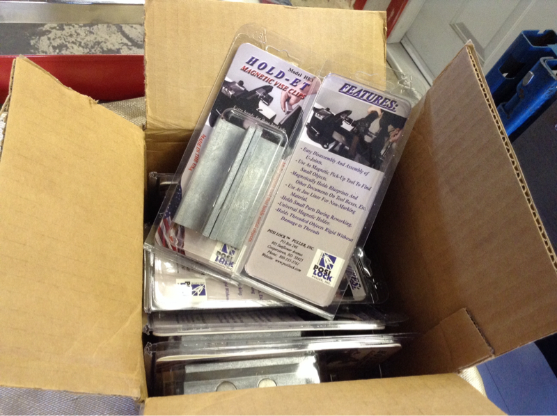

I just snapped a couple of pics of mine. image-781574844.jpg image-2821378051.jpg I used vice jaw protectors containing rare earth magnets. Terry

I suppose I should clarify that in my case the magnets were already embedded in the aluminum jaws and I only had to adhere aluminum to aluminum with the JBWeld.
