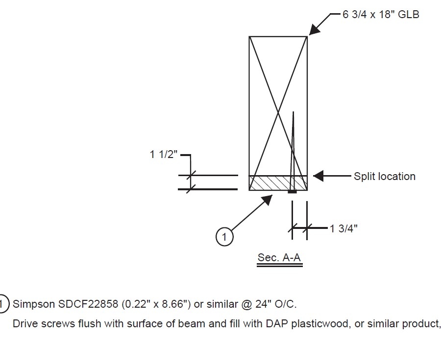

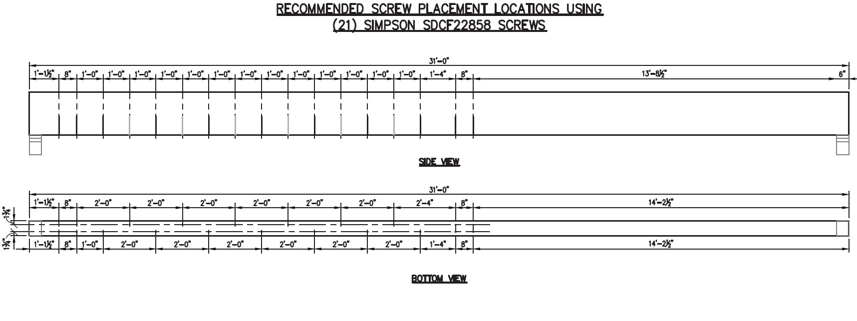

Is the engineering fix a proper fix? Or do some people here think it's not?
I think so. I personally would have tried to inject some adhesive in the crack and jacked the center before installing the screws, but that's just me.
Is the manufacturer sending someone, or do you have to do it?
/ Glulam Beam - Checking Problem #104
Yes, the glue isn't accounted for because they are "assuming" the glue is at least equal to if not stronger than the wood. Therefore they are treating it as if it were one solid beam....without glue.
And yes, proper glue should pull wood fibers apart before the glue separates
Got it. It's not as though they added a steel tension rod or something.

I tend to "overbuild" on my builds. Last house build I did, engineering said 2,500 psi on concrete floor but I went 3,500-4,000 psi. The same for walls and footings. I always will go bigger/stronger. I would rather spend a little more on structural and that way if something does happen, it's overbuilt to begin with so I have a margin of error. Like these beams, engineering oversized them by about 50% or so with the snow loads. So even if the beam lost 25% of its strength, I am still in the green zone.
I will fix it as recommended just to be safe and the fix is easy enough to do in a couple of hours. It will bring peace of mind.

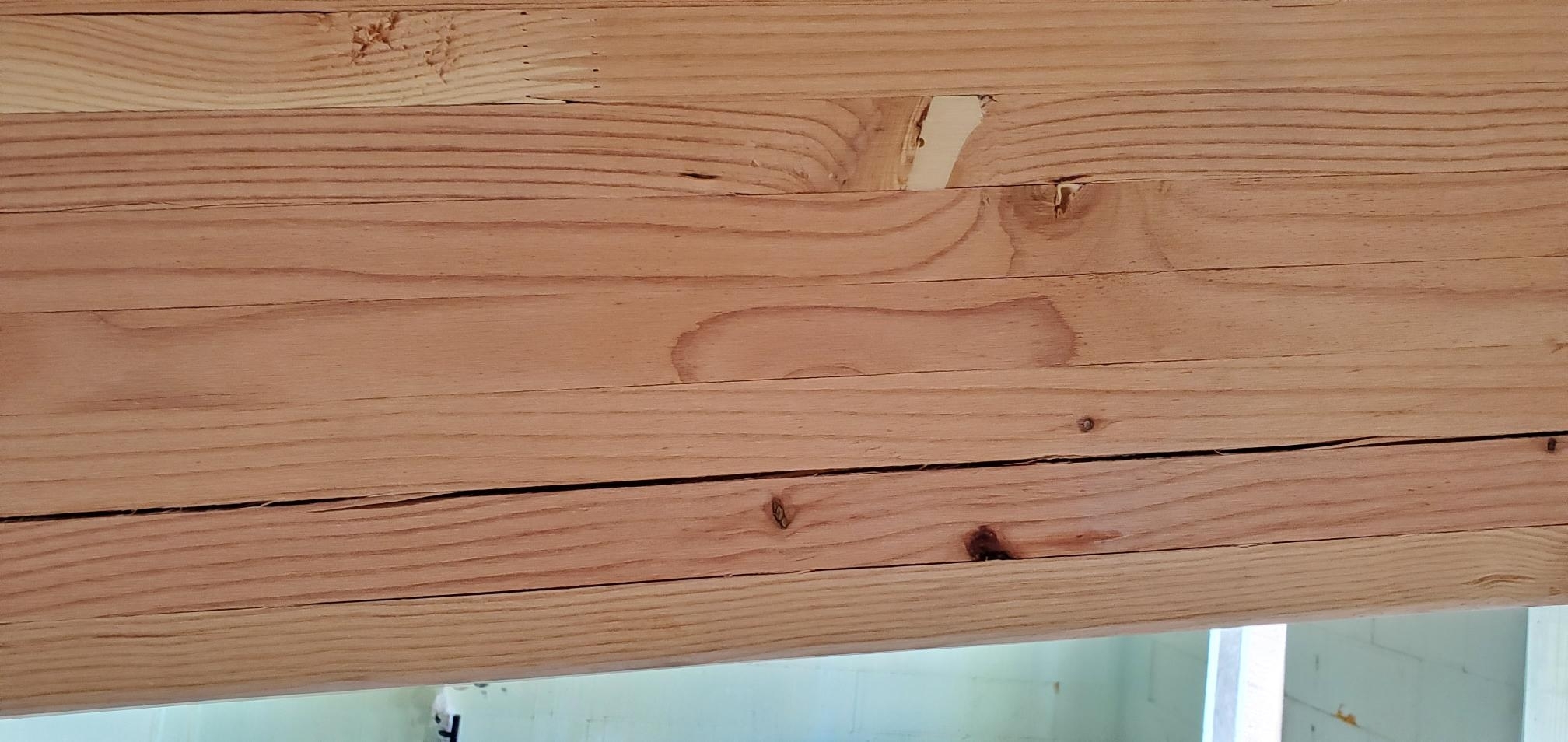

This may be only a small point. The OP's pictures show de-lamination not checking. Checking is when the crack goes thru/across a single board in the glu-lam. The picture shows separation of one board in the beam.
Glue injection - compression while the glue dries - some form of screw or bolt to help hold this section together.
/ Glulam Beam - Checking Problem #113
I was tempted to say "it looked like checking to me" but after looking again it does look like all of the alleged checking is on board boundaries, with some of the glue pulling wood from one side or the other making it look like checks.
That glulam looks really bad on second look. A beam's strength comes from the vertical aspect, and this basically cuts the bottom two boards off of it, and I'm not sure I'd take bets on the rest of it staying put either.
That glulam looks really bad on second look. A beam's strength comes from the vertical aspect, and this basically cuts the bottom two boards off of it, and I'm not sure I'd take bets on the rest of it staying put either.View attachment 817736
I agree, that's why I was suggesting epoxy plus compression, either with clamps or screws while it sets.
To be fair, arm chair quarterbacking from a thousand miles away, I think that the second board up has both delaminated from both the lower board, and the upper one, and it has also split/checked in several places. Whether it is full thickness or not seems to be unknown.

Note: Glulam beams are not like steel or concrete beams. The best material is used in the tension lams at the bottom for a simply supported beam. The junk is in the middle. Do not assume the loss of the bottom couple lams results in a linear reduction of strength. It is much more significant than that.
