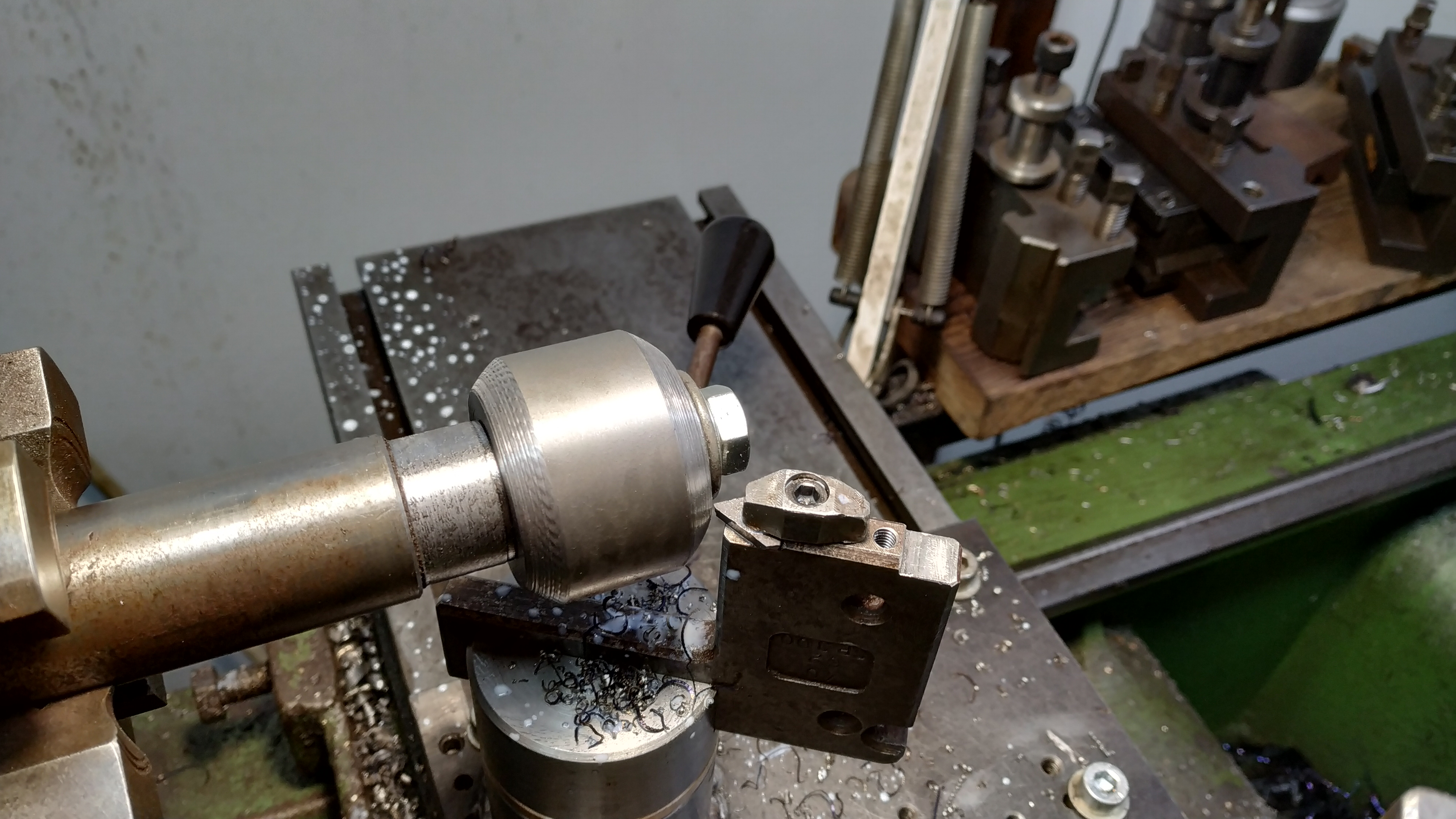

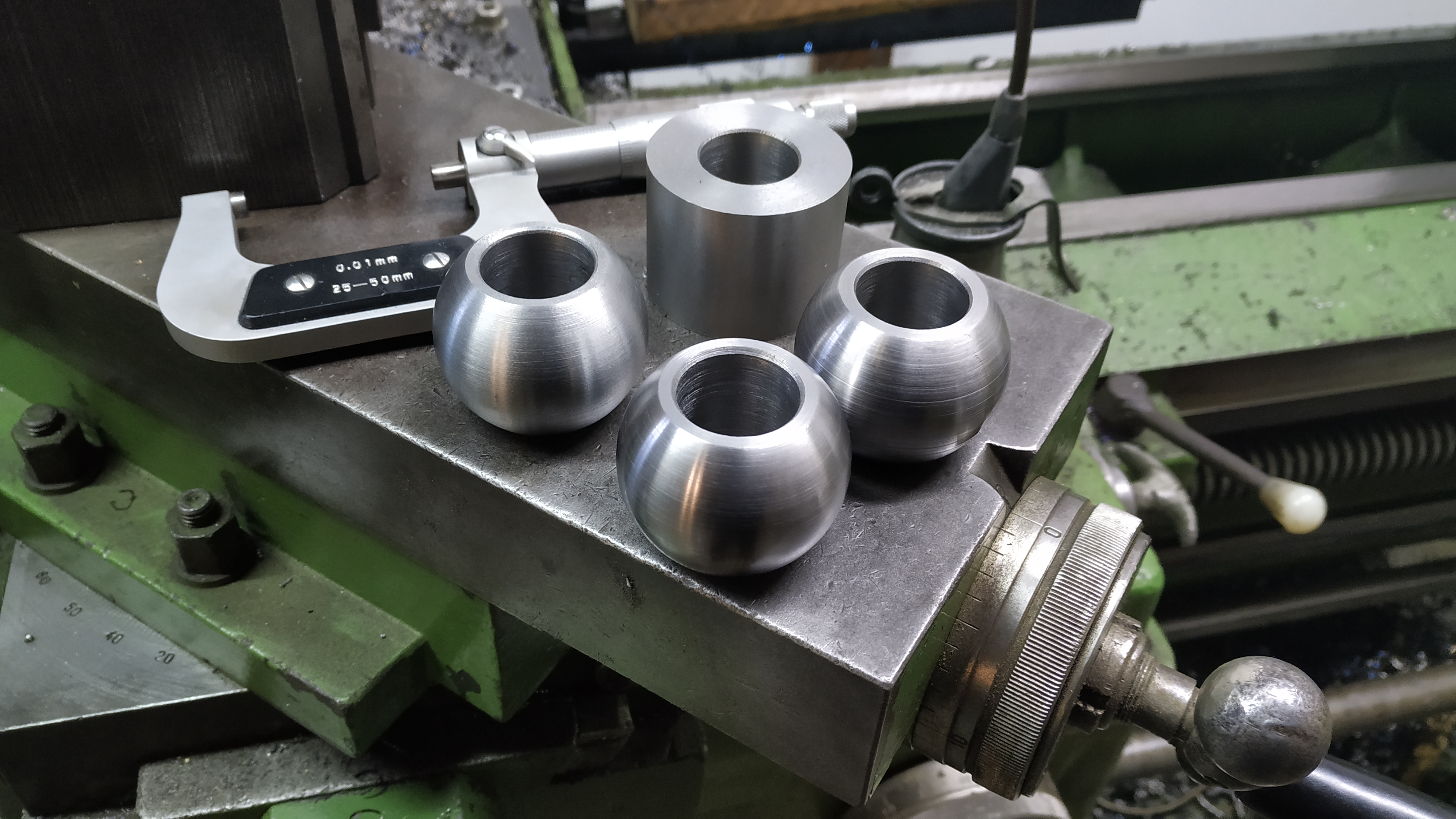

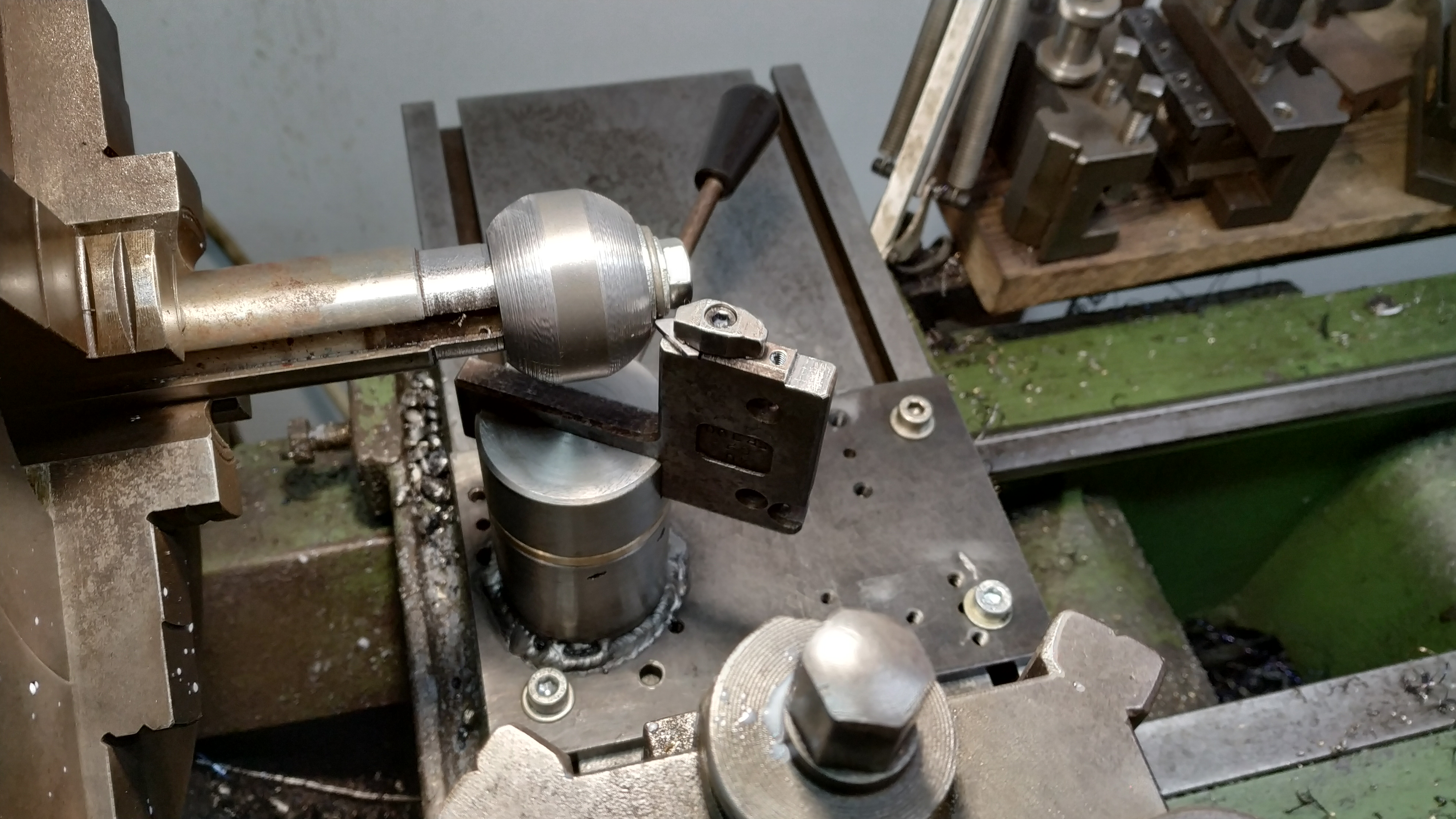

I can source those easily, but where is the fun in that? :) I have a lathe and I always wanted to build a ball turning attachment, so I just made 2 sets of balls.
View attachment 639961View attachment 639960View attachment 639959

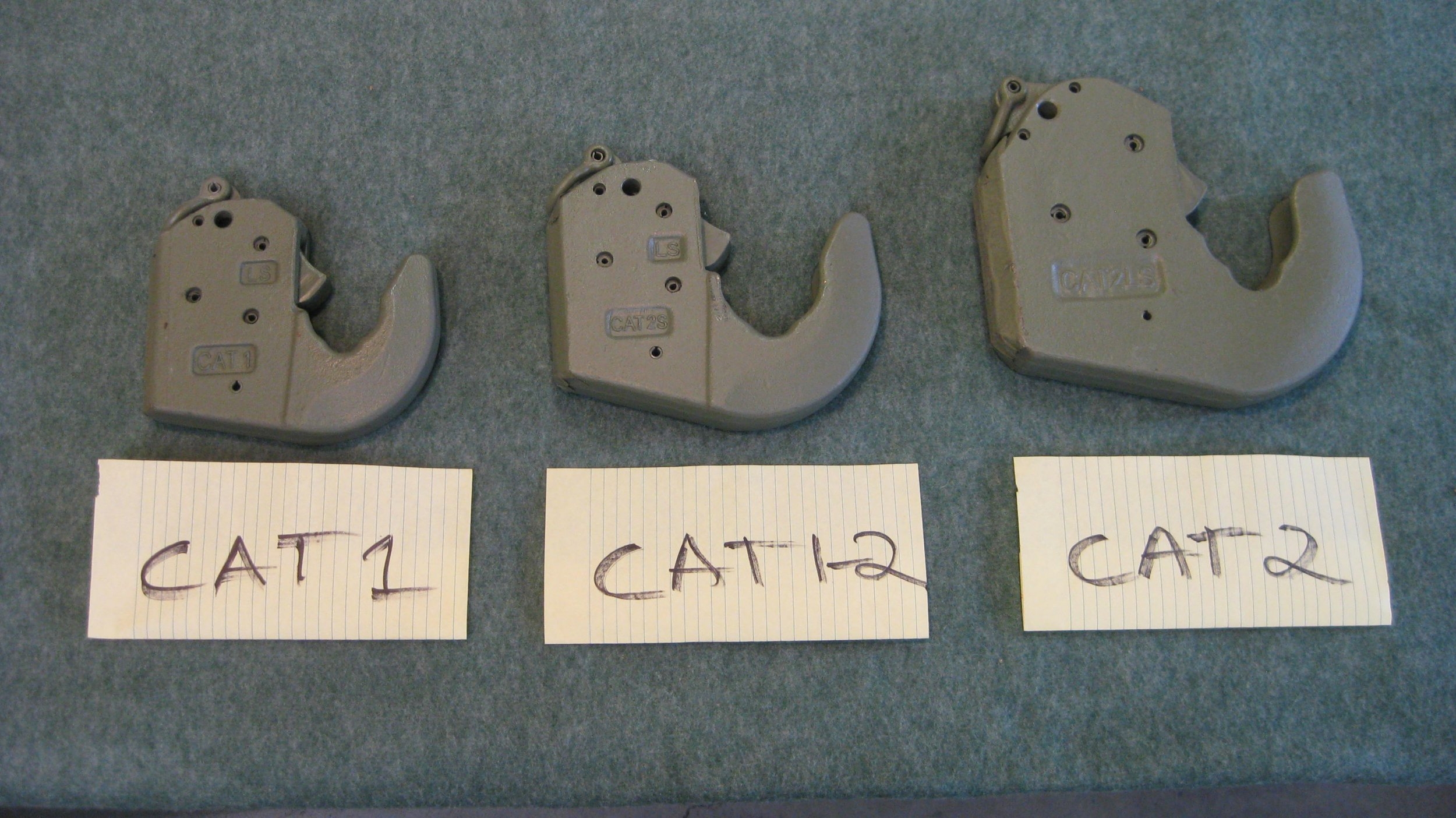

AMA has the 44mm balls, just no hooks to go with them. The cat 1-2 hooks take 56mm balls which they have with cat 1 & 2 pin hole sizes.
I guess that I should check on the availability of the cat 1 hooks. ;)

Well I can get the cat 1 hooks, even ordered a pair. Not positive on the cost. Guessing about the same as the cat 1-2 hooks. Should have them sometime in April.

I now have the true cat 1 hooks & ball sets available for those that might want them as well as the cat 1-2 & straight cat 2 sets.
