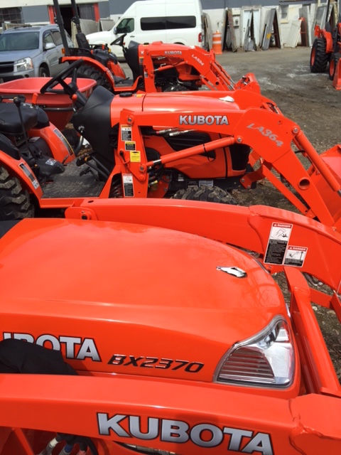

Stopped by the Kubota dealer today because I've been thinking about moving up from my Massey Ferguson GC2400. They happen to have a BX2370, B2620 and B3350 parked in a line, which was nice for comparing sizes. They had a B2650 in the shop which was just set up. Based on the specs, I likes the B2650, but boy is it big. I;m 6' tall, and if I think about the height of the hood, a BX comes to about my waist, the B2620 comes to about my belly button, and the B2650/3350 comes to nearly my chest. Looks like about a 36" diameter tire of them, so much bigger than I am used to... They just got a B2601 in at their other location, so I might try and take a look this weekend. Seems like most of the features on the B2650 are also available in the B2601.
Anyone disagree that I would look like an idiot driving a B2650 around my 1.5 acres mowing the lawn? For any other purpose, bigger is better, but mowing a residential lawn, not so much.
From near to far:BX2370, B2620, B3350
