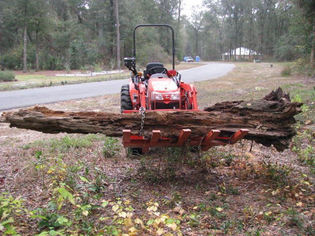

I put 400 hours on a B3300SU, which I believe was the predecessor to the B3350, in a Kubota tractor-loader package.
The B3300SU was a little less stable than I felt comfortable with for the long term. Light frame, zippy engine, narrow stance and tall tires made it a little tippy.
I sold it and bought a heavier L3560 tractor-loader. L3560 is very stable. Mine has R4/Industrial Tires. I drive on dry turf in 2-WD mode regularly and do not mark turf. L3560 tractor-loader weighs 5,400 pounds.
PHOTO: There is a Rollover Box Blade on the B3300SU 3-Pt. as counterbalance to the FEL load.
