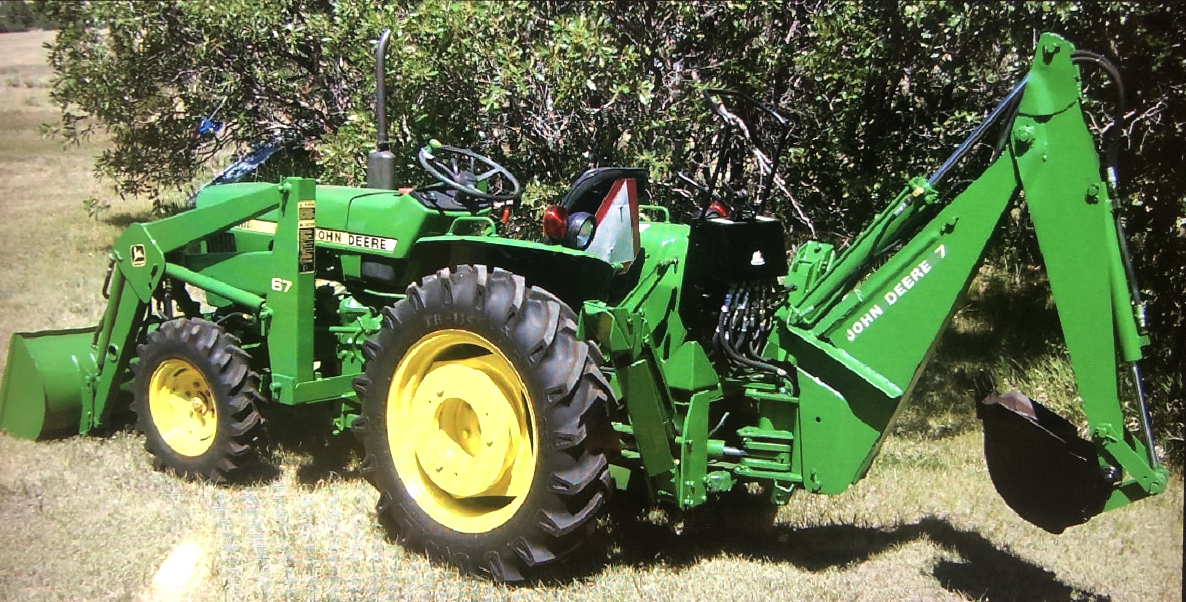

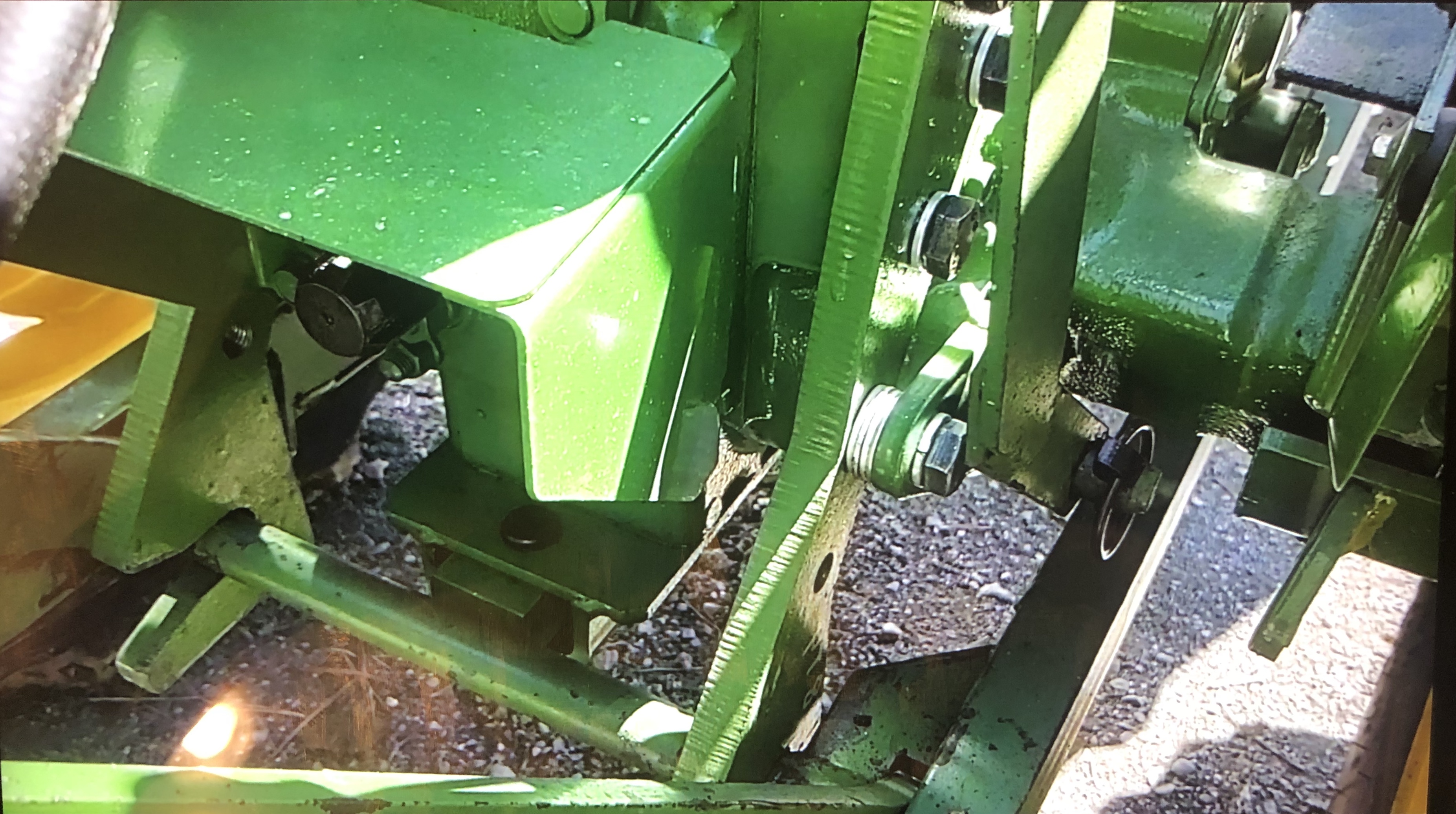

I too have a 750 and actually just purchased a #7 backhoe for it this week. The one I purchased came off of a 955 as well, as far as I can tell the subframe may have to be shortened by about 2” but won’t know for sure until I have the rear brackets on. The front brackets that came off the 955 were bolted on with two u-bolts, I think with a little modifying they can be welded on and work just fine. The rear brackets are being the problem for me, they are completely different than the ones that fit the 750. I haven’t been able to find any specs on the brackets, JD stopped making them in 2000 and really can’t tell me anything about them. If I could find a spec sheet on the brackets with all the measurements I’m sure a friend of mind could make them on his CNC machine. Let me know if you find any specs on them. Thanks

This one is really from a x55 for sure. The subframe is like the other ones I have seen for x55 tractors as opposed to the original poster.

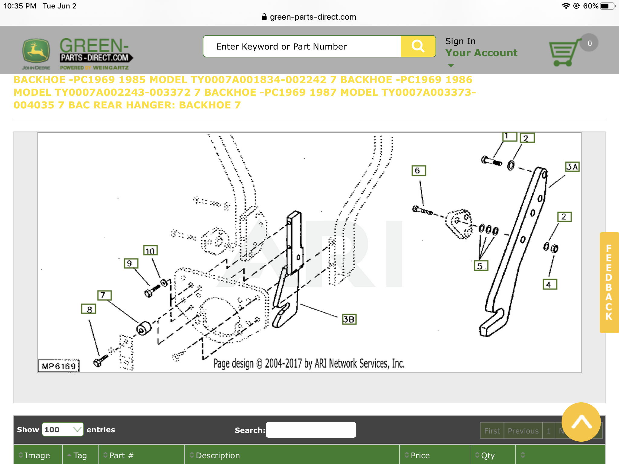

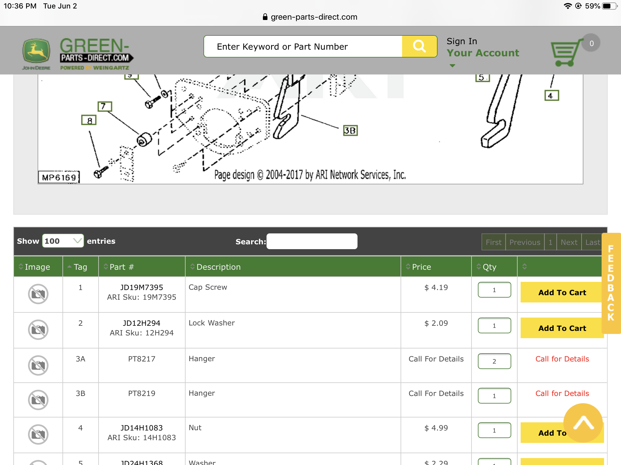

Go to the jdparts site and for the model #7 you can look at the hangers spec'd for the 750 as well as those spec'd for the 955. Gives you a chance to compare the parts for fab'ing your own.
John Deere Parts Catalog
When you pick the model of your tractor on their site it dont refresh to the picture you need. Or dont show a picture at all. Pretty much useless.

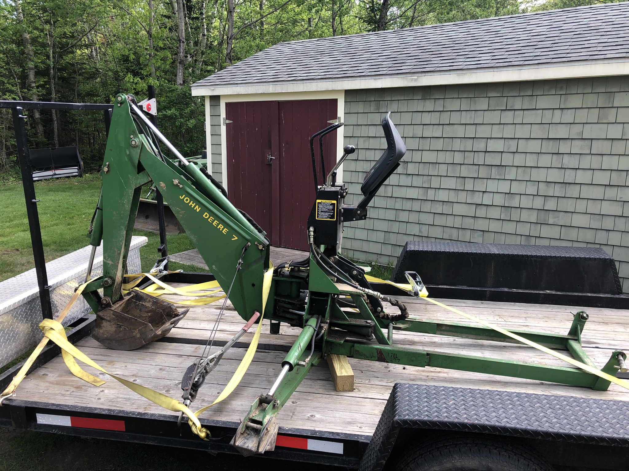

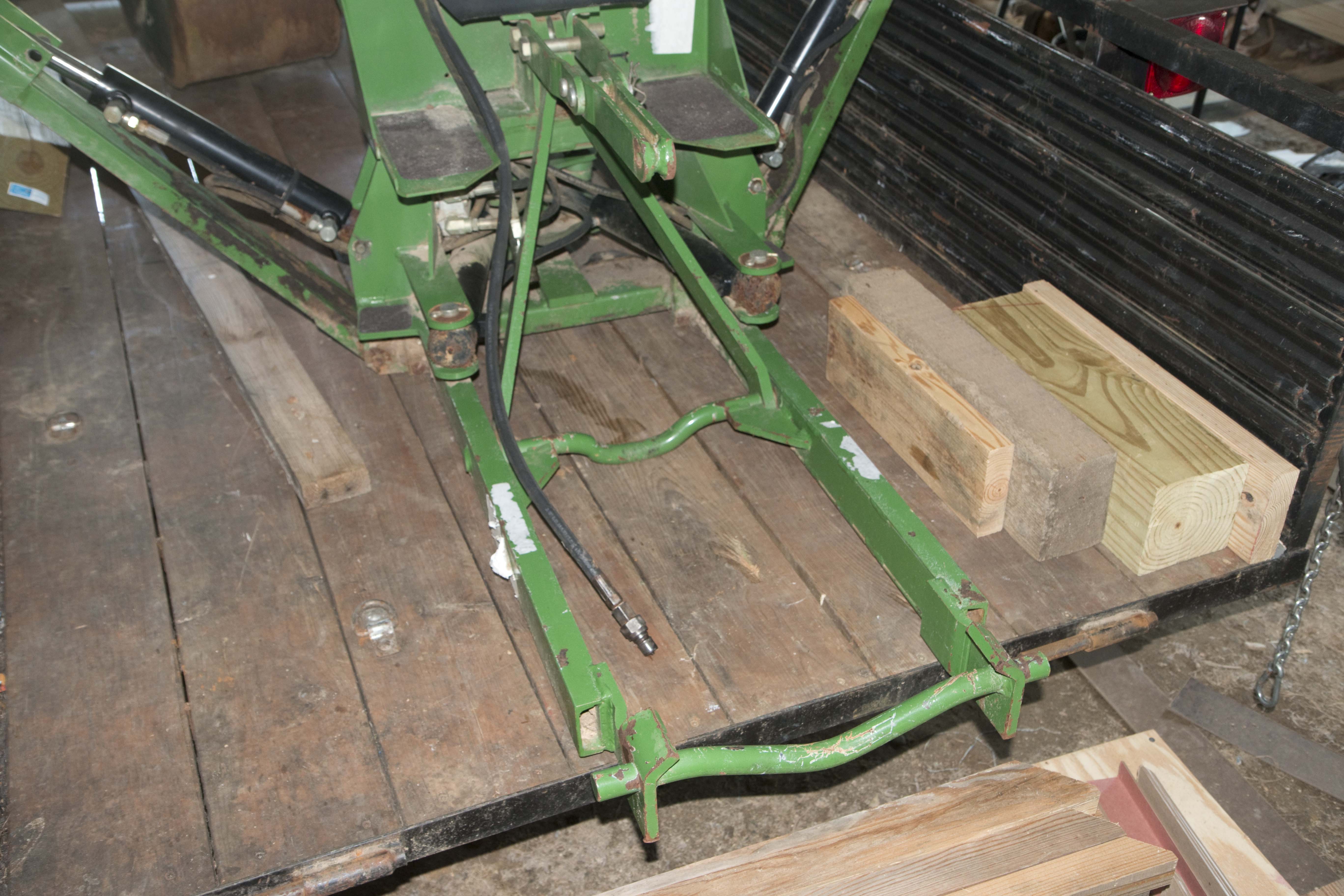

I got it home yesterday, 12 hours round trip.
Here is another pic of my subframe.

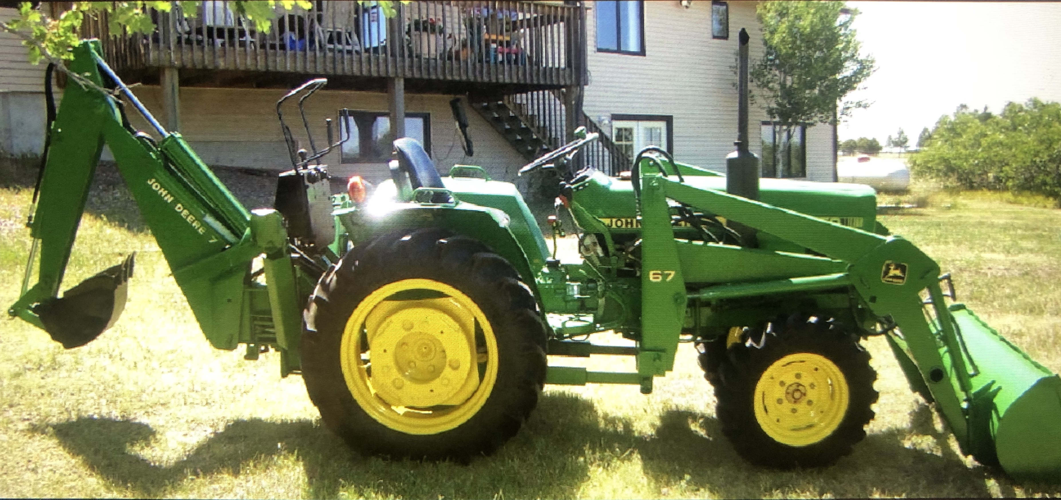

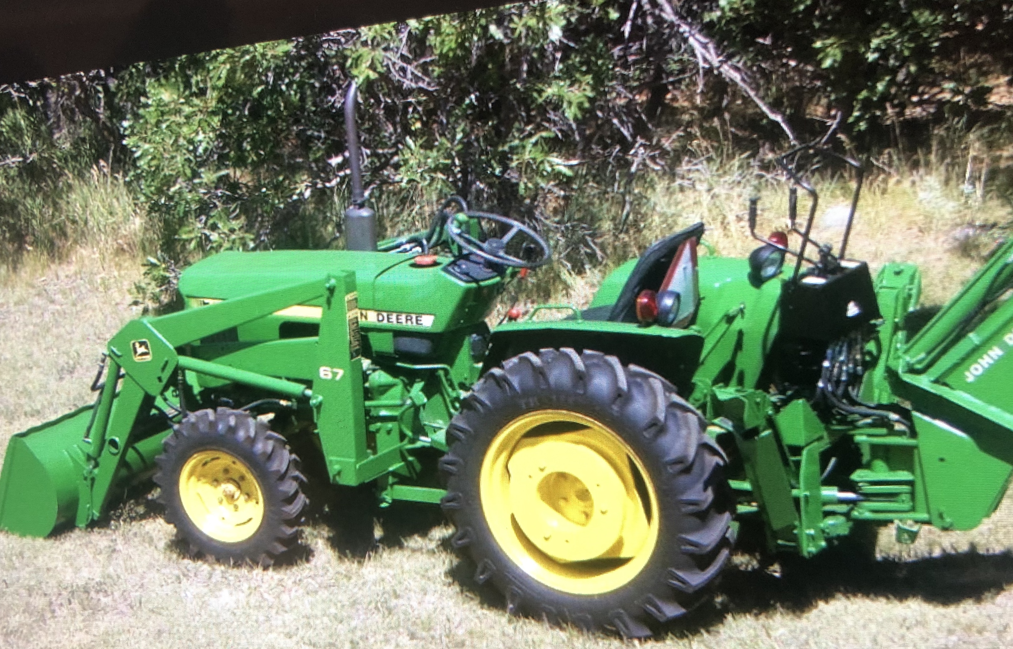

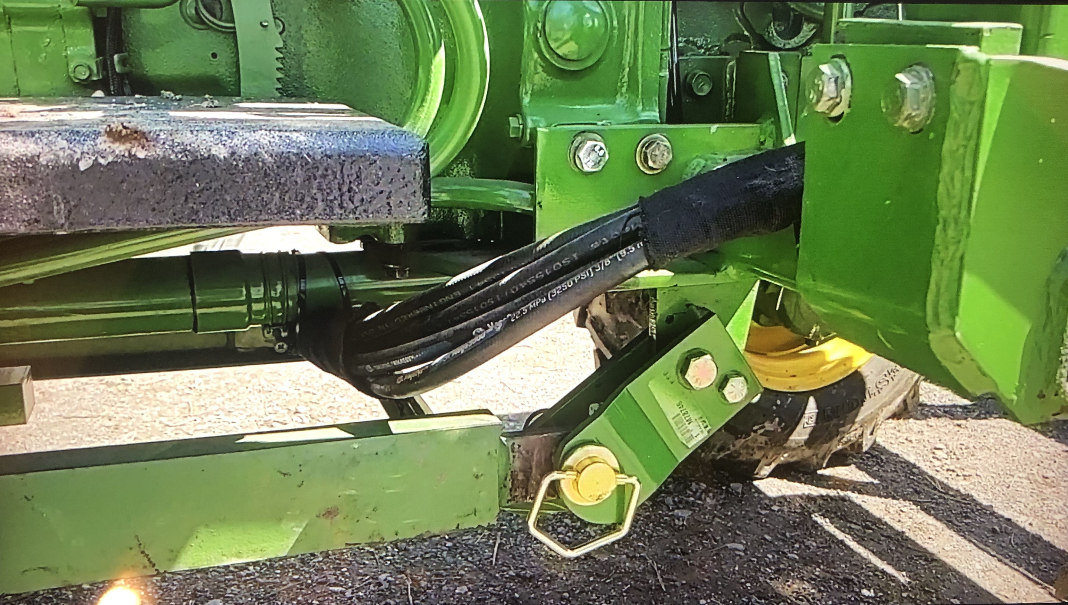

Thanks for the link. Your subframe definitely doesn’t look like the one I took off of the 955 but I’m sure you can modify it to make it work. Here are a few pics I found online when I was researching it.
86B4EC2B-4885-473F-BA66-C5AAB88C8E82.jpeg4643B28F-0C2F-4AC6-A6D9-CE69662A551B.jpegFAFD7ED8-6C82-45EF-8729-8E63B81B0987.jpeg494FF518-2A06-4453-86CA-69D39C9FE613.jpeg8866CEF7-5B3A-4212-95FC-3002AF216129.jpeg
