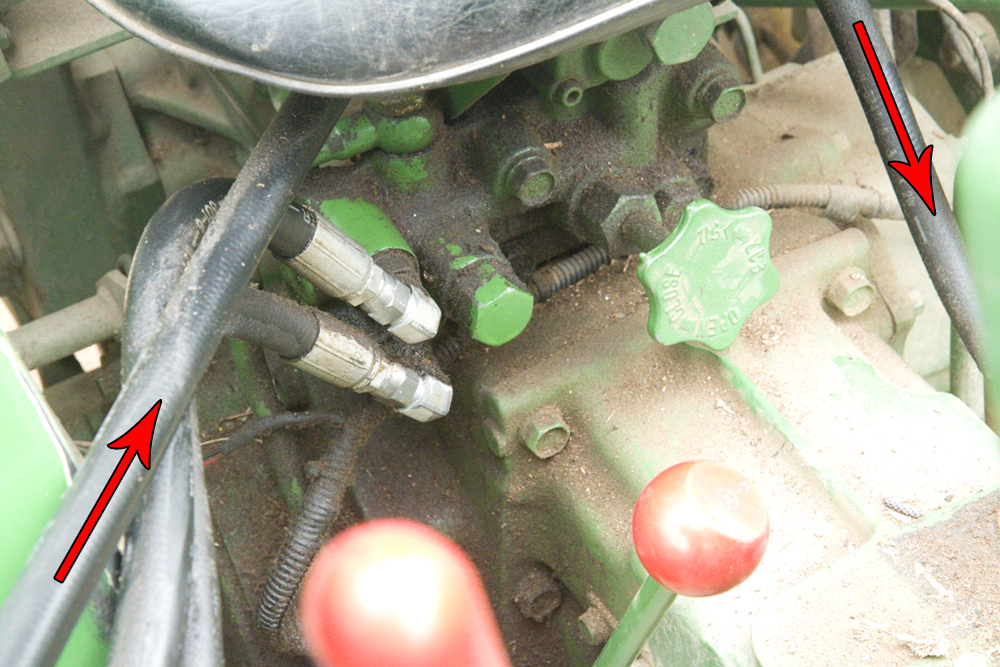

Well I finally jury rigged enough hydraulic hoses and fittings to finally see the hoe move a small amount.
But I had to unhook my loader.
Remember back in post #24 the pic I posted on how the bucket is connected? So I guess both of the top hoses has pressure. This Bush Hog loader has 3 hoses. 1 Pressure, 2 Power Beyond and 3 back to tank.
I assume the top hose in pic is pressure? the next one under it is power beyond.
Anyway I blocked the top outlet, connected the lower one to the hoe and it seems to work.
Now here is the weird thing. Back when my dad and I was hooking up the loader we couldn't get it to work, and somewhere before the internet I found some info where we had to remove a plug or install one inside one of the 2 outputs. Guess I can look tomorrow and figure it out.
And there is a learning curve figuring out hydraulic threads and fittings.

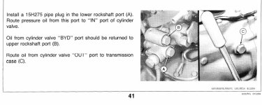

Ok, I found this. There is a plug in there so the loader will work.

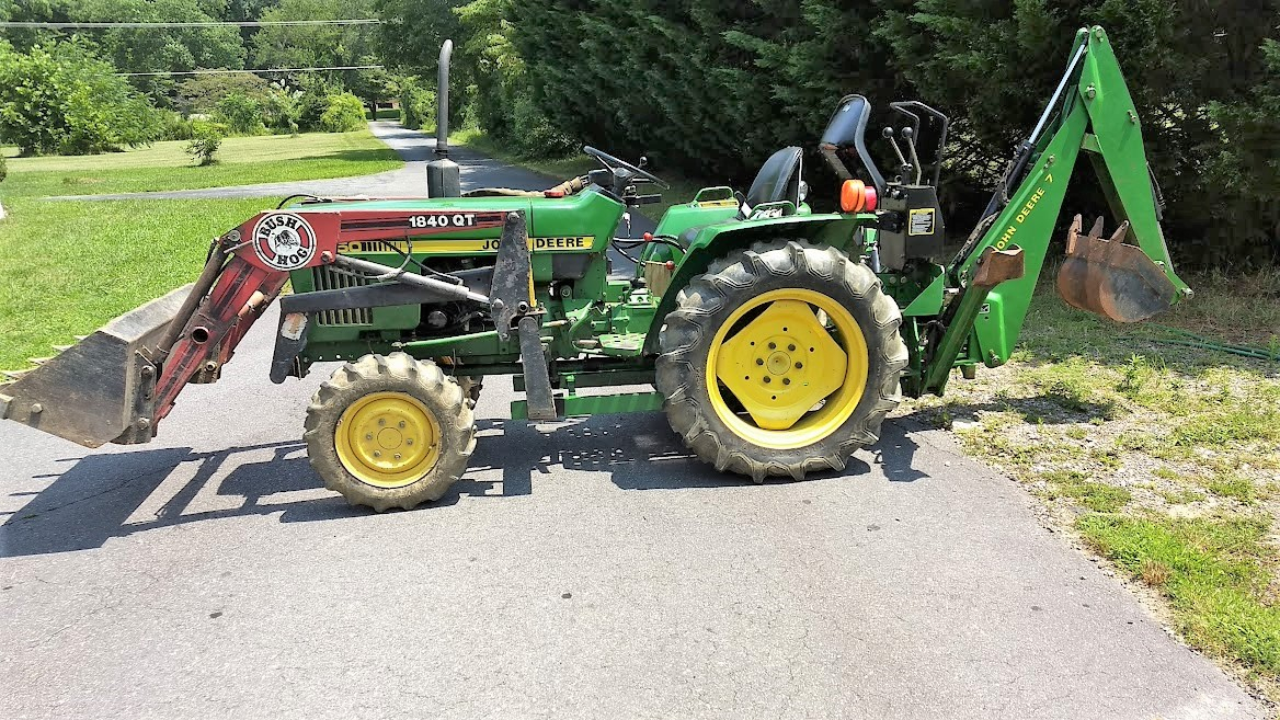

Well 14 months later its actually bolted to the 750. All that is left is a few bolts in fenders and put new seals in the stabilizer cylinders.

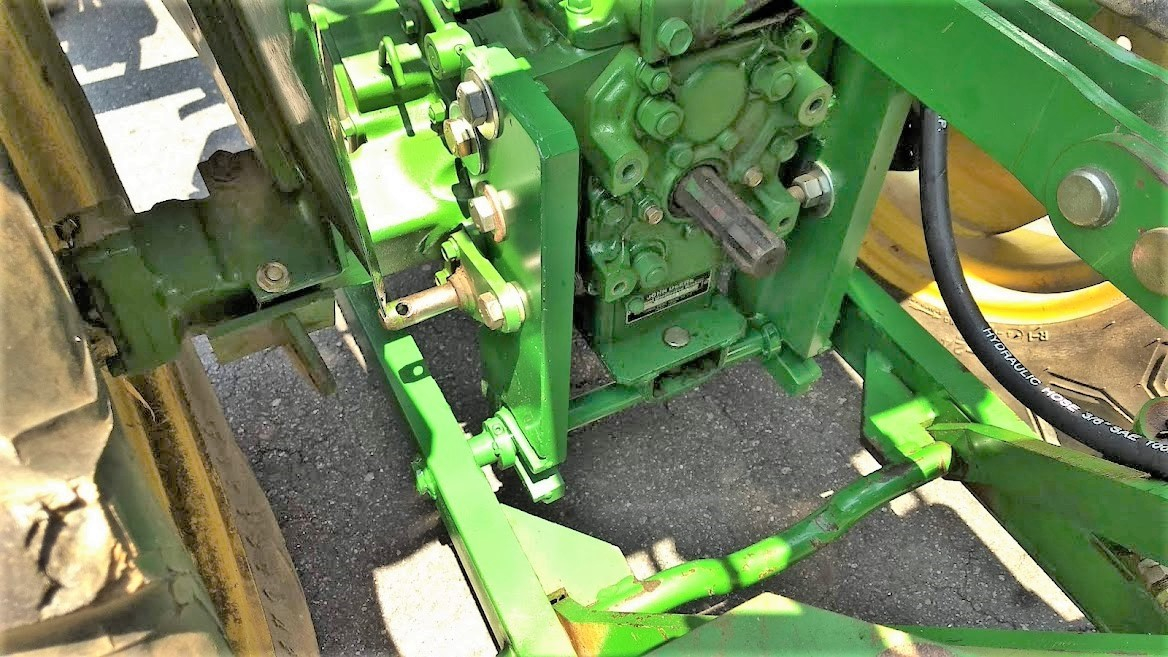

I made my own front and rear hangers and modified the lower frame.

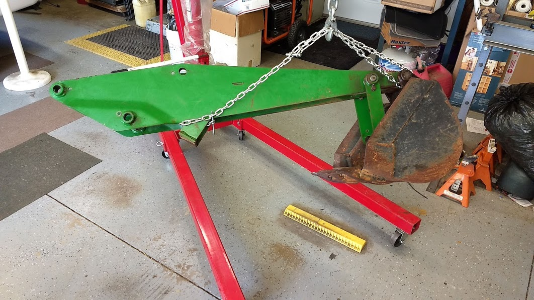

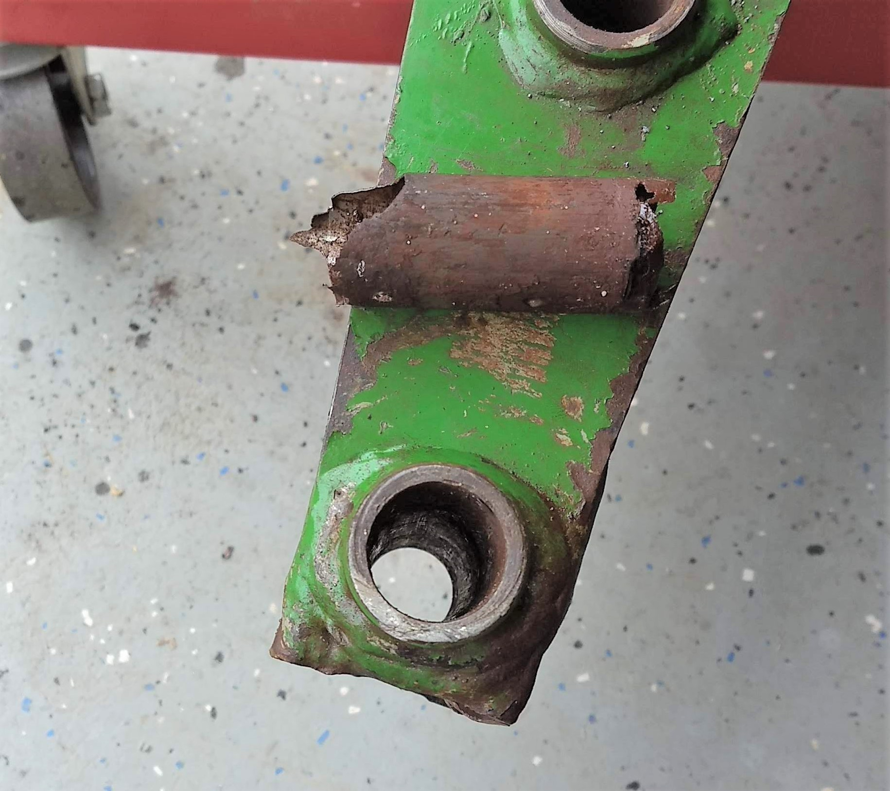

I ran into a big problem with 2 of the hinge pins in the bucket, they were completely frozen in place. 20 ton press couldn't do anything so I had to bore out each pin from each side as deep as I could go with drills and boring bar. What a nightmare. Case hardened pins. 4 days it took to get them out even with a 1/16" cutoff wheel on grinder.
I replaced 24 grease fittings. I dont think the dip s*^ts had EVER greased the pins.
