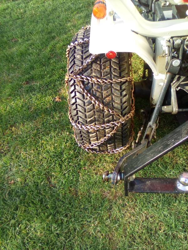

My little bolens/iseki came with 4 link ladder chains. They help some and make the ride pretty rough with the 3 point blower on. My Dad found an old set of chains that are similar length, but for a narrower tire. I'd hoped to make these into 2 link ladder chains, but I think I'm going to try adding the shorter cross chains in at a diagonal on the 4 link chains. Hopefully it smooths the ride and adds some grip.
Anything I should be cautious of ? Clearance shouldn't be an issue.

Sorry, yes I'm planning on going from cross chain to cross chain. Eveything looks like it should lay flat enough and not be twisted. If it doesn't work I guess I'm only out for my time and can put the old set back as it was. The more aggressive chains are out of budget for now.

Well, I got them cobbed together and onto the tractor today. They're somewhat smoother riding, but still not what I hoped for. I think I will look into making them into an H pattern or regular 2 link ladders in the spring unless the traction over the winter impresses me.

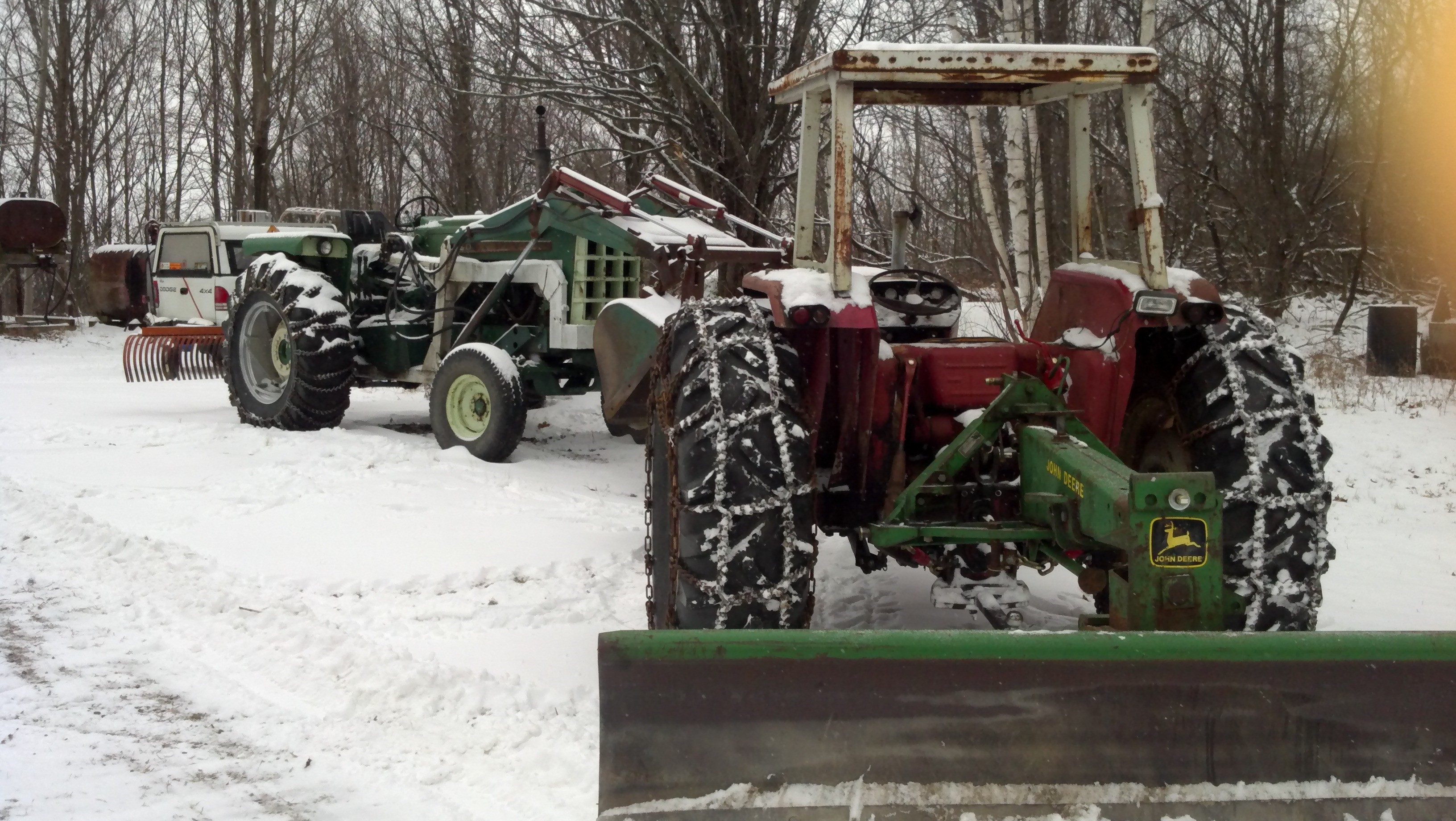

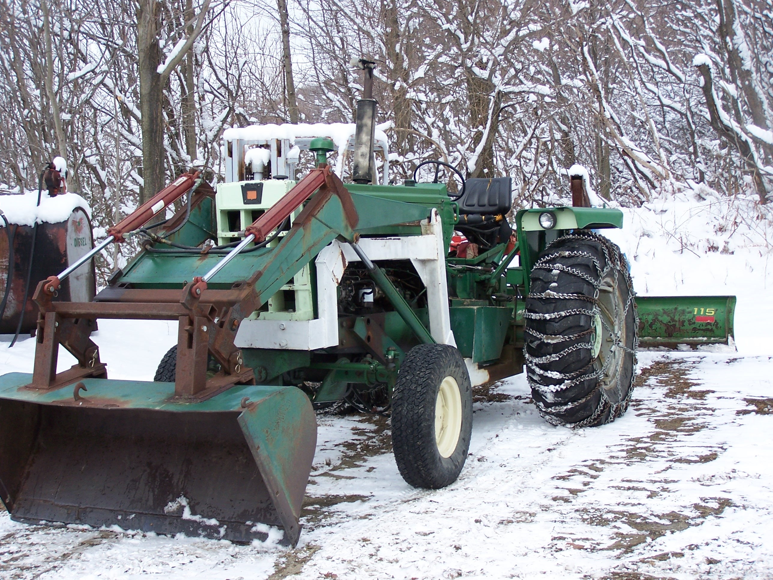

I ran 2 link spaced chains on a tractor for several years,
they worked better then standard 4 link spaced but that was all.
the Oliver has 2 link spaced and the IH 574 has a set of the Euro style studded,
the Euro style studded work several times better then the 2 link and have a good ride.
The standard 4 link spaced and the 2 link space and the H patterned or Duo chains all rode rough,
and had a spin slip and grab traction on my steep hill.
The studded Euro design is the only chain I have used that didn't have a slip and grab traction jump,
and many times required tire speed to chew for traction.

I did get a picture today. I figured out I was missing a piece. The ride is better now, I haven't had a chance to check if they grip better in the dirt, or on the driveway. Hopefully I get a couple nice days next weekend not doing car maintenance to play in the dirt.IMG_20201129_143139.jpeg

So I got to try out the chains in a spot I usually slip quite a bit. I usually plow the lawn's leaf pile into a small gully so they can compost. I normally need the diff lock to back from the edge, even with the chains in their old ladder config. Today, no problems, so it appears to help in that spot. I did figure out some of the roughness to the rider I missed the last diagonal where the chains link back together.
Got that in and I'm pretty content.

So the first serious snow of the year and they worked fine. Nothing loosened up and the grip was far better. Not even a hang up going around the long to make a path for the dog. I think having the weight one the angled links helps keep the traction consistent. I may get longer chain in the spring so the link can tie in at the sides.
