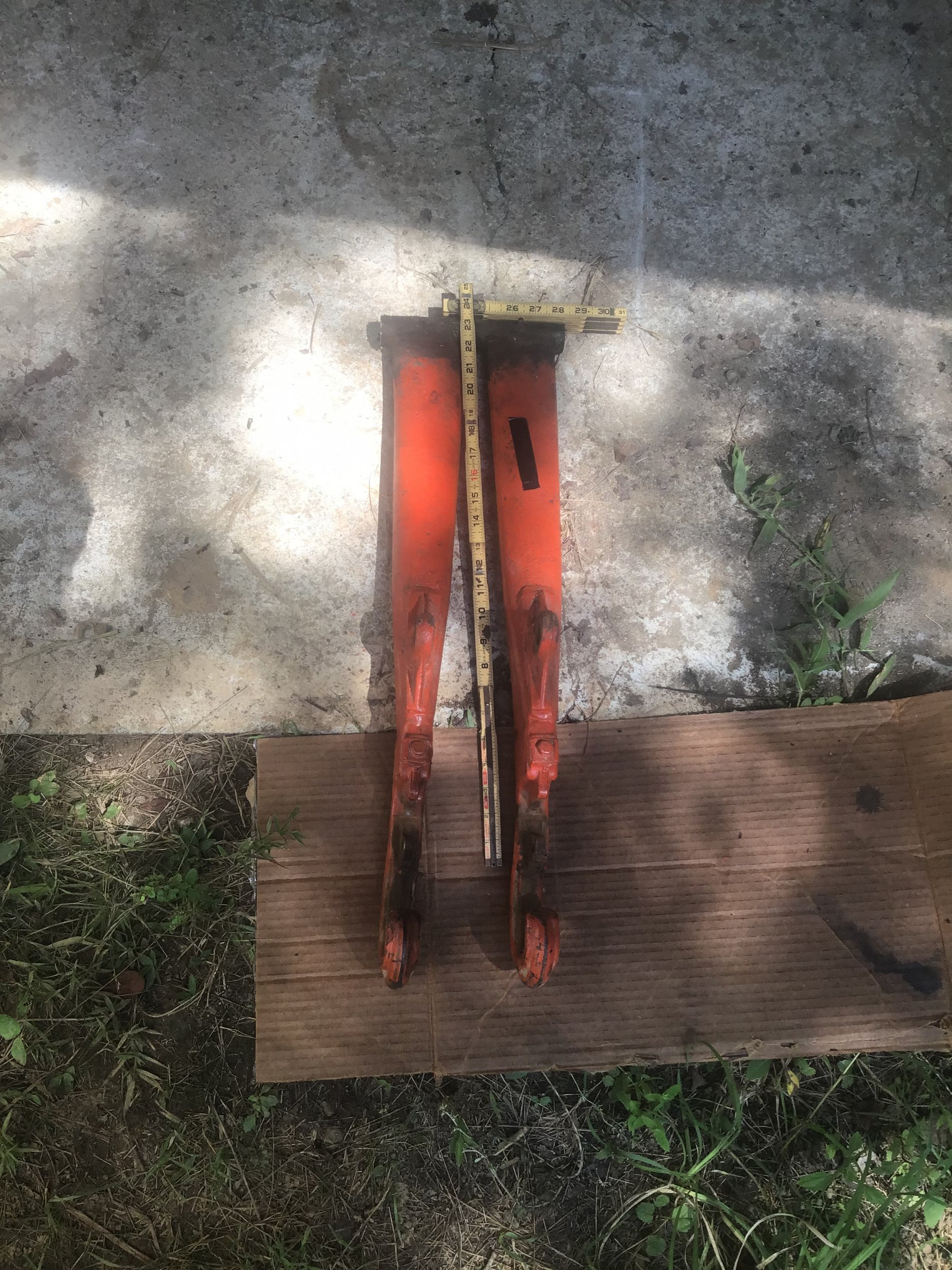

First two photos are the two arms on one pin for alignment, and the folding ruler is set at 90 degrees.
one arm has a piece of electrical tape for differentiation for the left-right placement. You can see why swapping the arms didn’t work, since they were both bent in the same direction, but unequally (and I don’t get THAT unless a pin slipped out in the process…).

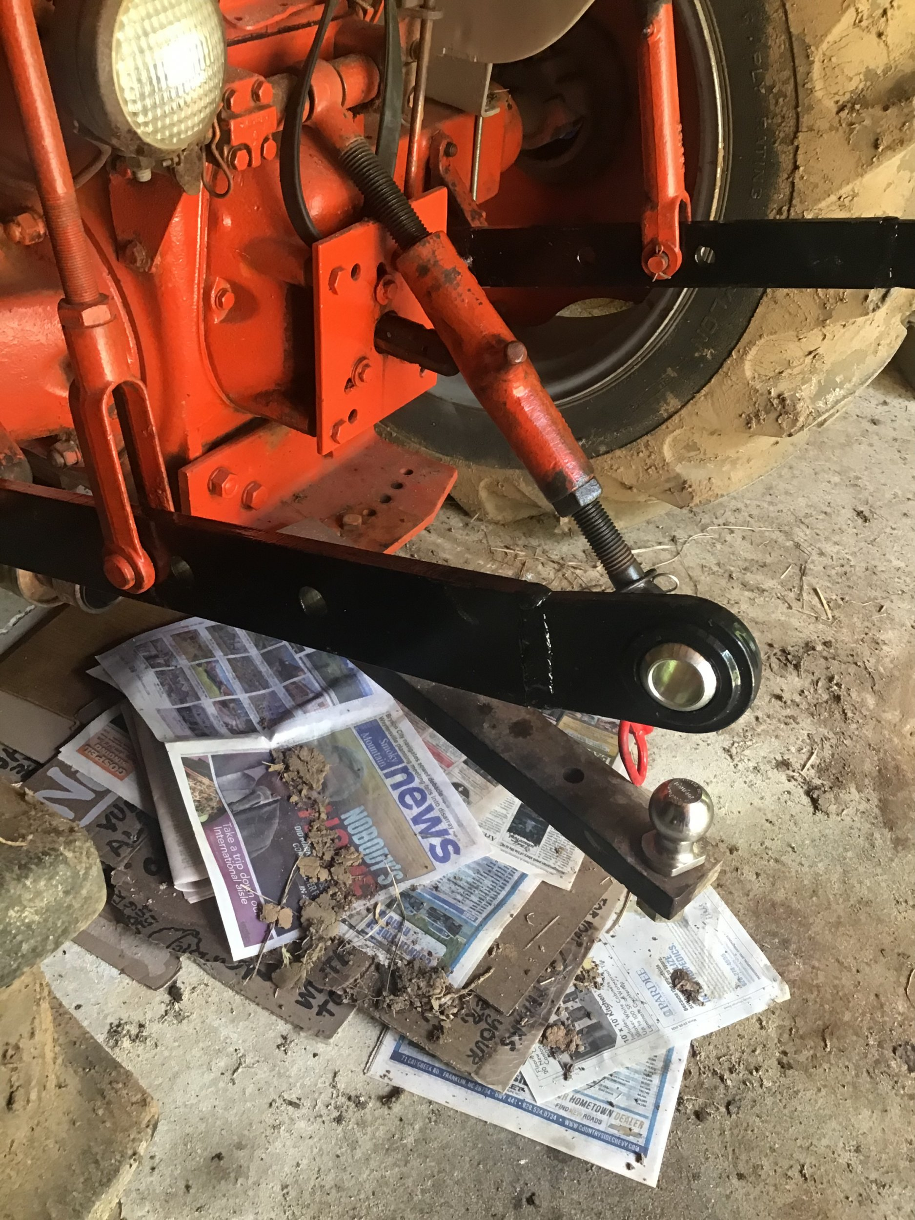

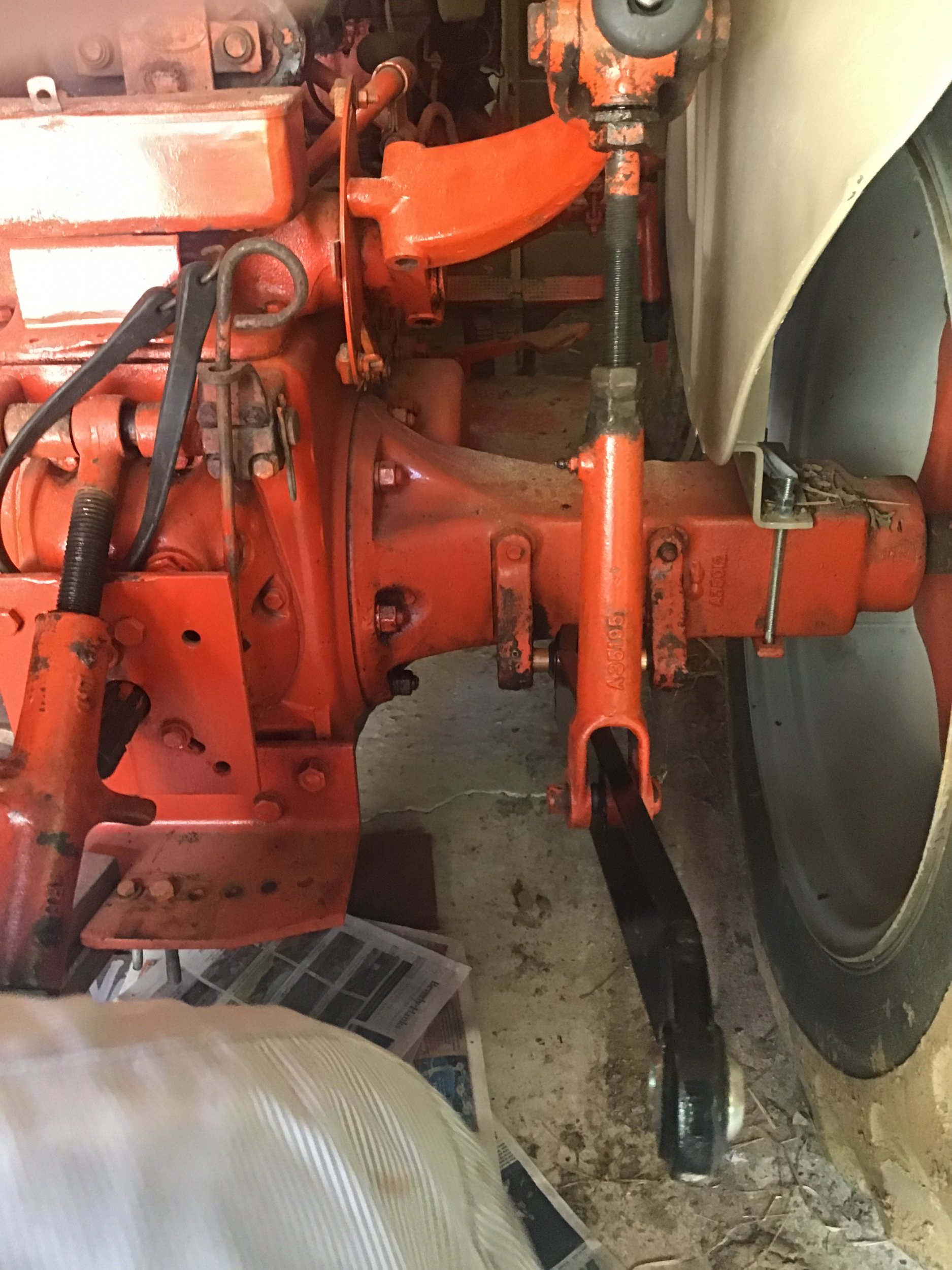

Here it is with two universal replacement arms. The original shafts are 3/4, the balls are 7/8, so I made bushings out of 3/4 copper pipe which fit snuggly in the ball and reasonably snuggly over the shaft.

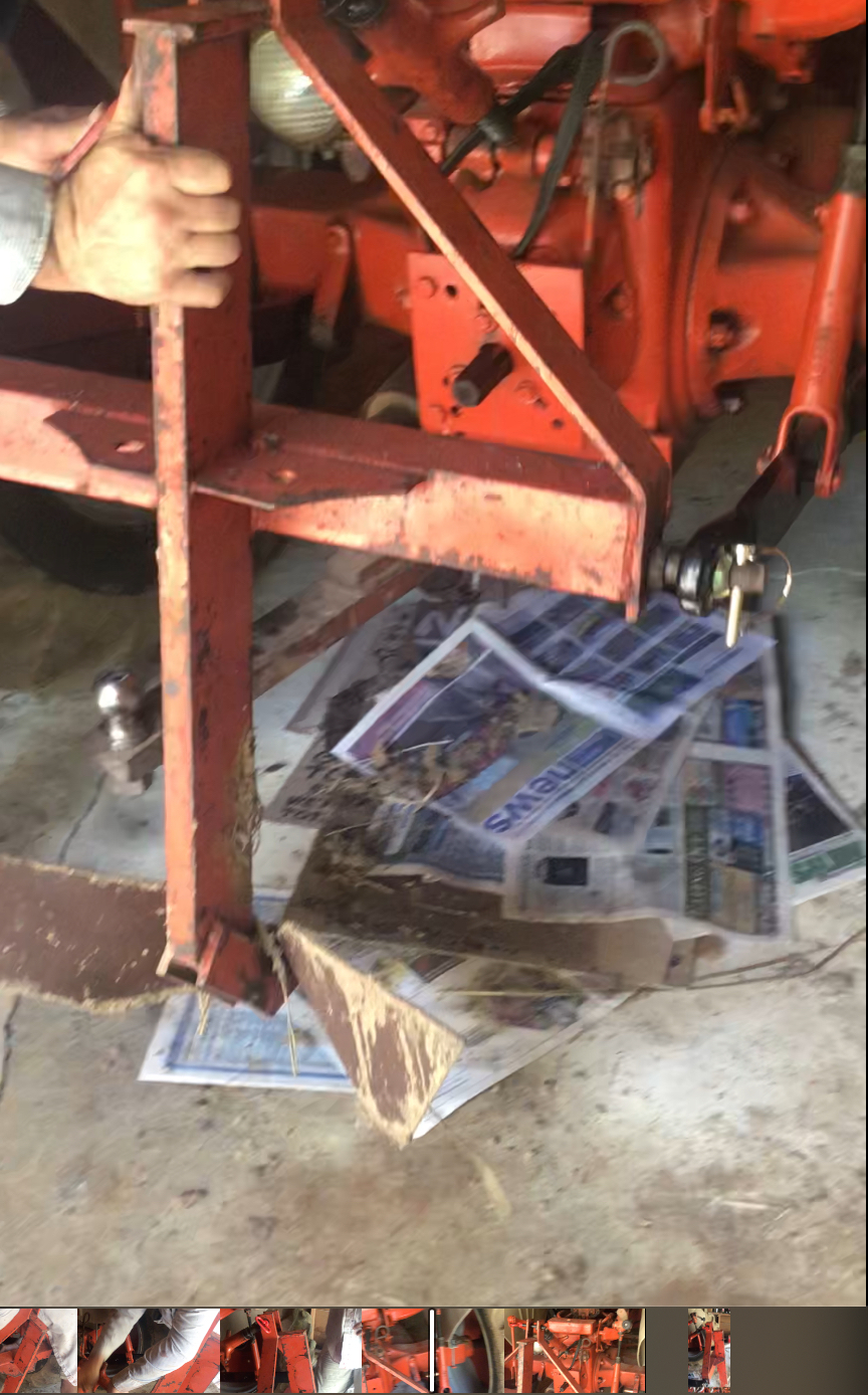

A couple screengrabs from the video (MrsKilroyJC insists on portrait not landscape…)

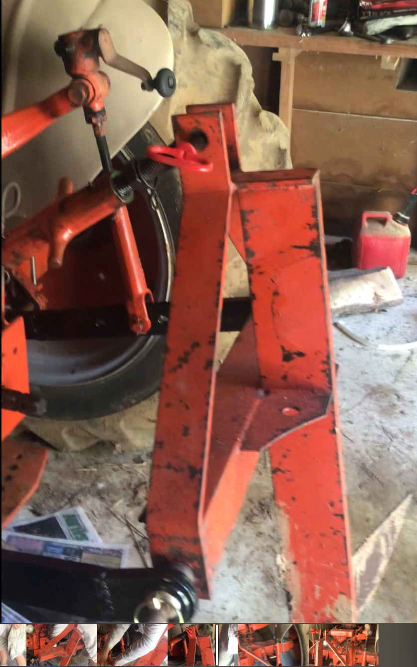

#17
