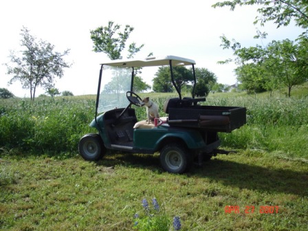

I have a 1998 36v EZ-GO that I use around the place, I don't have miles to drive so electric was my choice, it's nice and quiet and does what I need it to do.
If you do happen to go with an elect EZ-GO don't put too big of tires on it, the rear drive drums can't handle it and you will loose dust caps on the fts.
