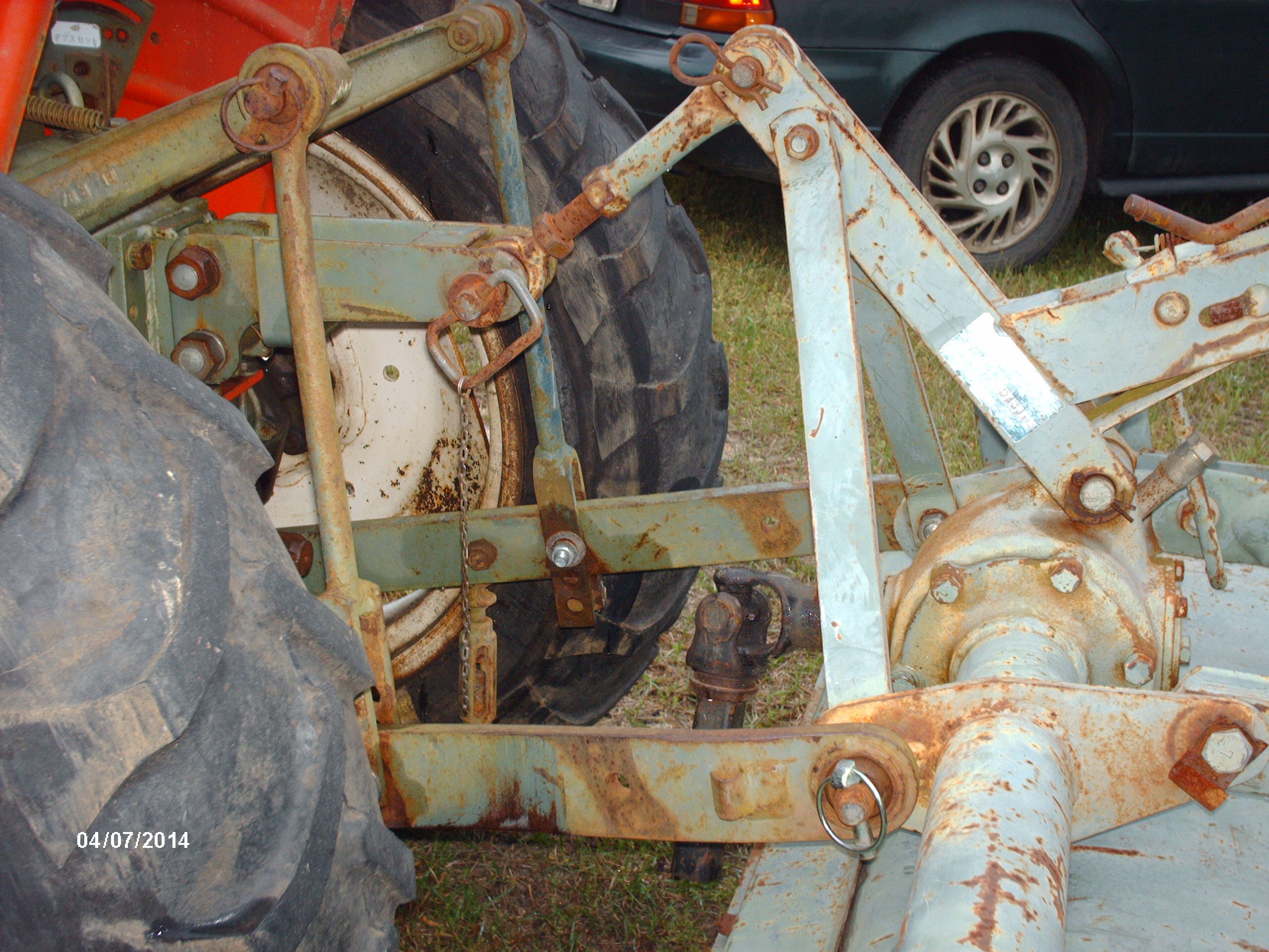

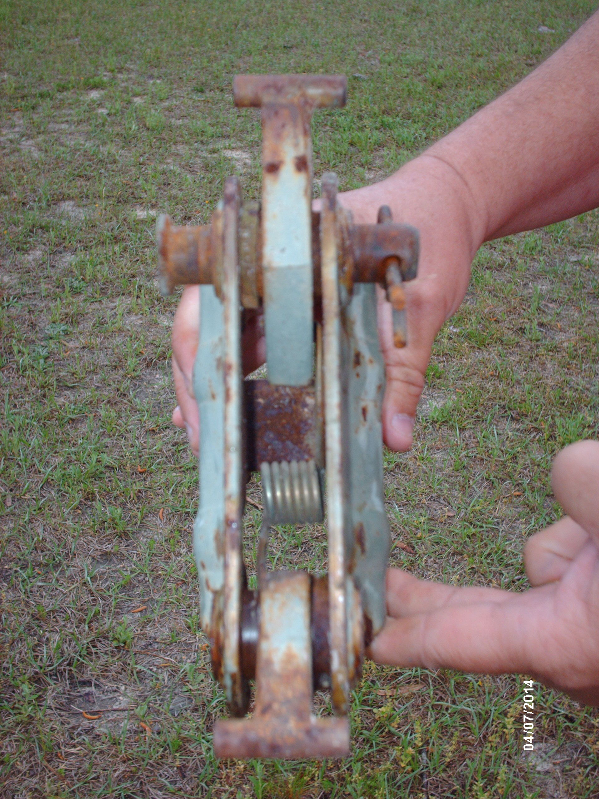

Back with news and questions!! Since the new year has rolled around I have been Pulling 75 -80 hrs a week. Just got the tiller to the house last week. I will include pics later when the wife gets home Monday. I did try to hook it up and have a few problems. The top link has a very short link and a triangle piece that I have never seen before. and the PTO shaft seems to be too long by a couple of inches.. Any one want to enlighten me on what I need to do to attach the top link properly.

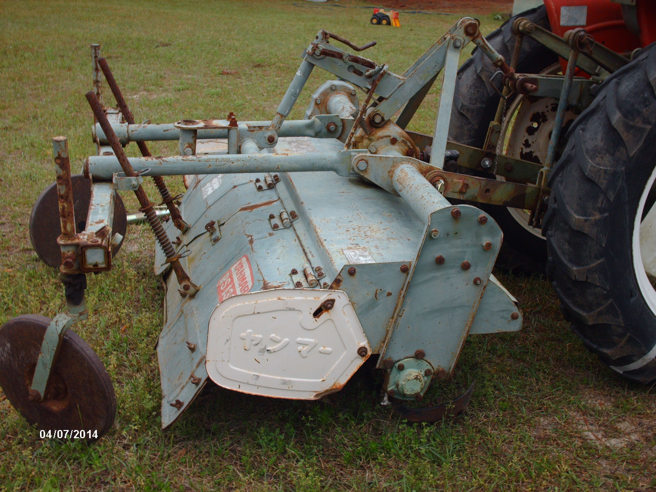

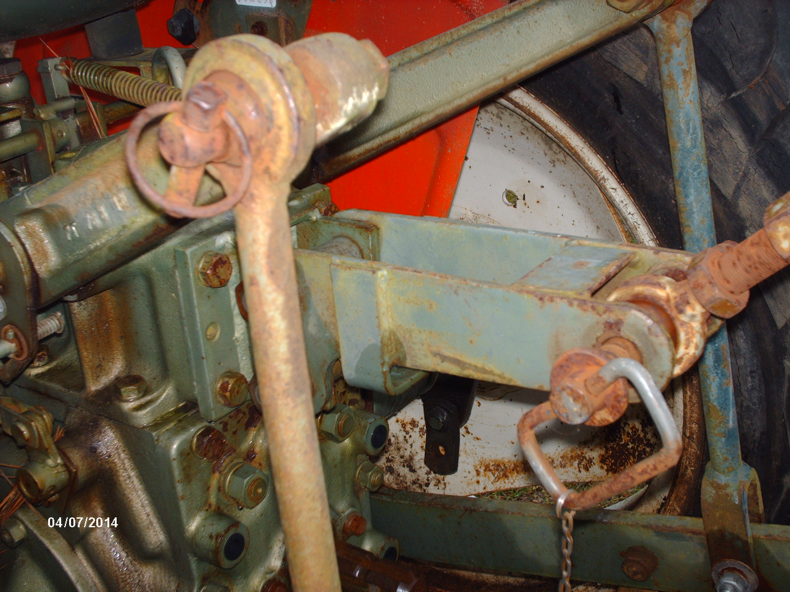

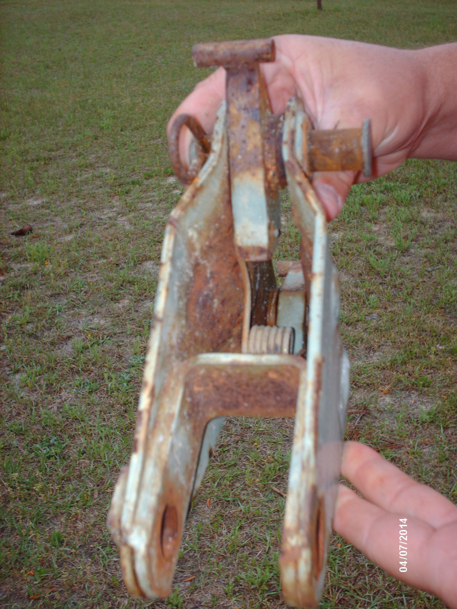

Back with Pics!! Thanks for all of your input. I have attached some pics and hope to shed some light on the situation. The triangle part was attached to the top link area of the tiller and had the short top link attached to that. It may be that the side link arms need to be connected to the lower lift arms further out changing the overall geometry of the connections..here it is for your inspection and corrections.. Fire away!!

Your two pictures where the tiller is visible, and the final picture, look correct. When you get a driveline attached, it looks like you are ready to start tilling.
I don't recognize pictures 1,2,4. Maybe for some other tractor?? Anybody?
And one more comment - a dealer on here once suggested open and re-grease the off-side tine shaft bearing (picture 3). He said these tillers may have had water in there for years, and spinning a rusted bearing will destroy the end of the tine shaft. Wheel bearing grease. In fact he recommended replace it with a fully sealed bearing then forget it.
