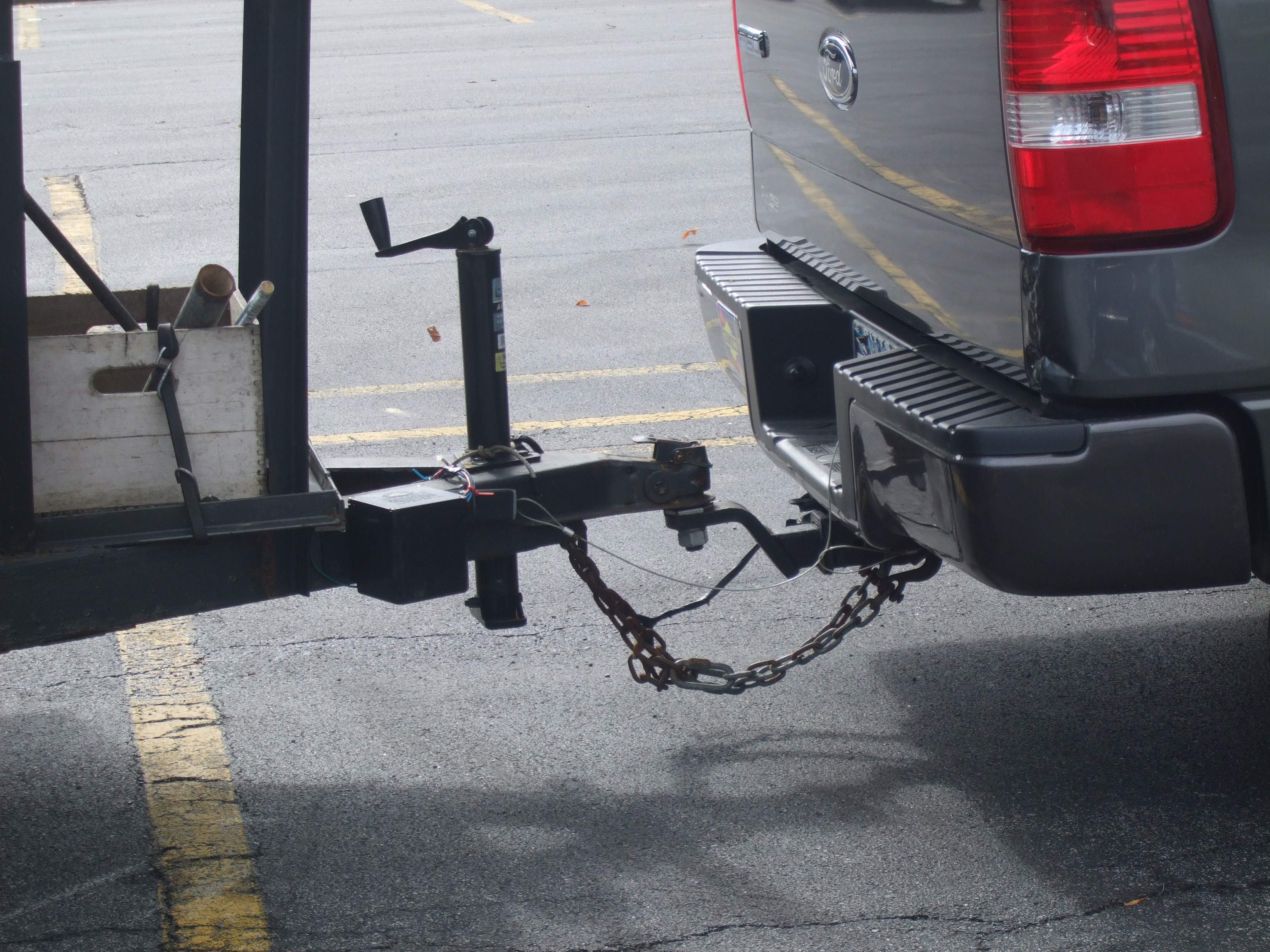

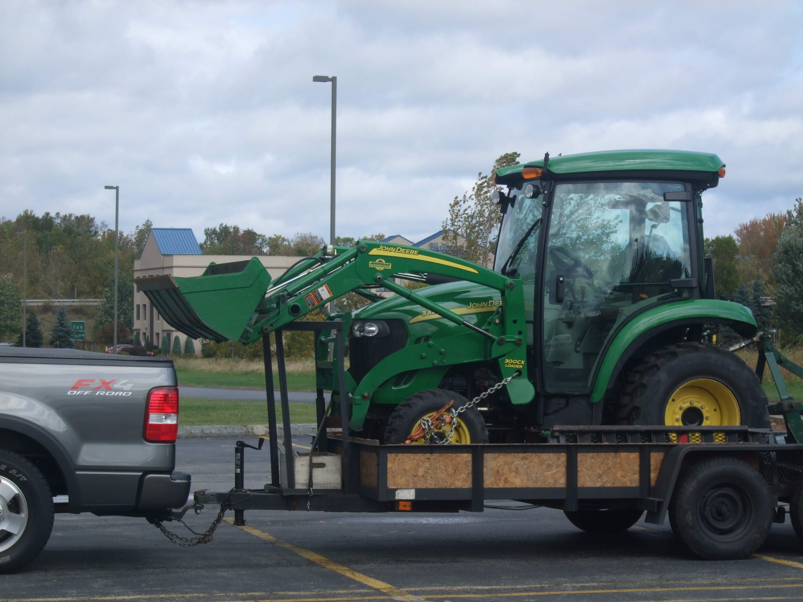

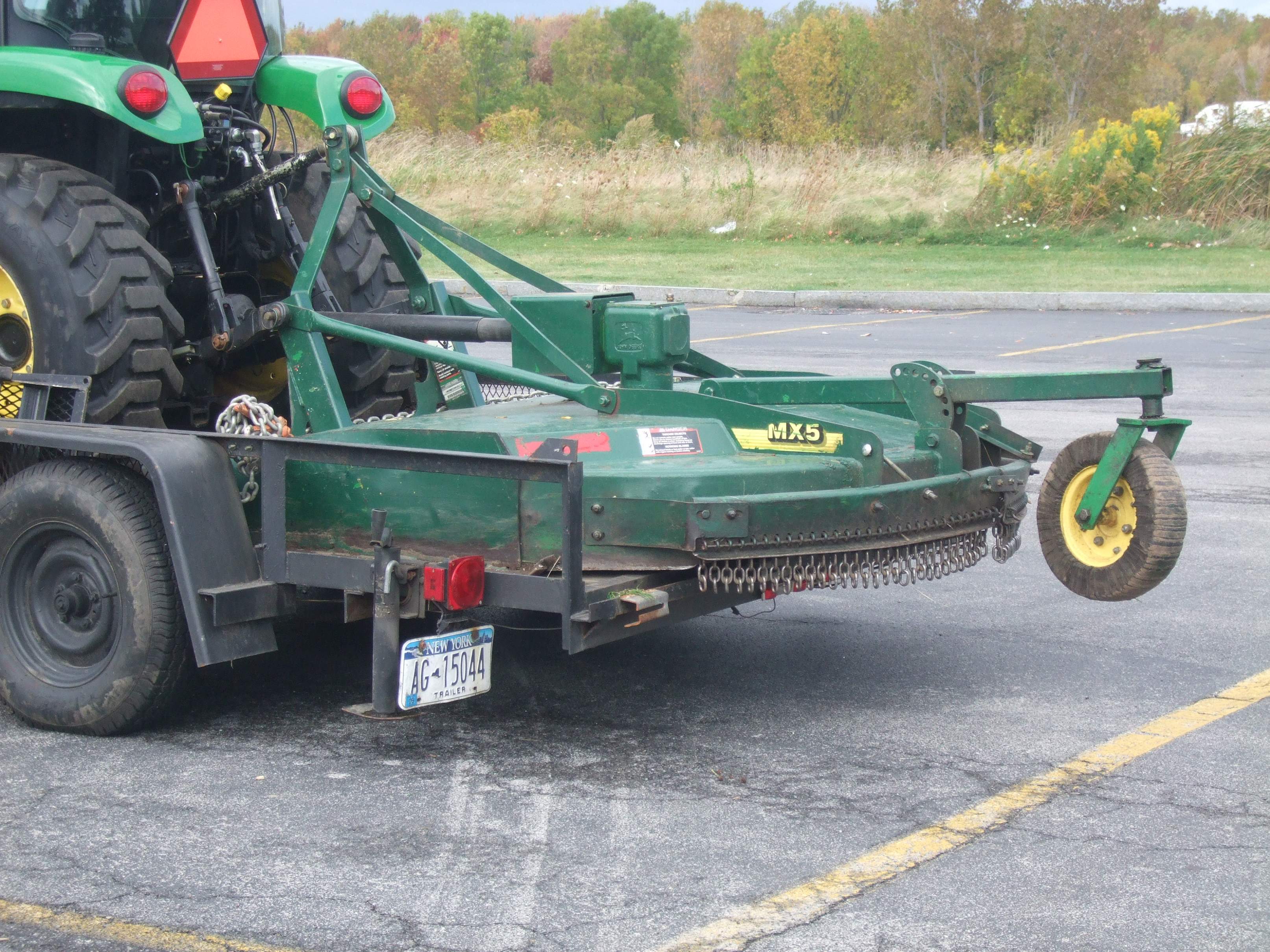

I just saw this today. The pickup had a DOT number on the door. He had a
FEL up in the air resting on a homemade FEL stand, over the rear of pickup. At least he is using chain a binders pulling it forward, no other method of tiedowns. He also had a bush hog sticking out the back as well. The hitch ball looks like a 5 or 7k rating maybe ? I am not sure what he hobbled together to make the chain longer in the middle.:rolleyes:

Hey, that is my truck! Na, just kidding. I am not a JD man. Anyway according to TractorData.com that 3320 weighs 3,570# and giving 700# for the Loader and another 700# for the Cutter would put him just shy of 5,000# load. The trailer weighs about 1,300# so he is not overloaded and he does have brakes but he is obviously not distributing the weight properly. The trailer is just too short. And like you mentioned he needs a better draw bar or even just a Weight Distribution hitch.
