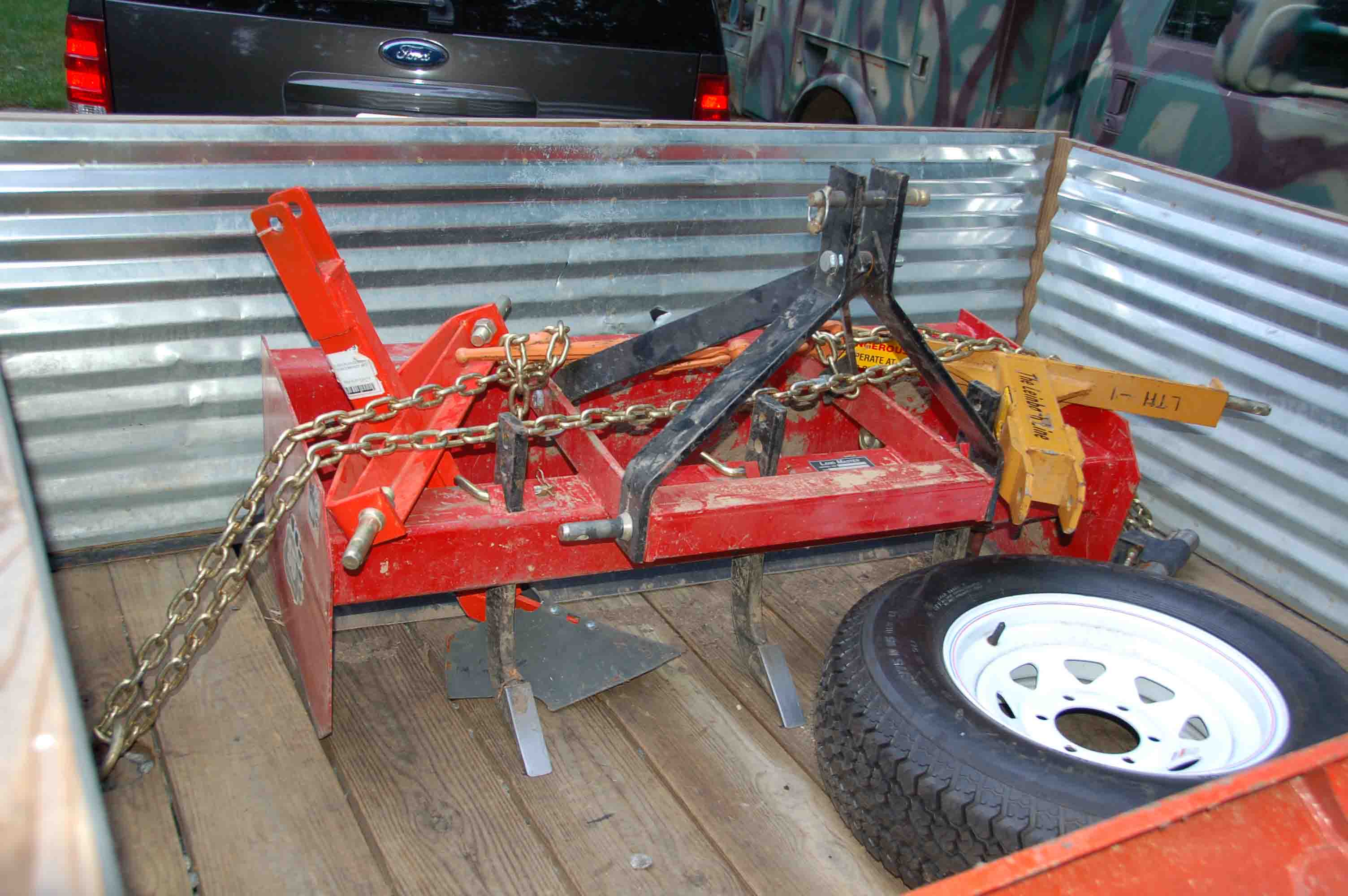

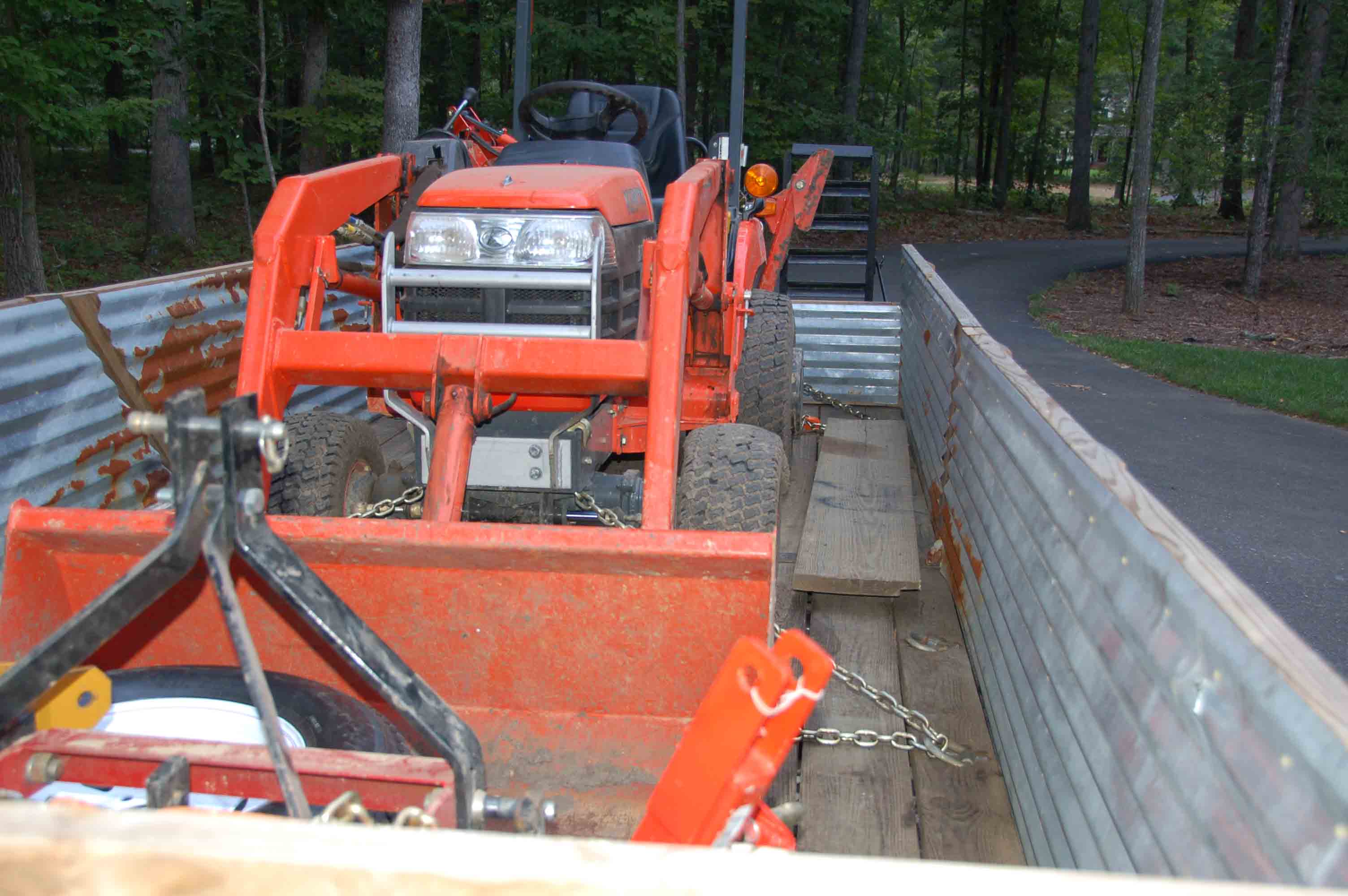

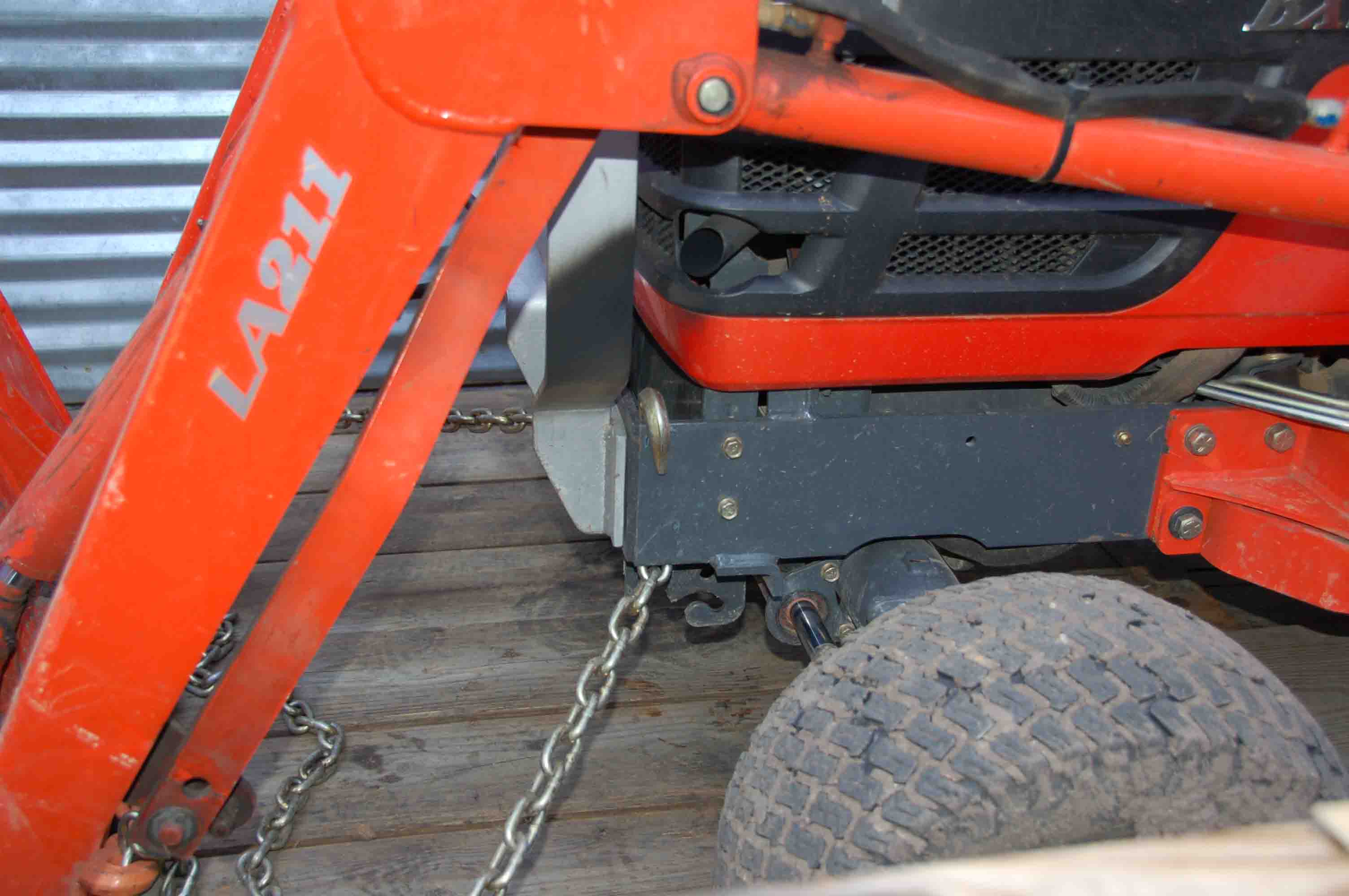

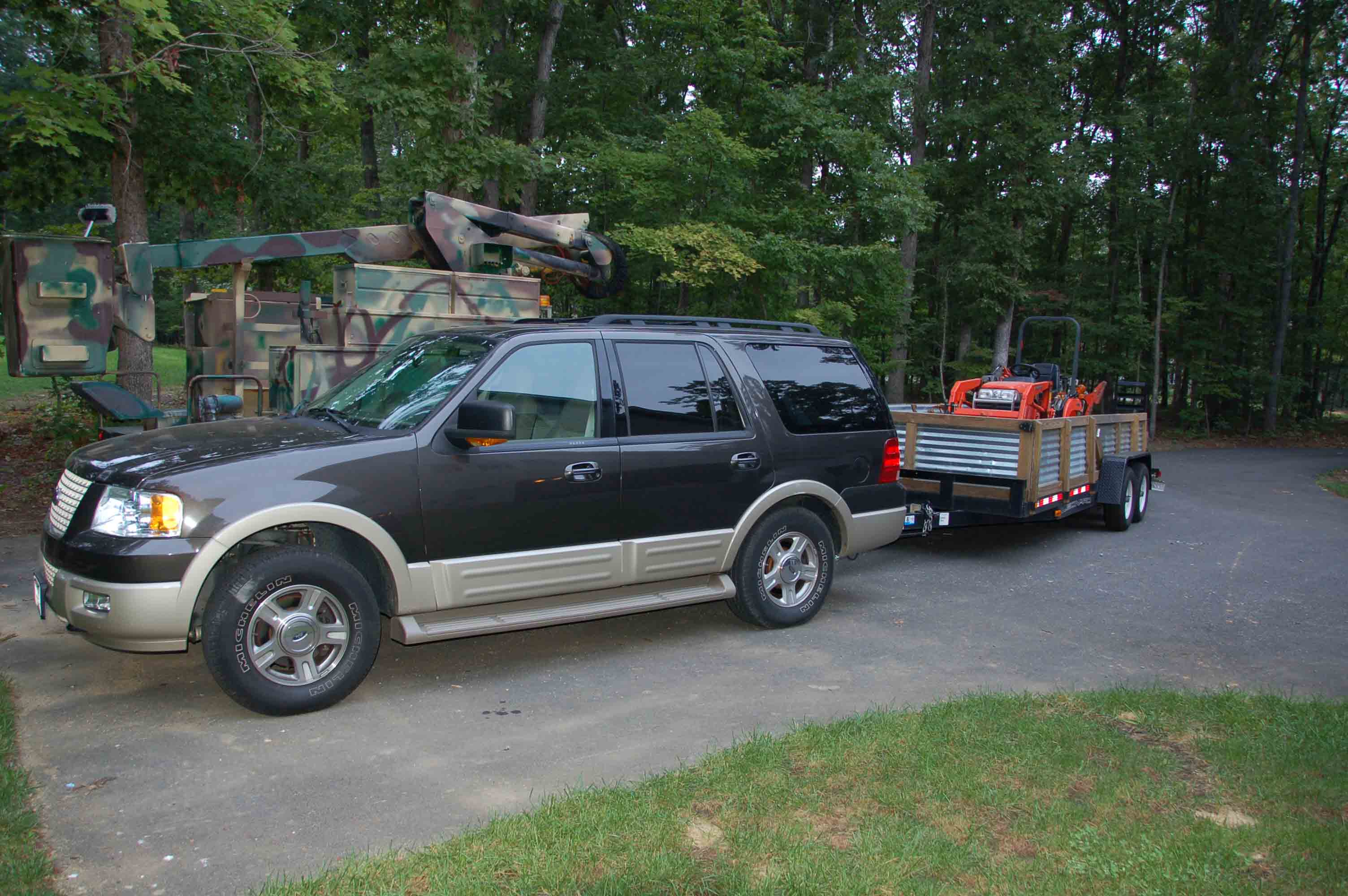

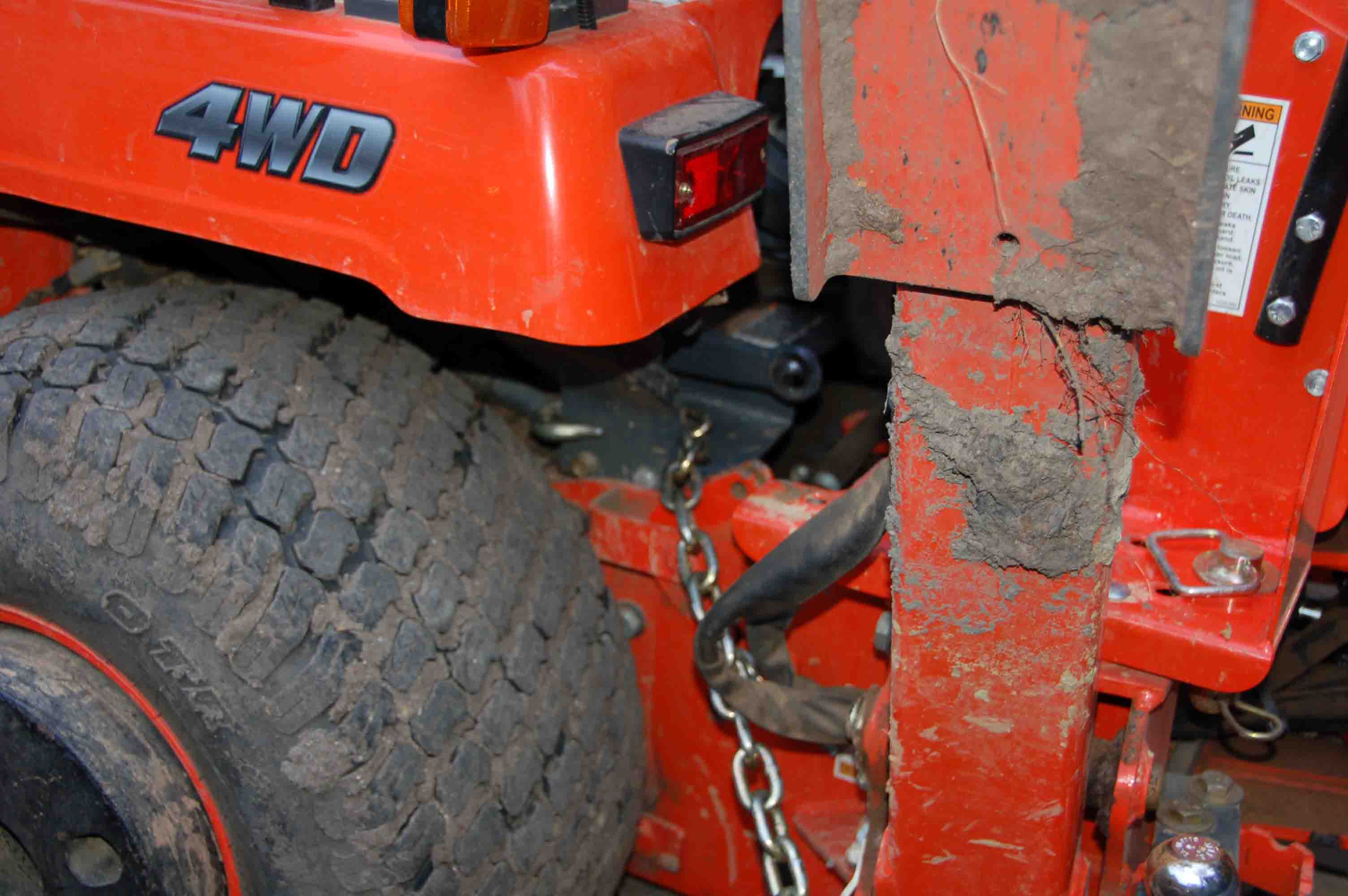

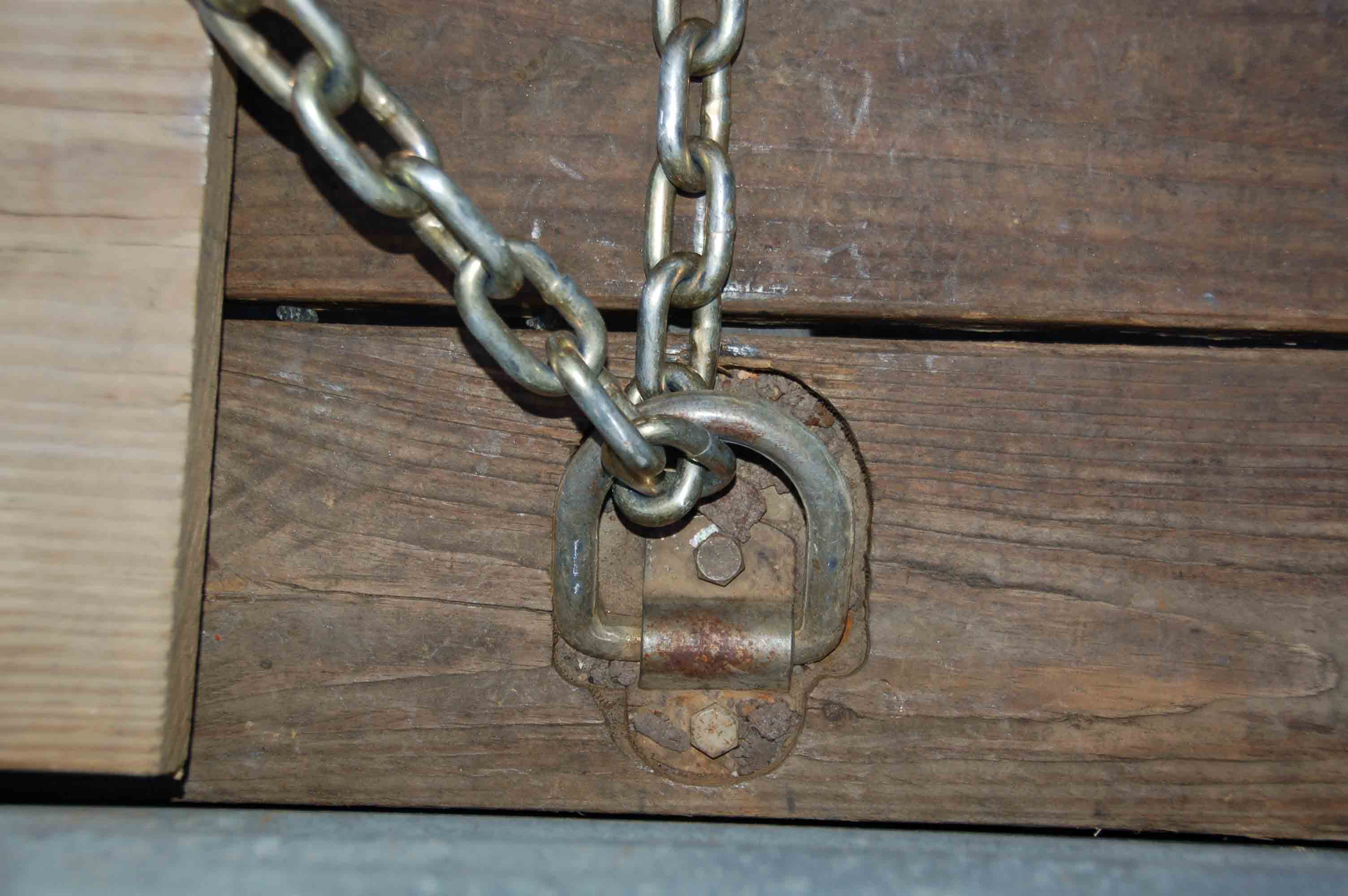

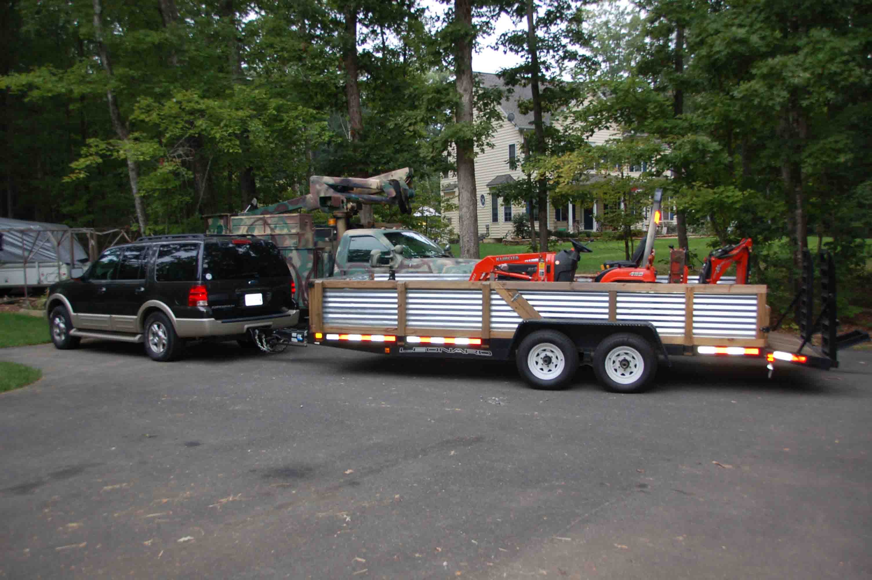

FINALLY took pictures of my truck-trailer-tractor all put together.
Just thought I'd share what is, in my opinion, the best possible tie/tow job in the galaxy. No, check that...in the UNIVERSE. MINE.

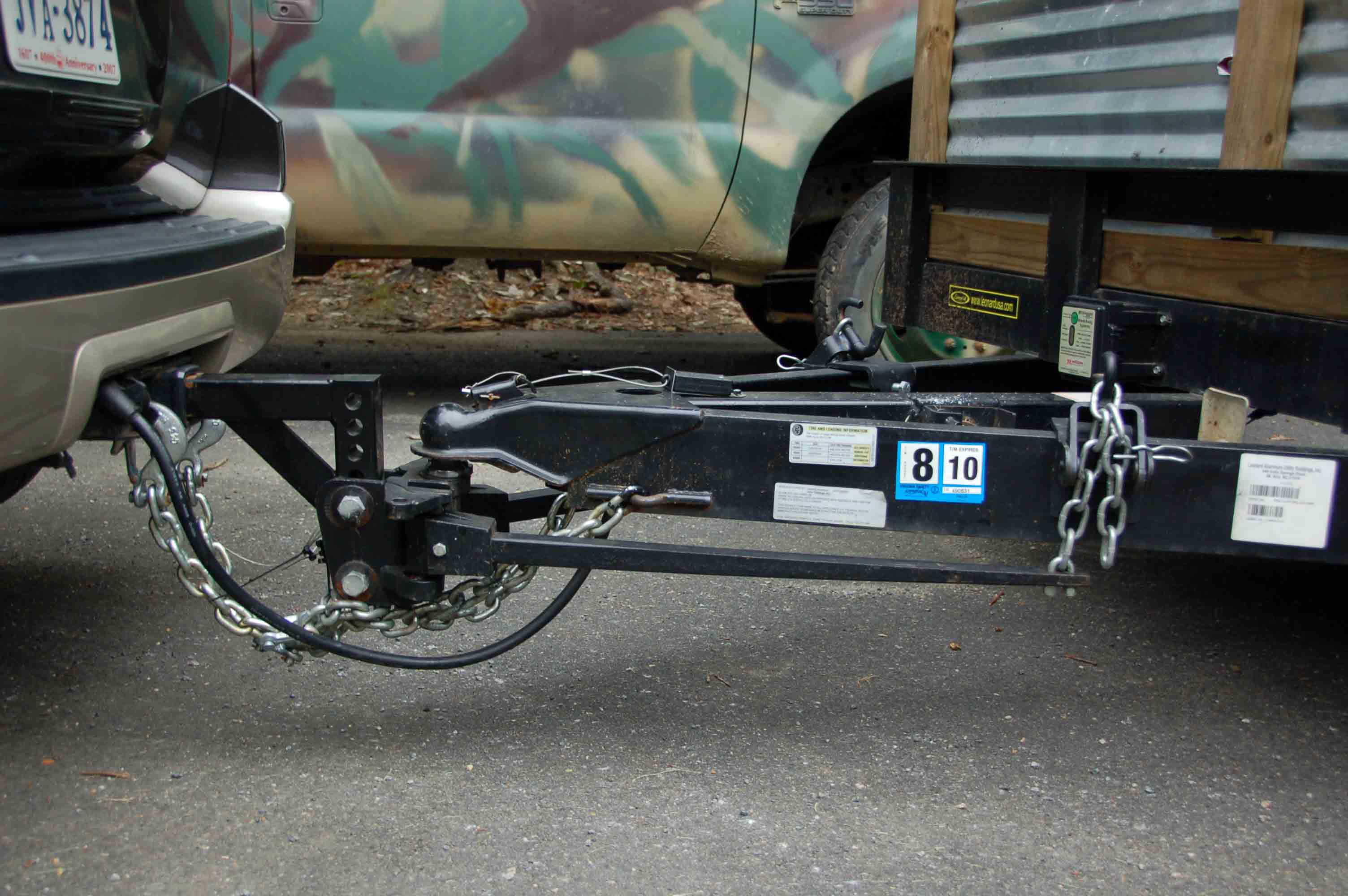

G70 chains looped through 10k hoops bound to the trailer cross-members by Grade 8 bolts. Chained tight front and back by the tractor frame. Implements similarly chained down.
Some will nix me for doing the "looping chain" maneuver, using only two 16' long chains, one front and one back. The alternative being 4 independent chains, one on each corner. Considering one single chain could clean-jerk 1.5 of my tractors straight in the air (at rated working capacity), I figure I'm pretty good.
I also earn a demerit for the loose spare tire. I only carry it with me when I leave town with my trailer and haven't gotten around to a proper mount. It just sits between my box-blade and my FEL bucket and doesn't wander around much.
As you can see, even with this tiny tractor, the 20' long trailer (18' deck) gets used up in a hurry.
The rig tows like a dream behind the Expedition...70 MPH and 12 MPG. I have a very minor issue in that the trailer 'wanders' back and forth very slowly as I tow. Not the short frequency sway that is so obviously dangerous...just something that gives you what my wife calls 'sea sickness'. I have a friction sway bar for my travel trailer...I just need to add the little ball to this trailer and attach. Should straighten that right out.
Thank you for letting me share how awesome I am. You're welcome.
And by the way, as a German, and Engineer, and a Lutheran, painfully dry sarchasm is but one of the many services I offer for free. Like it or not.
