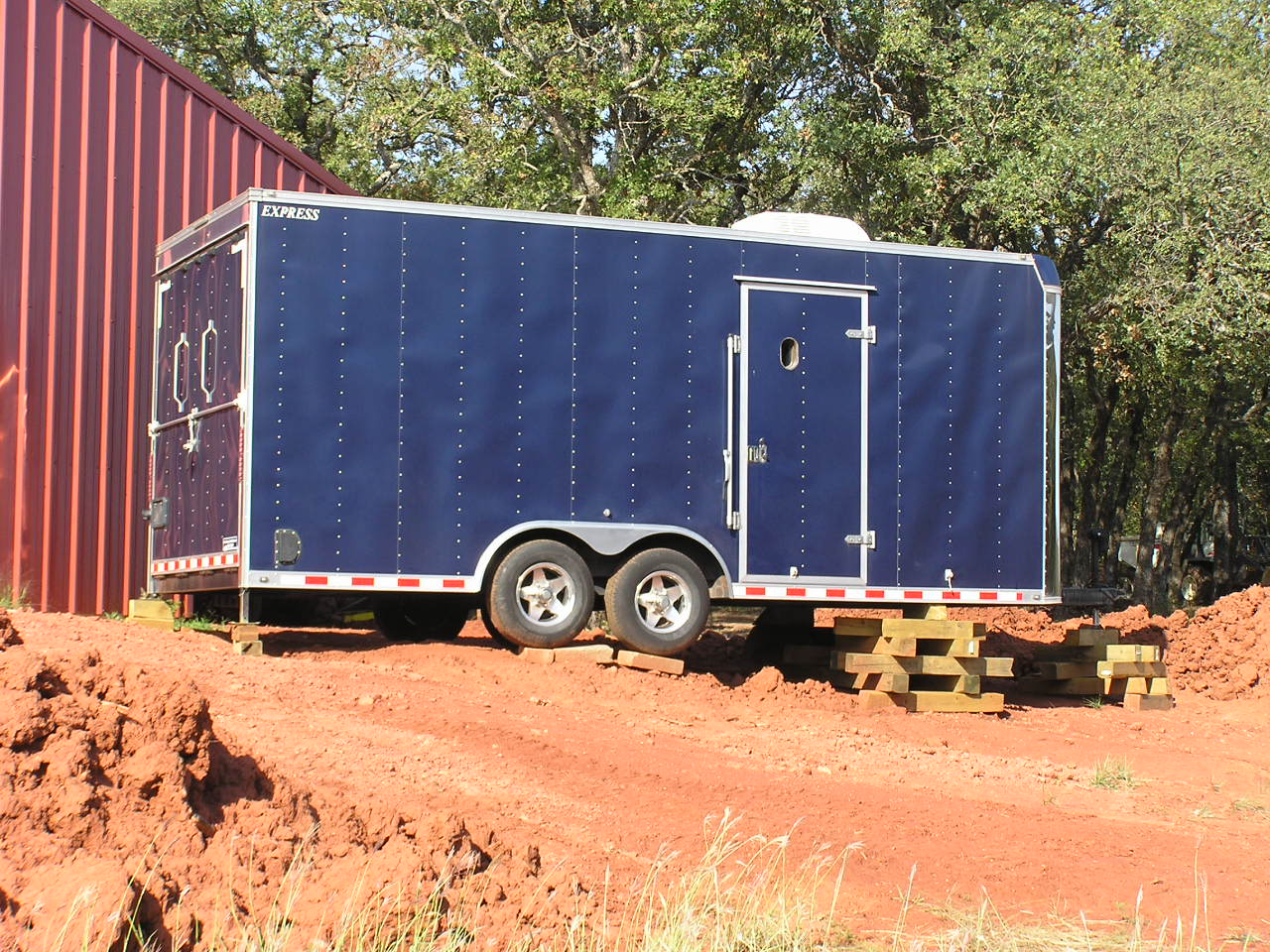

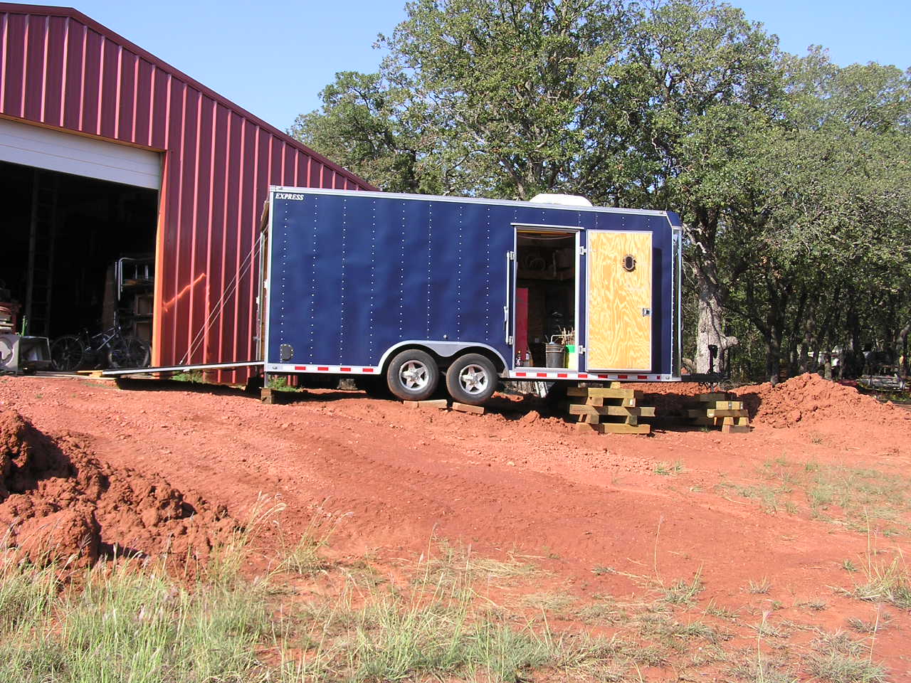

I bought this one on craigslist, used it to move the good junk to the new shop.
The guy I bought it from called and said he wanted to buy it back for what I paid him. Sold. :D
Welcome to Express Trailers
8' wide, over 7' high, don't remember if 14' or 16' long. Very well built.

I bought this one on craigslist, used it to move the good junk to the new shop. The guy I bought it from called and said he wanted to buy it back for what I paid him. Sold. :D Welcome to Express Trailers 8' wide, over 7' high, don't remember if 14' or 16' long. Very well built. <img src="http://www.tractorbynet.com/forums/attachment.php?attachmentid=466956"/> <img src="http://www.tractorbynet.com/forums/attachment.php?attachmentid=466957"/> <img src="http://www.tractorbynet.com/forums/attachment.php?attachmentid=466958"/>
That's a nice looking trailer! Looks like you used as a shop for awhile.
Yep, thanks.
No, the shelves were in it. Didn't get any pictures when it was packed full, it was rated for 7K, and most likley overloaded. :eek:
I parked it there so I could take my time unloading it.
