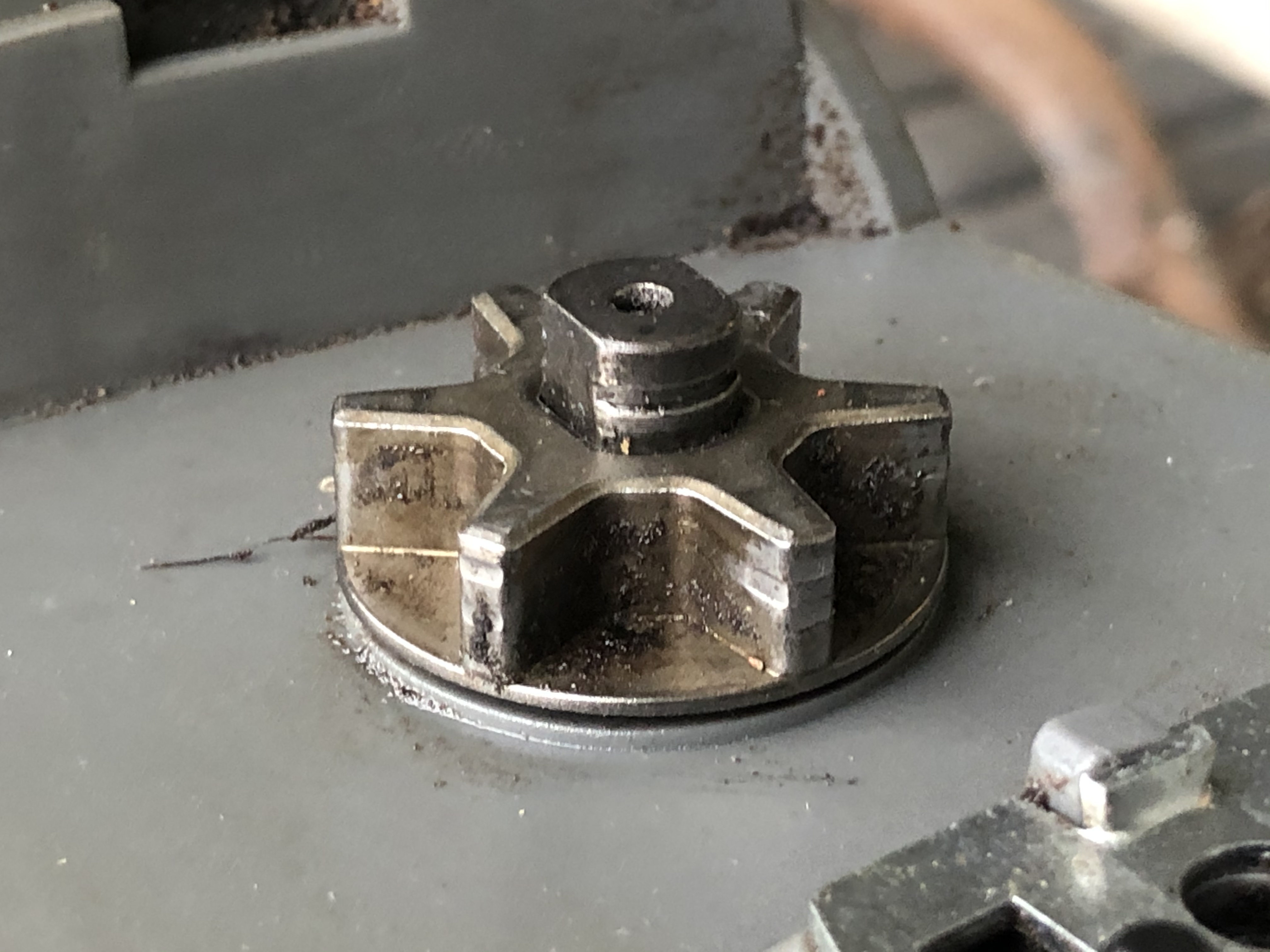

I was trimming a live oak, in one of our pastures, yesterday with my HF Lynxx 40volt pole saw. I use it for everything below about 10' and it's been very reliable. It started making a racket and wouldn't drive the chain so back to the shop and took it apart. Lost a circlip and the outer plate that keeps the sprocket aligned.
I did some internet searching last evening and think I found what I need. Found Oregon PS250 sprocket, circlip, and 2 plate washers, on eBay, for $17.95 with free shipping, free returns. It won't be here until next Friday but I can borrow the circlip and plate washer off of my Lynxx chain saw, in the mean time.
I was using my pole saw yesterday also. It started making all kinds of noise. Then chain stopped turning. Took it back to shop. Disassembled whole front end. Found that bolts that hold motor to a bracket had come out. Put them back in and assembled. Ran like a charm again. You may want to take a few screws out and check the bolts in yours. Easy to put back together.
