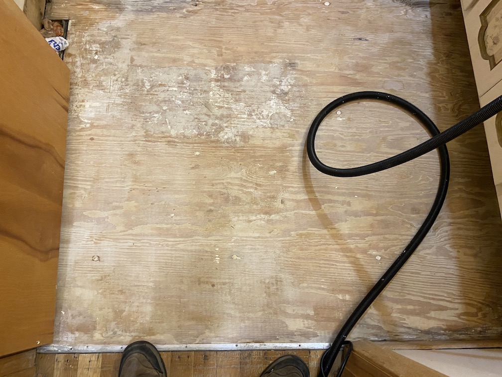

New toilet and tile unloaded and moved back to the bedroom.
Taking a break while Wagner Power Steamer cools so it can be refilled.
Goof Proof Shower seat checked for fit, will have to be cut down from the 30" to the 24" version. Preliminary decision made, as to which wall it's getting mounted on ... :D
Also checked Redi Niches for fit and location.
Screwed in a 2 x 4 on top the ceiling joists for the stairs going into the basement so I can crawl up there and handle the insulation that has fallen down.
All towel rack, tp holder, and window covering hardware taken down and removed.
Last of the backsplash tile around sink removed.
36" x 42" wall mirror removed and stowed behind The Woman's armoire for safe keeping.
The Woman steamed off the wallpaper on the one wall the mirror was on.
Some scraping and removal done of the old mastic on the entry threshold into the shower.
Most of the mastic that was used to adhere the vinyl flooring removed:
Section on the upper middle left is after the first pass which removed the worst of it, it still needs hit again though to get the last of the adhesive.
That stuff (the adhesive) was near impossible to remove with a heat gun ... it was probably 1/32 to 1/16 thick, with the bottom layer of the linoleum still stuck to it.
It was apparently water-based ... so Wagner Power Steamer took care of it in short order ... thought it might ... turns out that was correct ... :thumbsup:
Progress ...
Got a Wagner steamer. Thanks for suggestion it works to remove mastic. I need to redo my downstairs powder room flooring.
   / Good morning!!!! #123,089
Worked slick as snot here ... hope it does for you as well ... :thumbsup:
