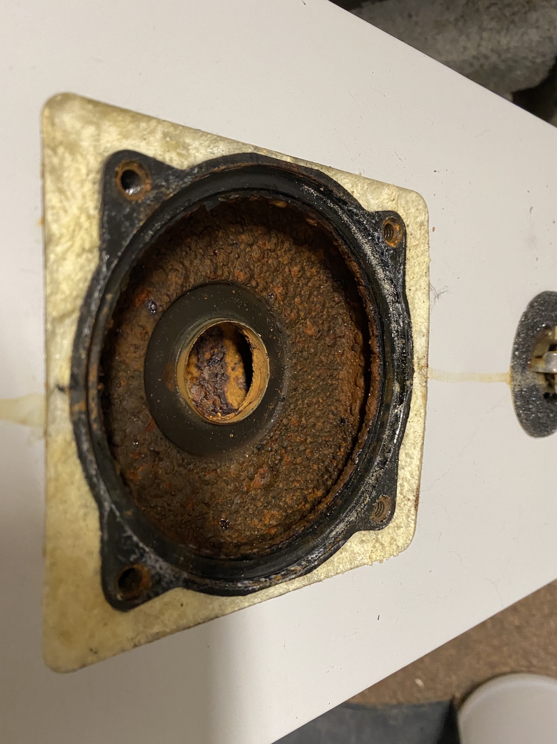

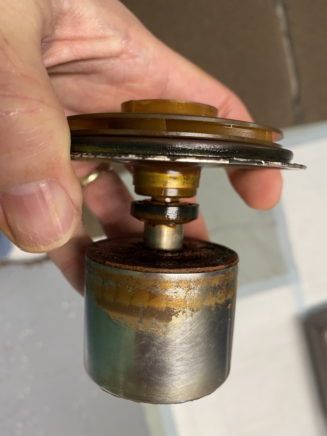

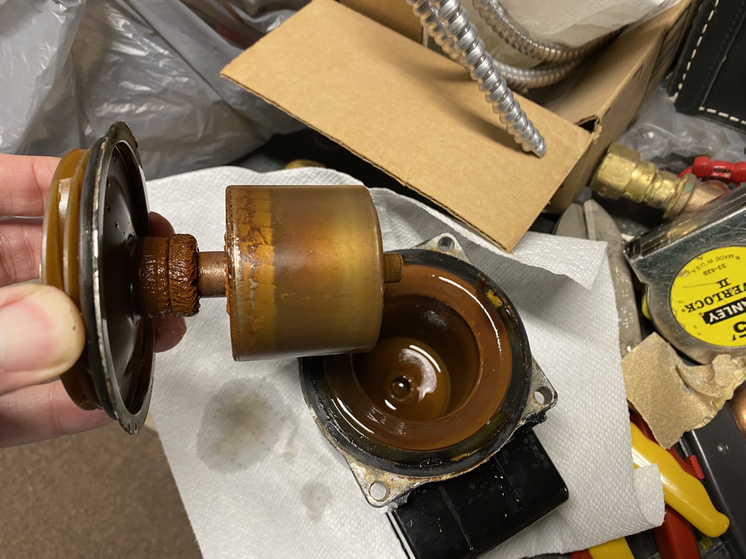

Took apart the geo pump motor from the first flow center to fail 2 yrs ago. Lot of rust or crud where the propeller goes.
Motor was stuck at first, but a little pressure got it turning. Motor is water cooled and was still wet, even though I drained the flow center at least a year ago.
Pulled pump body out, full of gunk. Looks like mud. This is a closed loop system, that I filled with clean water so not sure what it’s from. The water looks clear.
Cleaned it up a good bit, put it back together for now with water in it.
I suspect if I put it back together it will work, but I think I’ll take the one still working in the just failed 2 pump unit and put it in this unit as a spare 1 pump unit. Need to pull apart the other failed one to see what it looks like.
Was 32° earlier with heavy fog. Up to 51° now. Working on work stuff now.
Looks like iron in the water. Even though it's fresh and clean it will still have minerals in it. Those minerals will collect on surfaces over time.
Iron, calcium and lime usually play havoc on those little pumps.
I'll have to remember to take pictures of a salt water pump the next time I have to rebuild one. Those babies will get clogged and locked up tight. Although they are usually fairly easy to clean up. Just suspend them in vinegar for about a week. And then pressure wash the pump end
