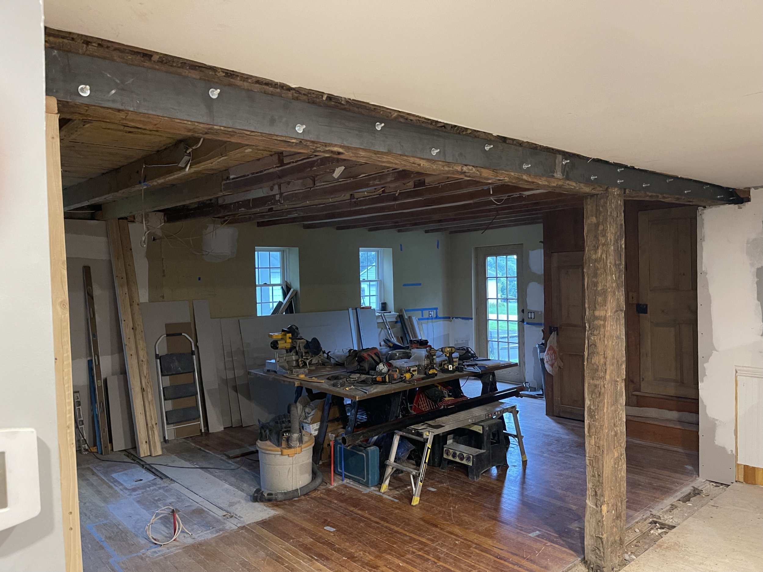

Popgadget, nice work on lining up those Flitch plate holes. Did you drill 2 holes fully through from each end, then others half way from each side ?
Drilled them all straight through from one side. I used a magnetic drill press, and leveled and squared it for each hole. Used a conventional twist bit for the full stroke of the drill press and then finished with an auger bit using the first hole as a guide. There were a couple of holes that we couldn’t use the drill press on because of clearance with the floor joists above. For those I made a 2” thick block with drill bushings clamped in place to keep the bit square and used the auger bit all the way through. The drill press weighed 75lbs, so it was no fun mounting that many times, but the result was worth it. This is in my son’s house which is the original farm house on my property.

We got the last bolts in yesterday, and removed the lolly columns. Great news was there was no movement at all as the columns were loosened. This should be the last of my involvement in his major kitchen remodel. The beam will now get covered by another hand hewn one that is hollowed out, so the end result will be an exposed old beam.
