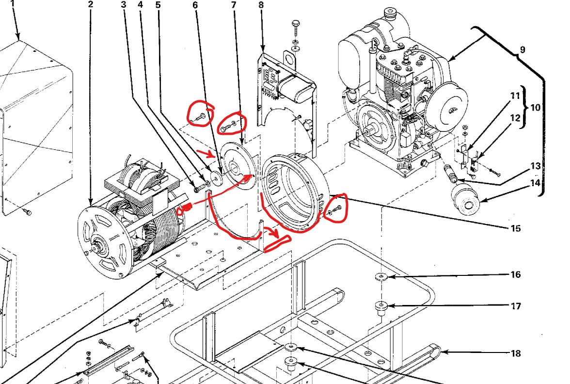

Welder report....I got the engine separated from the welder. Bad news, I broke the rear flywheel adapter #7 trying to get it off. I had the 3 point puller tight, had heated it and still wouldn't budge. So I also started prying with a pry bar from the side and "click" the thing broke. There are no parts from Miller. (same as for the Syncrowave 250 at work)...I know the roughneck is old (40+ years), but the syncrowave is not that old (13 years) and I guess they'd rather sell a new Bobcat than stock parts for an old roughneck.. :( I would tell anyone this before they put a lot of hard earned cash out for a Miller, since they don't stock low turnover parts, I'd just buy a relatively cheap inverter style like Popgadget did. Everlast or something similar is my recommendation.
The print I showed earlier had some misgivings...It doesn't show the fan wheel very well. I tried to draw how the bolts went thru the fan, into the adapter. Easy to get them off from the underneath slot. Then I took out the 4 bolts that went thru the cast iron ring #15 which would contain the cast iron fan if it exploded. Took off all the rubber mounting bolts from underneath, then had to bend the sheetmetal bottom plate down, to get the motor and #15 off.
Glad I didn't have any money in it to speak of. Just time.

Sorry to hear that. I think that the key would be an impact to the loosened retaining bolt. But that is assuming that it is seated on a tapered shaft, not a straight one.
I agree completely about Miller. My Primeweld inverter welds so much nicer than my old Miller DialArc HF that there is no comparison. But it is 40 years newer.
