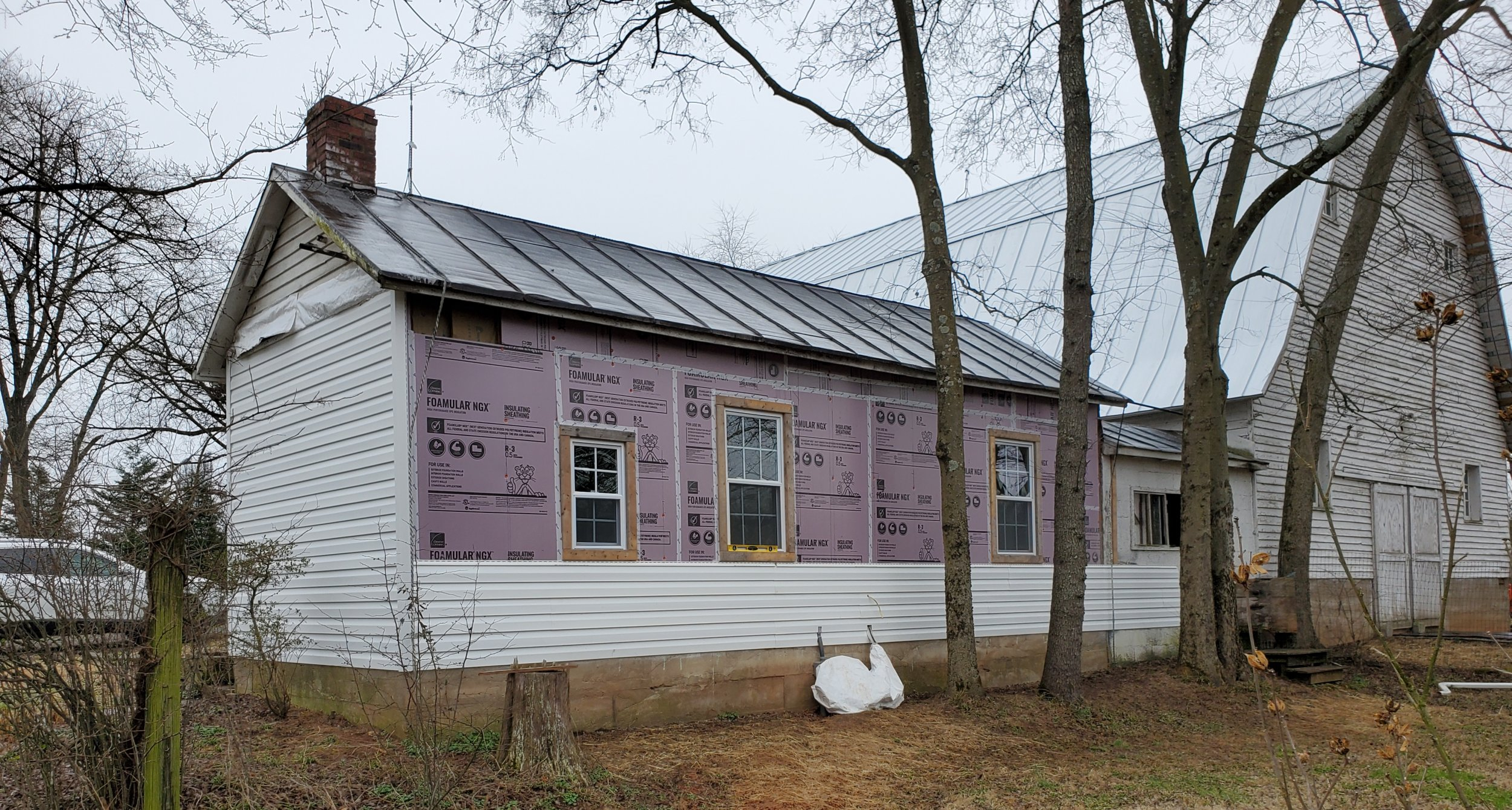

Called it a day after 5pm. Managed to work even in the rain on the Milk House. More siding up. Fingers pretty tore up from working on the starter strip as it was close to concrete. Managed to start covering up the walkway to the barn too.
More tomorrow probably.

That project looks good with siding going up. The standing seam roof is that the original roof?
   / Good morning!!!! #163,854
Yes. 1920. The barn just got a new roof. We are debating about removing the Milk House chimney....if we do...the roof will also be replaced.

Rip, the milkhouse is looking good! What is chimney for? Can it be utilized for maybe a wood stove?

No idea what the original use was for. Must have been a wood stove of some sort as the opening is like eight feet up. It is weird. Will take pictures in AM as I need some advice.

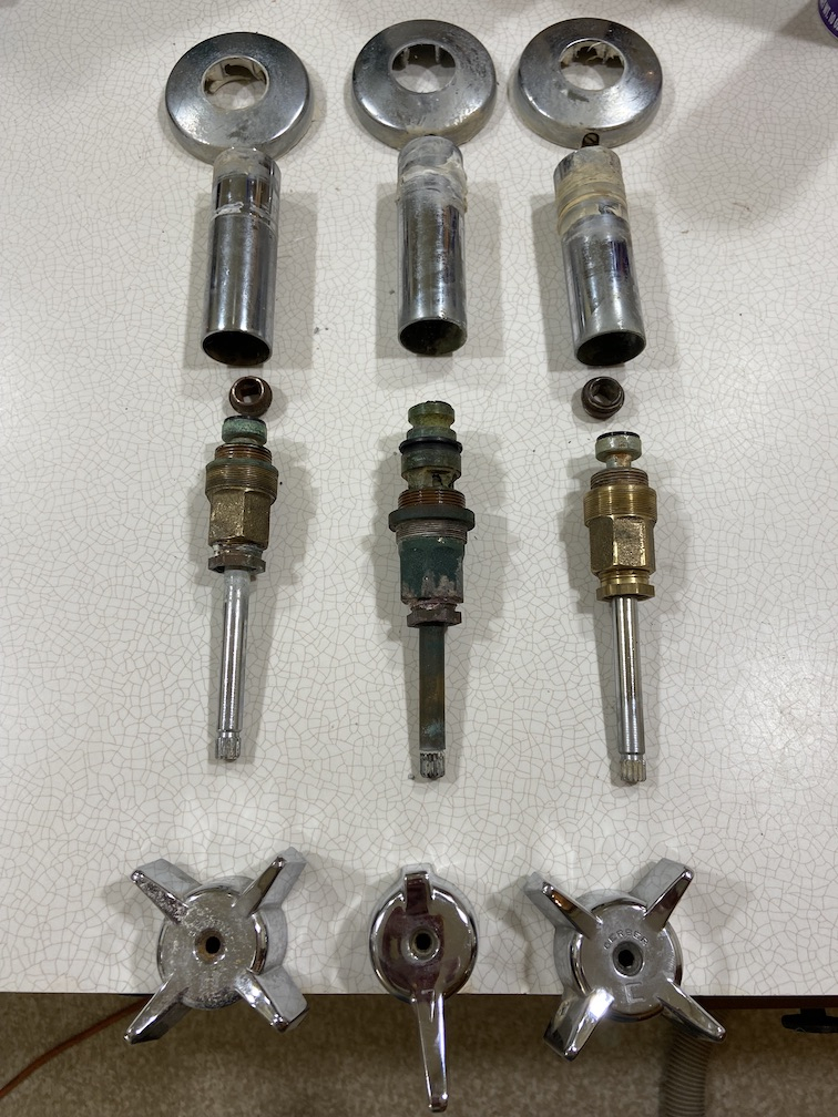

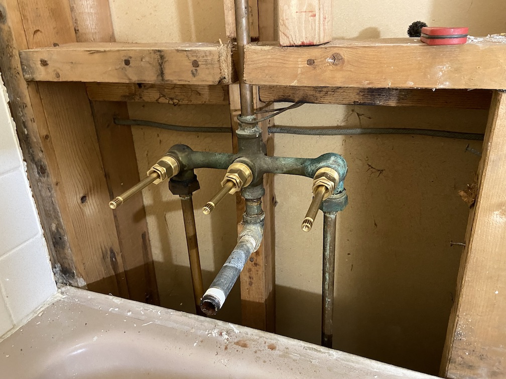

I had gotten the seat for the hot water side of the valve out earlier. That one was really critical - not a huge deal if the diverter for the shower drips a little out of the tub spout when it's diverted but need to have the hot and cold up to snuff to stop the water leakage/constant drip.
Diverter seat was a "no-go" after some additional heating and soaking with Blaster. I was putting so much torque on it I was afraid I was going to trash it completely. Woman kept wanting me to get a pipe and put the juice to it.
Nah ... don't think so ... it's only brass ... :rolleyes:
So I went up to the shop found an aluminum oxide grinding stone that was long enough to reach back into the valve to the reach the diverter seat and gave it a little resurfacing. Looks like it got all the pits out.
At any rate, valve is all reassembled with new components except for that one seat, water is back on and best of all no leaks, no drips. Only requires a light twist to stop the flow and seal the v alve:
Old components:
(Image uploading and display is still SNAFU’ed)
Think I might try taking the hot and cold stems apart, cleaning them up, and replacing the gaskets/washers just to have spares on hand.
Now on to getting new wall board put up and the tile rehung.
