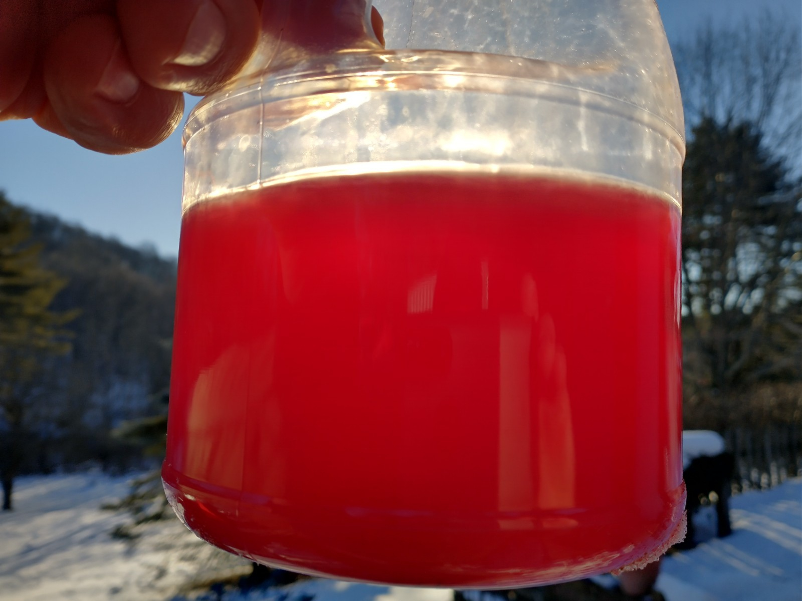

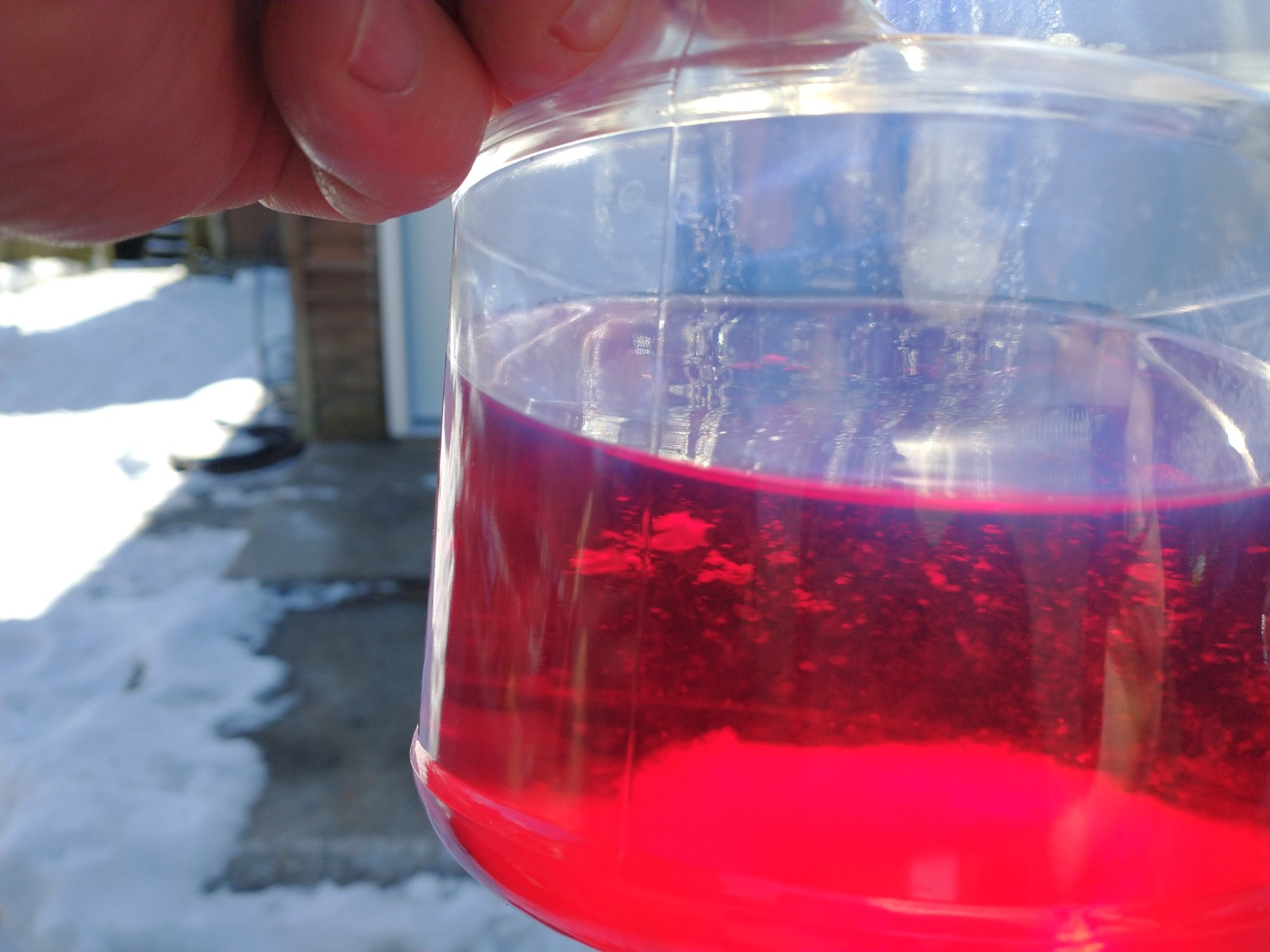

Interesting fuel sample pictures;
yesterdays at 5F,
this mornings at -14F,
definitely some paraffin particles floating around, looks to me like it would be a filter plugging product.
My tractors don't have to run today fortunately, this was #2 fuel with a double dose of Power Serve in the white bottle.
Fortunately the two diesels that have to run today to feed cows had kerosene added to their tanks Wednesday to make them 50/50 treated #2 and kerosene (#1). They started this morning and have been going for about an hour so far today, no phone calls so all going good at this point.
It confirms to me that a blended fuel is necessary below zero even with additives.
Hope everyone has a good day and stays safe and that their tractor run good.
