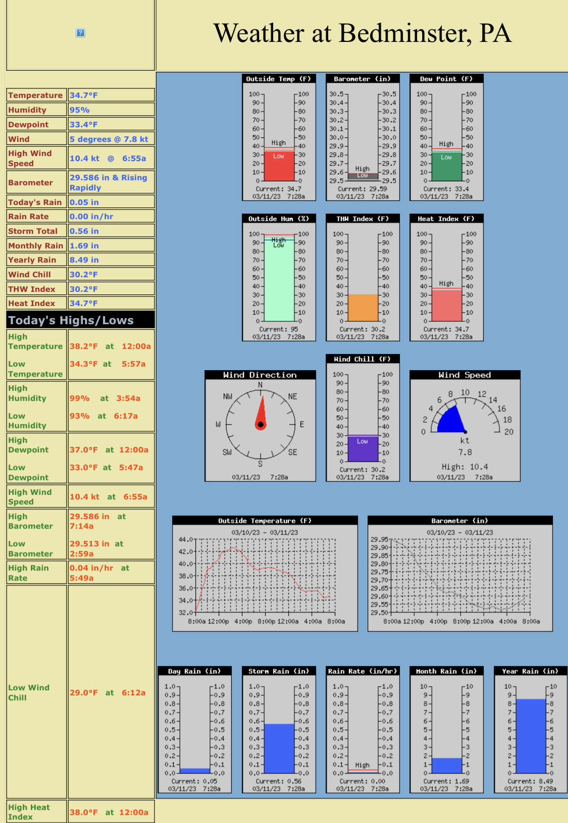

Here is what the Davis weather station has to report-

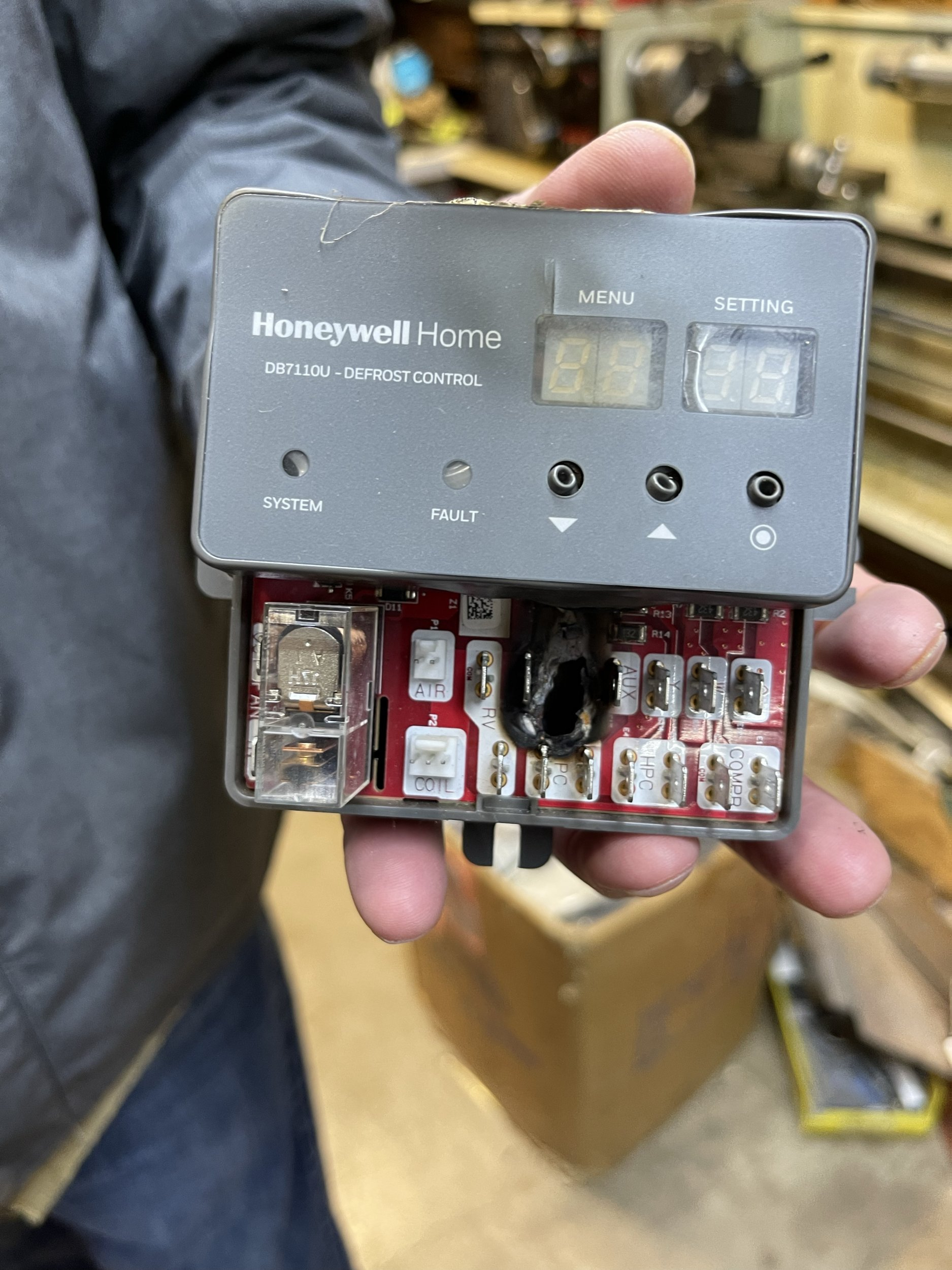

It started in the shop getting a speaker ready for pick up, it’s new owner was on his way from Washington, DC, about a 3 hour drive. Noticed that it was getting cold, and that the heater wasn’t running. Digital thermostat was blank. That system has a fairly complex control system, the thermostat is connected to the furnace with only two wires for power, all of the control functions are by “Red Link” RF communication to an interface on the furnace. Also connected wirelessly are indoor and outdoor remote sensors and internet gateway.

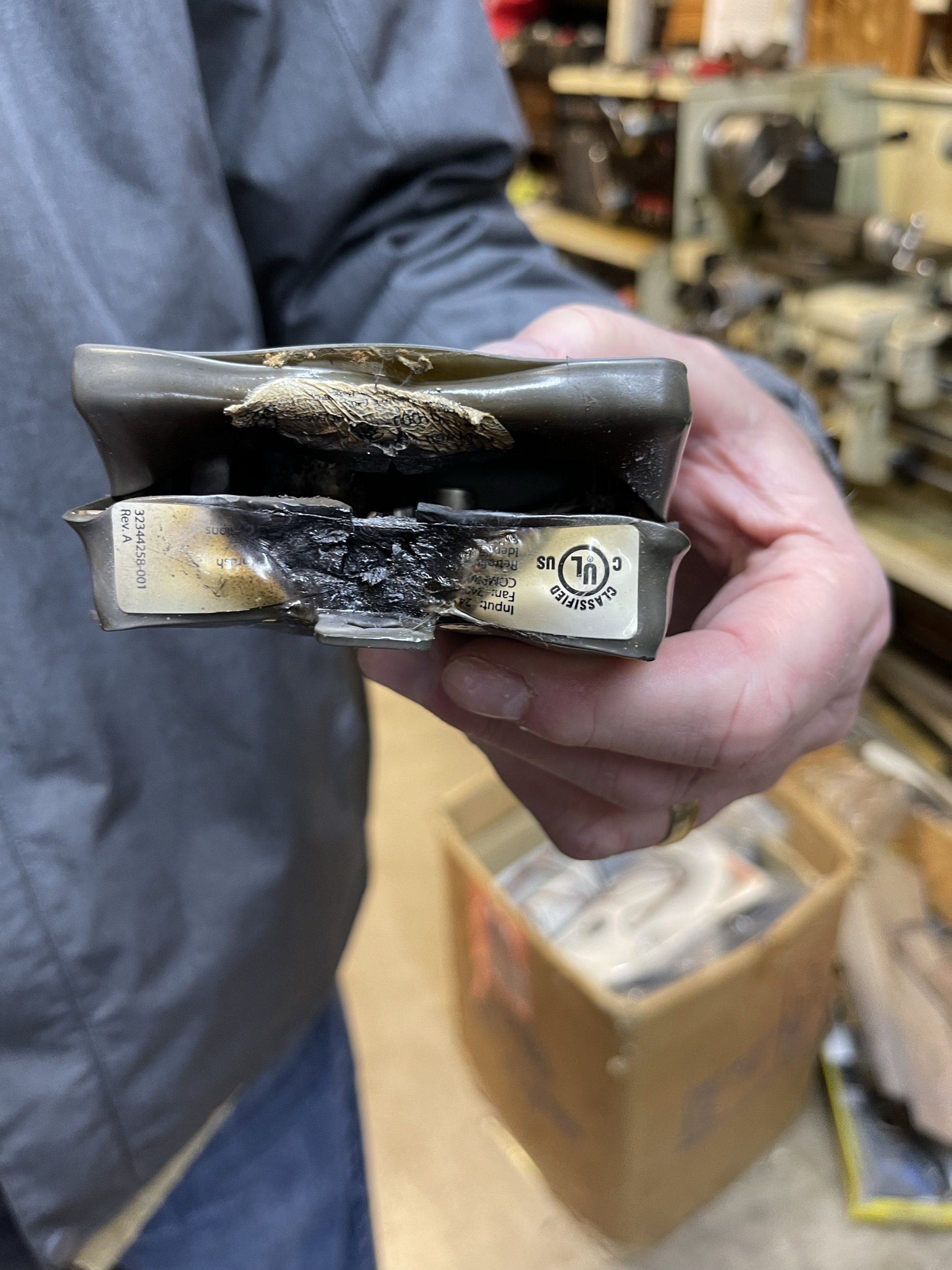

In the process of sorting it out, I got a shock from a “low voltage” wire that was at least line voltage measured by my calibrated fingers.
Considerably more investigation revealed that a 24volt wire chafed against a 240 wire and rubbed through the insulation connecting them together, basically frying all of the connected 24vac devices, thermostat, interface module, defrost controller, and contactor.
Keep in mind that my customer is on his way to pick up his speaker that still needed my attention, so I fired up the propane furnace with test leads with alligator clips. Upstairs was comfy the whole time, as the Mitsubishi was unaffected.
Speaker was ready when it’s new owner arrived, he was ecstatic with it.
Got back to the HVAC project, got new thermostat, interface module and defrost control all installed and programmed. So now I have heat controlled by a thermostat. Still have to replace the contactor in the condensing unit before I have the heat pump back on line, I’ll wait for the precipitation to relent before I attack that.

Paul, that's a really nice weather display.
geez, glad you didn't have a fire from that heating system short.

YIKES on the heating system short. Bad electric runs?

Getting full voltage into the 24 volt control wiring is really scary. Glad you are safe and no fires resulted from it. Wondering if there are other places along the control wires at risk? Good reminder to check on the Yukon basement furnace wiring.
