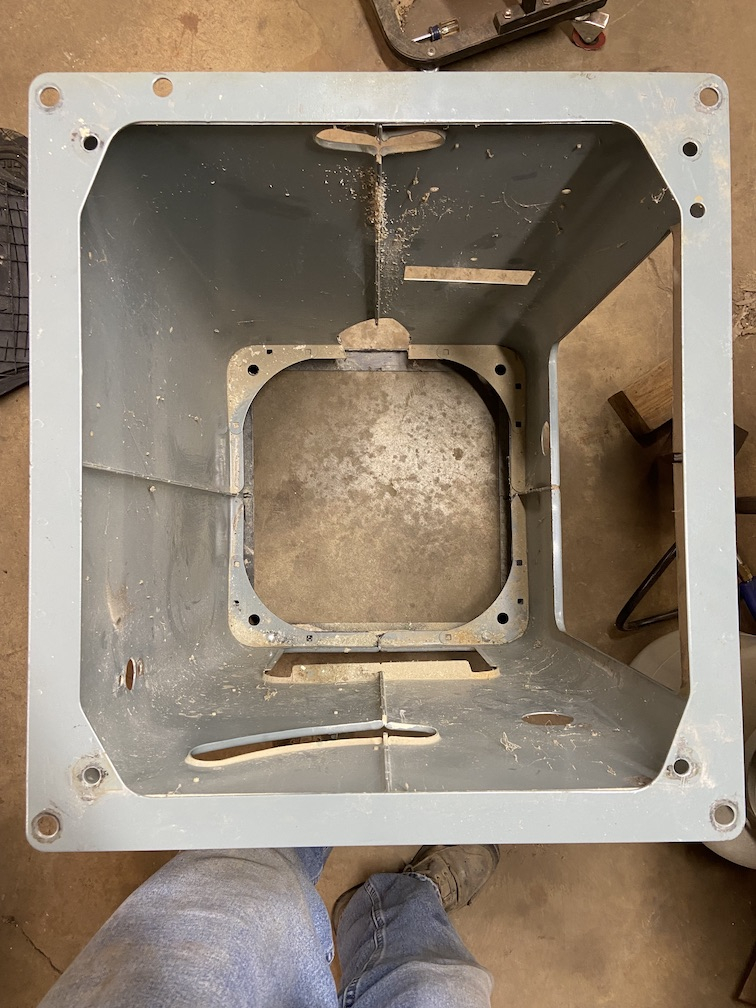

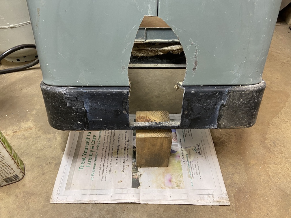

Still working on getting all the silicone rubber removed from the Unisaw cabinetry but making progress ... just a little left to go:
Taking a little closer look at the black base of the saw, it seems like there was square dust port from the factory as original equipment ... so not real clear to me why someone would feel it was necessary to hack the cabinetry.

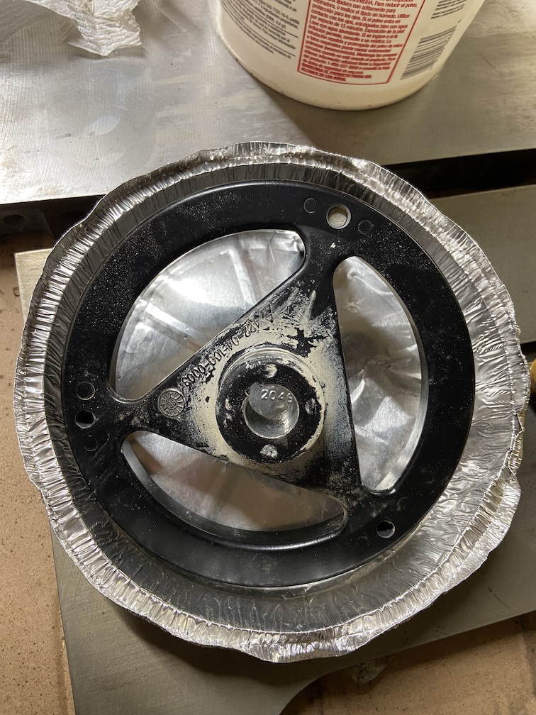

Did a little scrubbing on the hand wheels for the blade tilt and raise/lower, also cleaned out the bores with a fine stainless steel bore brush for a 12 gauge. A "before" pic:

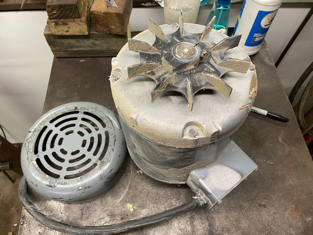

Got the little welding table cleared off and started tearing into the 3 phase motor. Will need to do some further reading on that before I go any deeper:

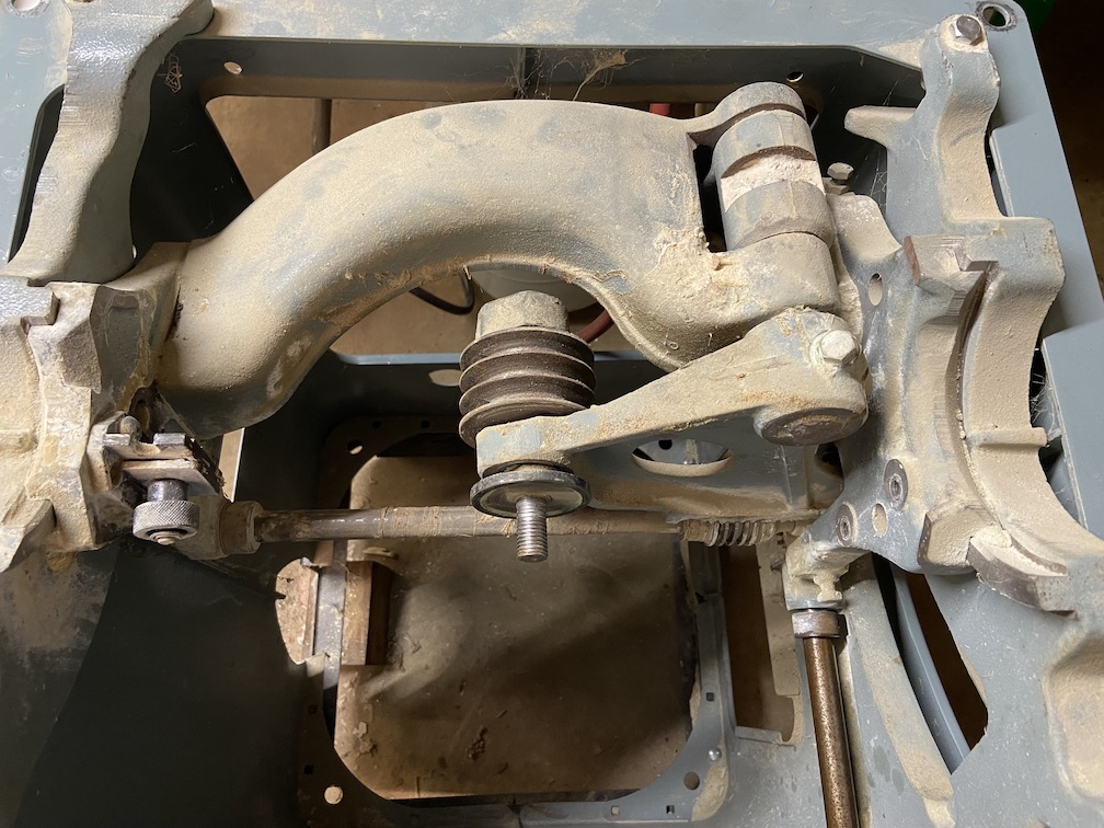

Finally bit the bullet and pulled the guts of the machine: front and rear trunnion brackets, trunnion itself, blade arbor and motor mount ... along with two worm gears and shafts:
A bit tricky for one person to do alone (wouldn't want to drop any of those castings on the concrete) but manageable with care.
These old machines aren't terribly complex and can be gone through and rehabbed without too much difficulty by someone who possesses reasonable mechanical skills. They are rather durable apparently.

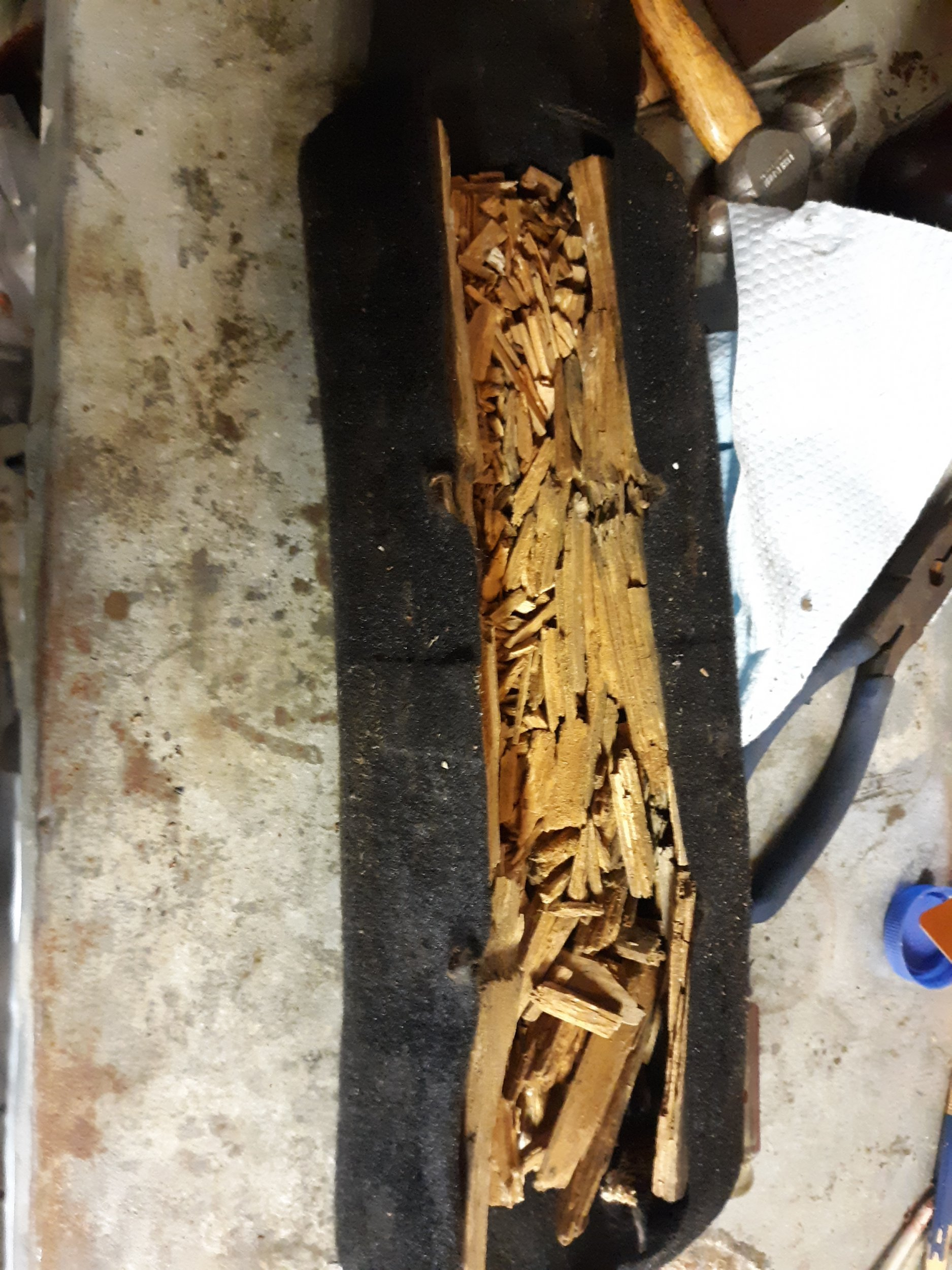

Good evening all. 47ºF for the start, partly cloudy, light breeze. Light wind day, sky went to full overcast and high temp was 71ºF. Slow start to morning did get trash to curb. Decided to repair boat trailer guide, after removing carpeted wood and opened carpet up, I found the 2X4 and took a pic. Hard to believe lag bolts and staples still had grip in what was left of the wood. Did not check ho;e location in carpet so had to cut new holes :(. Any way new guide back on trailer. Went for bike ride after lunch, then lat nap, then late supper.

Mostly, particle board 2 X 4 used in a wet environment. (n) Not good.
