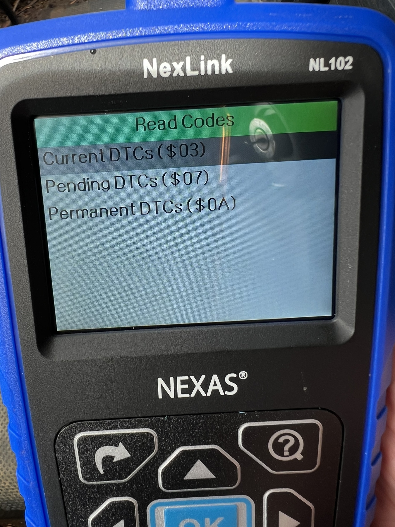

No joy with my OBD2 code reader. Did a good job showing running info, but not reading any codes.
Not should what this really means and choosing any provided no info. Proprietary?
I did exercise it to the point of repetitive stalling which I suspect is temp related rather than wire rubbing on frame.
When I worked on some car stuff a few years ago, there are standard ODB codes for certain common things (like emission stuff for shops to fix), but most of the important stuff being communicated on the CAN bus to the ECU is proprietary, and you need a system from the manufacturer to read them. But I'm not an expert.
here's some reading on the subject:
Some times the CAN bus signals can get distorted by dirt or connector issues. Not sure what the tractor ECU is connected to but maybe cleaning connectors could help? Just an idea.
john deere CAN bus issue: This deals with resistor used to terminate the CAN bus, normally two 120 ohm in parallel, or 60 ohm on each (Low and High) if one goes bad, CAN bus can't communicate as signal echo's back down the BUS distorting the signal.
think i'd start by just cleaning all connectors to the ECU, you never know....
another good discussion.
more good reading:
   / Good morning!!!! #192,126
Thanks, Dennis
I don't know how indepth the CAN network is on a tractor, is it just 1 primary ECU, and CAN just to interface via OBD. THe DEERE video implies a network, which means multiple ECU's, and the possibility for attachments to also get connected via CAN, such as sprayers etc..
On Cars there are many ECU's like for brakes, signals, throttle, engine control, emission, etc.... that all communicate with each other, at least to the master.
   / Good morning!!!! #192,127
Near as I can tell, the LS has a single ECU with multiple sensors
Sadly, can’t find a lot of info.
