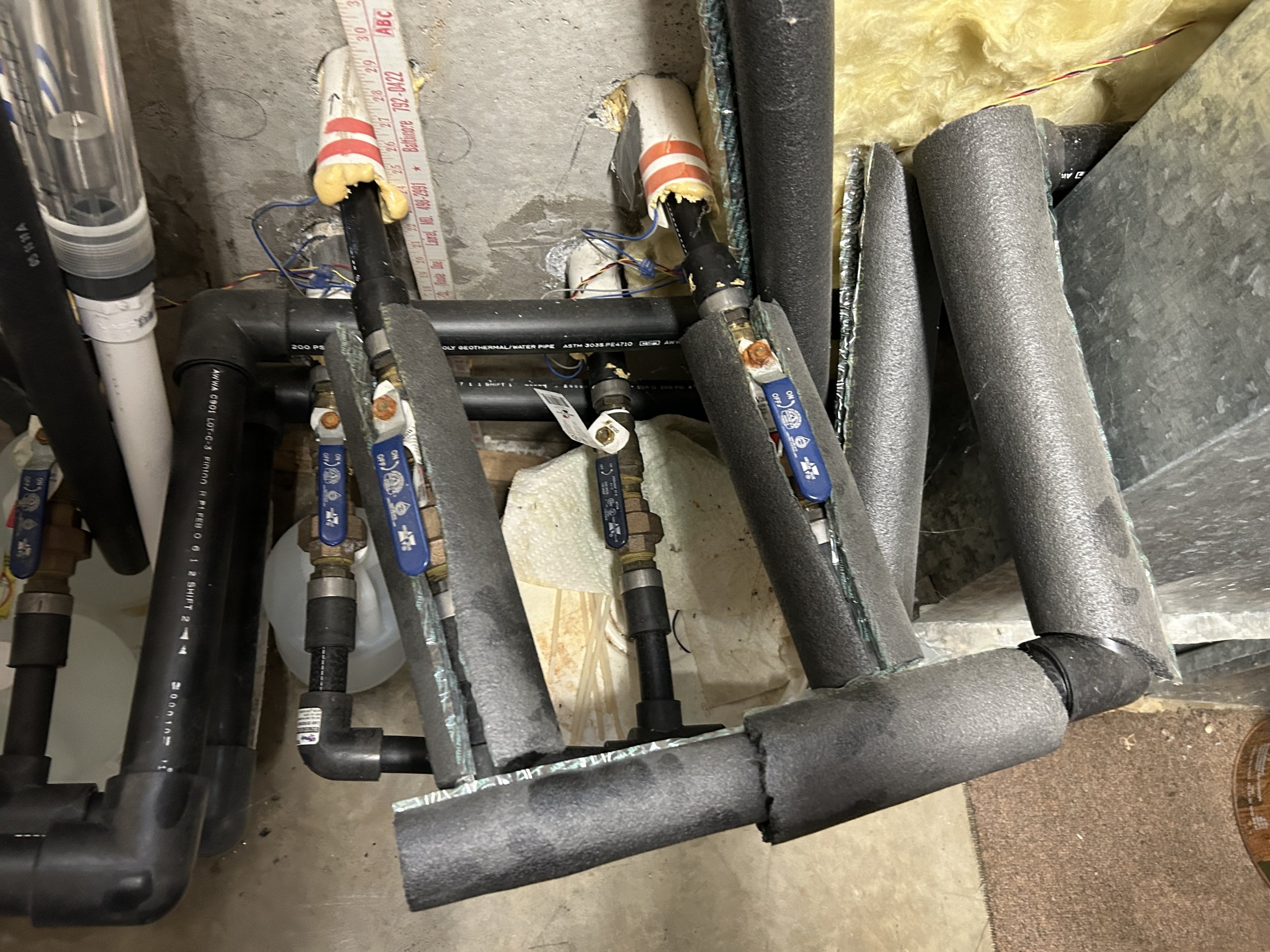

Noticed my one set of geothermal pipes have been pushed into the house, must have been from ground settling outside. Not an easy fix. Should be above the bottom set.
They are sleeved thru the concrete wall. no easy fix. It's the first outgoing loop. I would have expected it to pull, not push in by settling, and it's been over 10 yrs now without doing this.

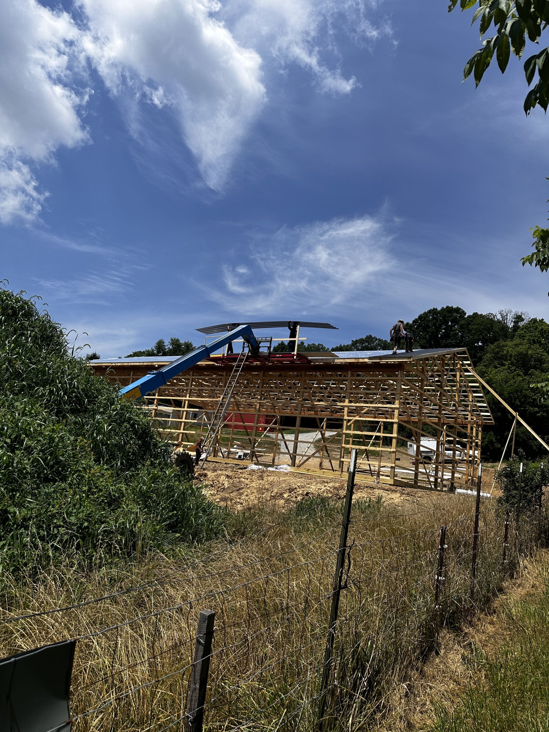

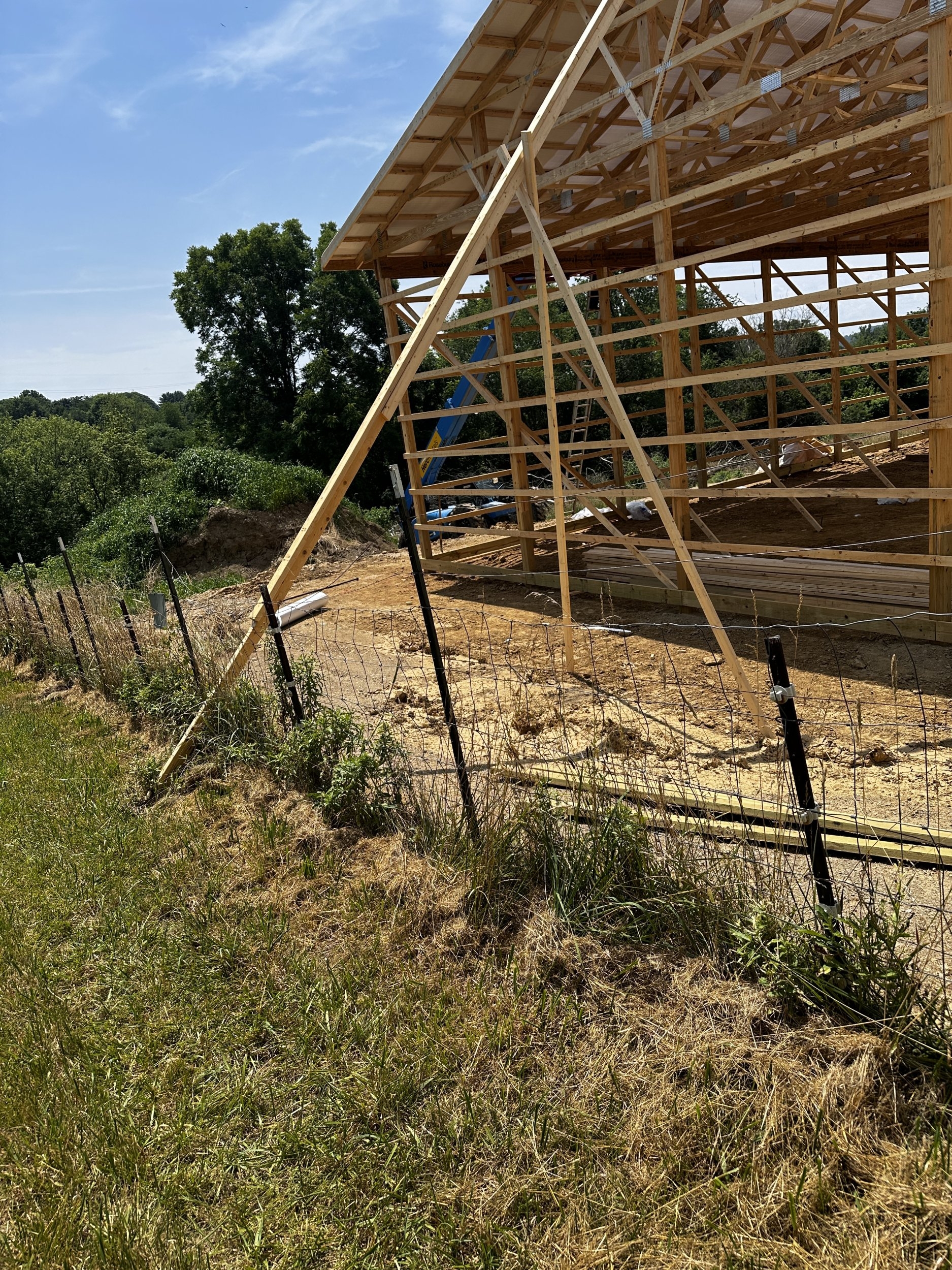

The pole building is now being roofed with an insulation layer under the metal sheets. They probably wanted to use more of our property but ended up using a little inside our fence without asking despite signs with no tress passing.
If you cut the vertical pipe above the bottom pipes elbow and add 2" or so to it, wouldn't that level both of the pipes?
picture is turned sideways, I went back and rotated the picture. that's outgoing header for my upstairs unit. I could shorten the red pipe, removing the amount it pushed in. That involves draining the loop (can shut the other one off), cutting and fuse a new pipe coupling and then refilling with glycol and water and purging. purging is easy because I can shut a loop off, which is why I did an inside header. I also put a union after the valve, that will make it easier also. Would have to do it between seasons when i don't need heat or AC upstairs. very limited window. Actually the hardest part is finding enough glycol to refill the pipe.
As i think about it, I won't have to lose that much water in the loop, as long as i can fuse a new end on the pipe, water can stay in the loop.

BEF, I think you've got it figured out.
Which glycol is it? Ethel or polypropylene?
Propylene

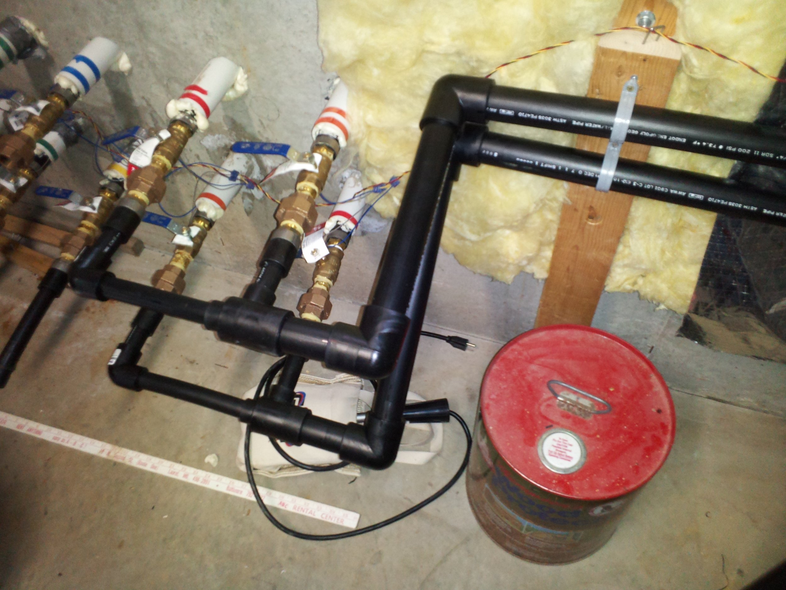

looking back at original pics, even the other pipe is pushed in some, and a couple on the other unit. The fuse joint was pushed back in the sleeve, now is 3-4" out in places. here is original pic.
