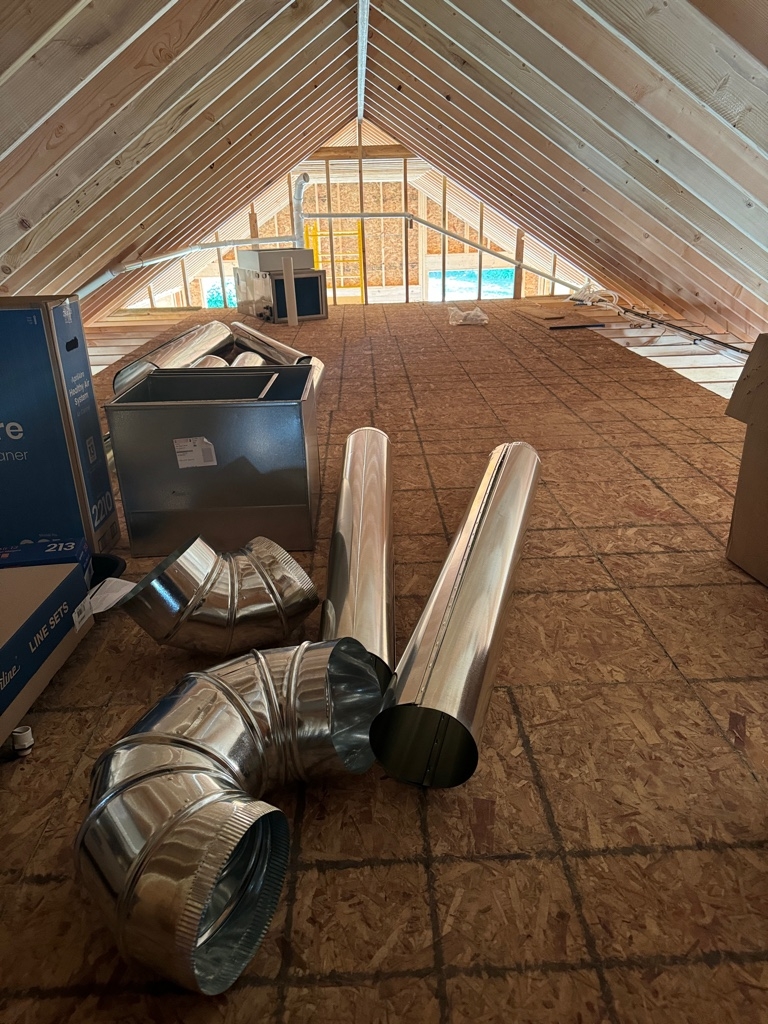

Made great progress on the old folks home yesterday, a good portion of the wiring is done, lots of studs drilled and wires pulled. I don’t regret delegating that work to an electrical contractor, although it’s something foreign to me.
I got a good start on the radiant heat boiler plumbing, cutting and fitting copper, none of it is soldered yet, I want to get it all fit up first. There is a lot going on in a little space.
I got all of the ductwork bits and pieces delivered, and up into the attic along with the air handler, so that will be next on the list after the plumbing is wrapped up.
It was most unpleasant up there with the heat and humidity.

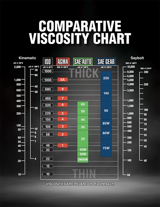

I'd be tempted to use a gear lube, my preference is 75W-140 for yours something like
AMSOIL SEVERE GEAR® 80W-90 100% Synthetic Gear Lube​
It is interesting to compare the viscosities of the various fluids
with SAE 30 motor oil is right at the edge between 80W and 85W gear lube.
