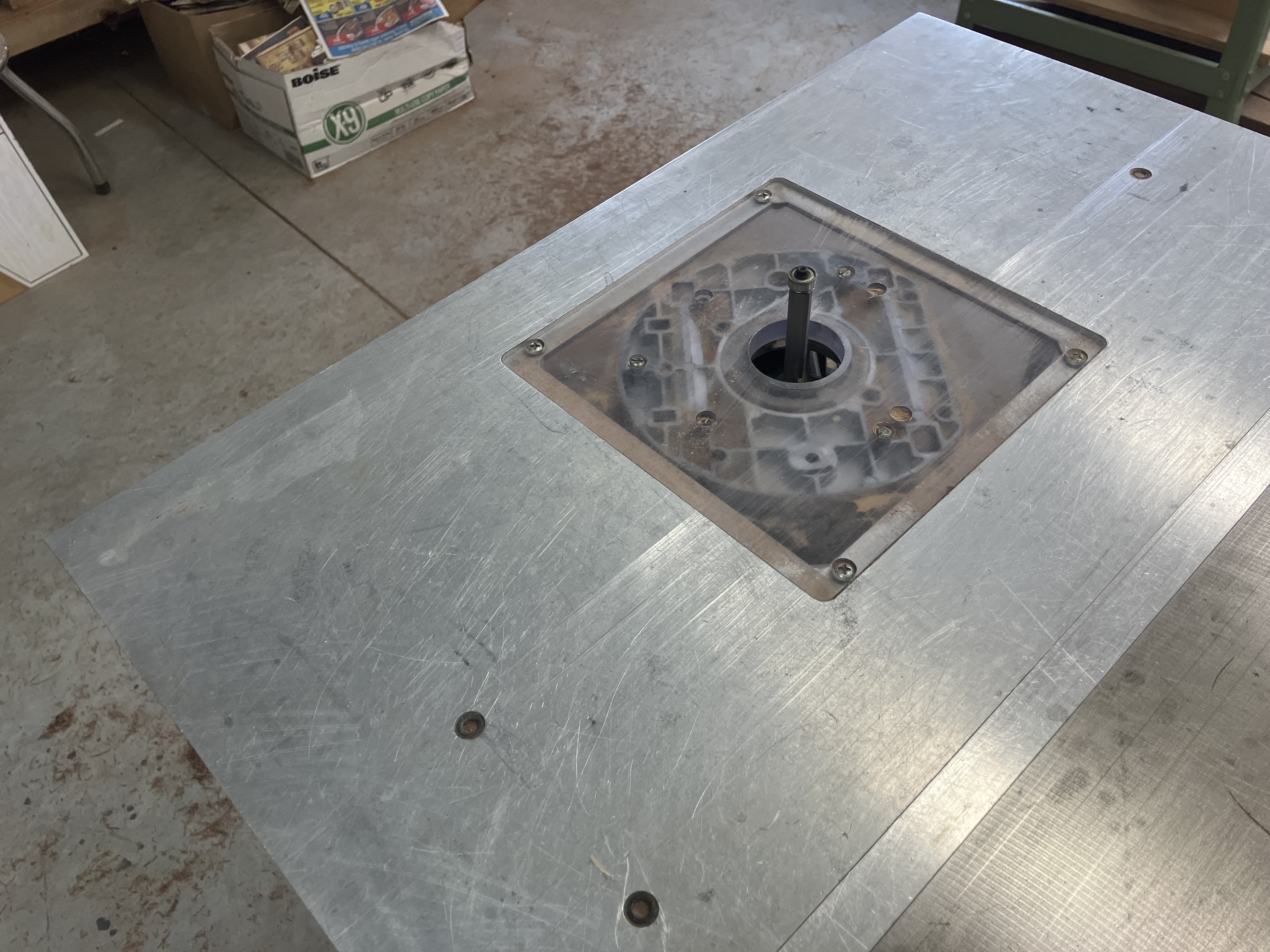

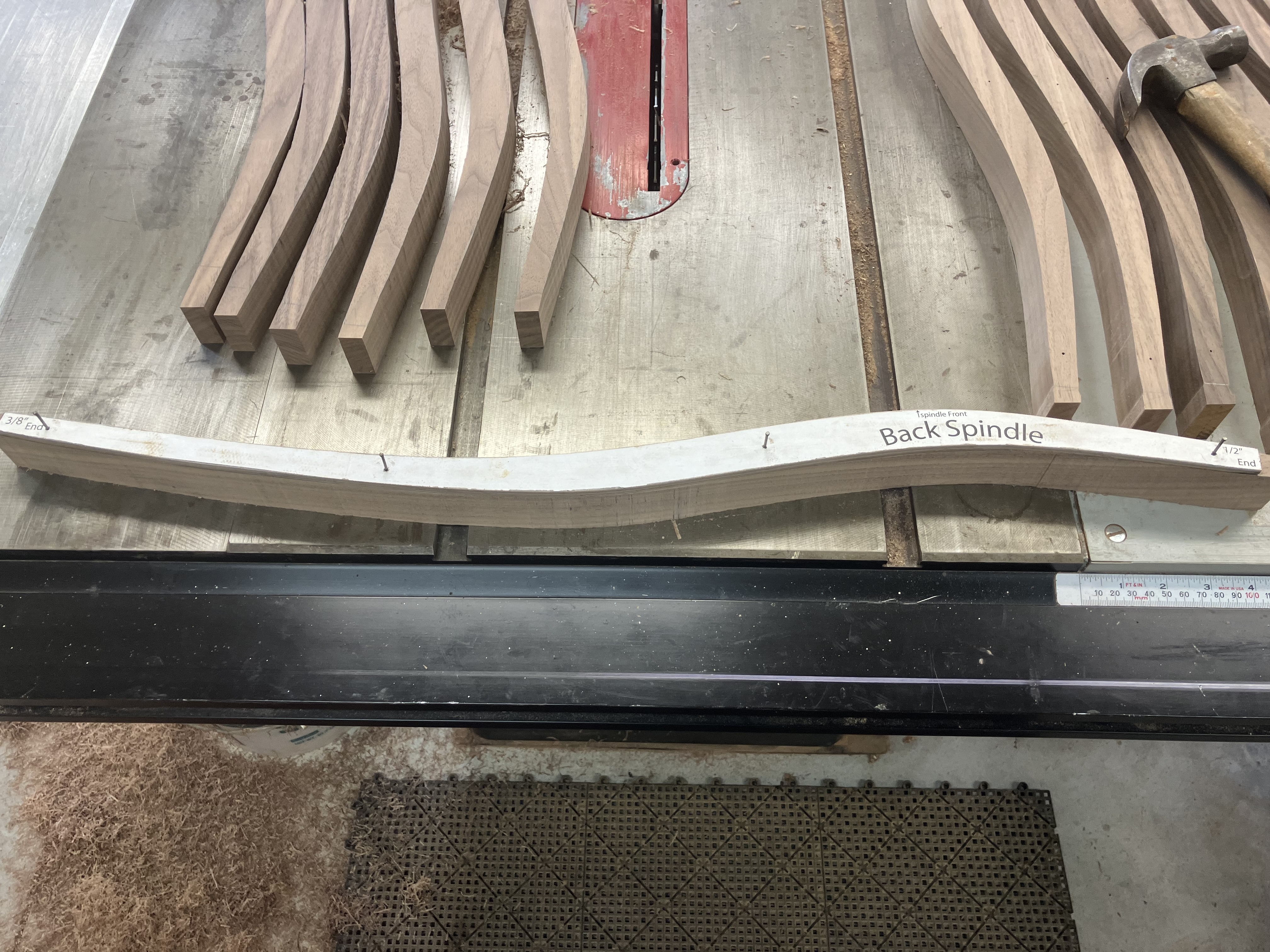

Good Afternoon,
Some shop time today, needed to come up with an idea to transfer the exact shape of the pattern to the band sawed spindles. Drilled 4 , .060 holes through the pattern and then tacked it onto the rocker spindle with tiny finish nails with the same diameter. I have a 1/2 by 2” follower bit with the bearing on top to follow the pattern. Seems to be working well.
Years ago while still a model maker at Pitney Bowes I created a router table on the left side of my Delta UniSaw out of aluminum jig plate, works out well for this type of work 😉
