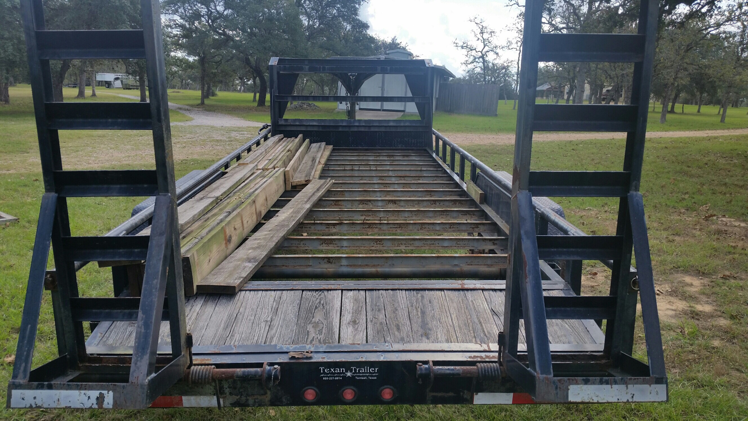

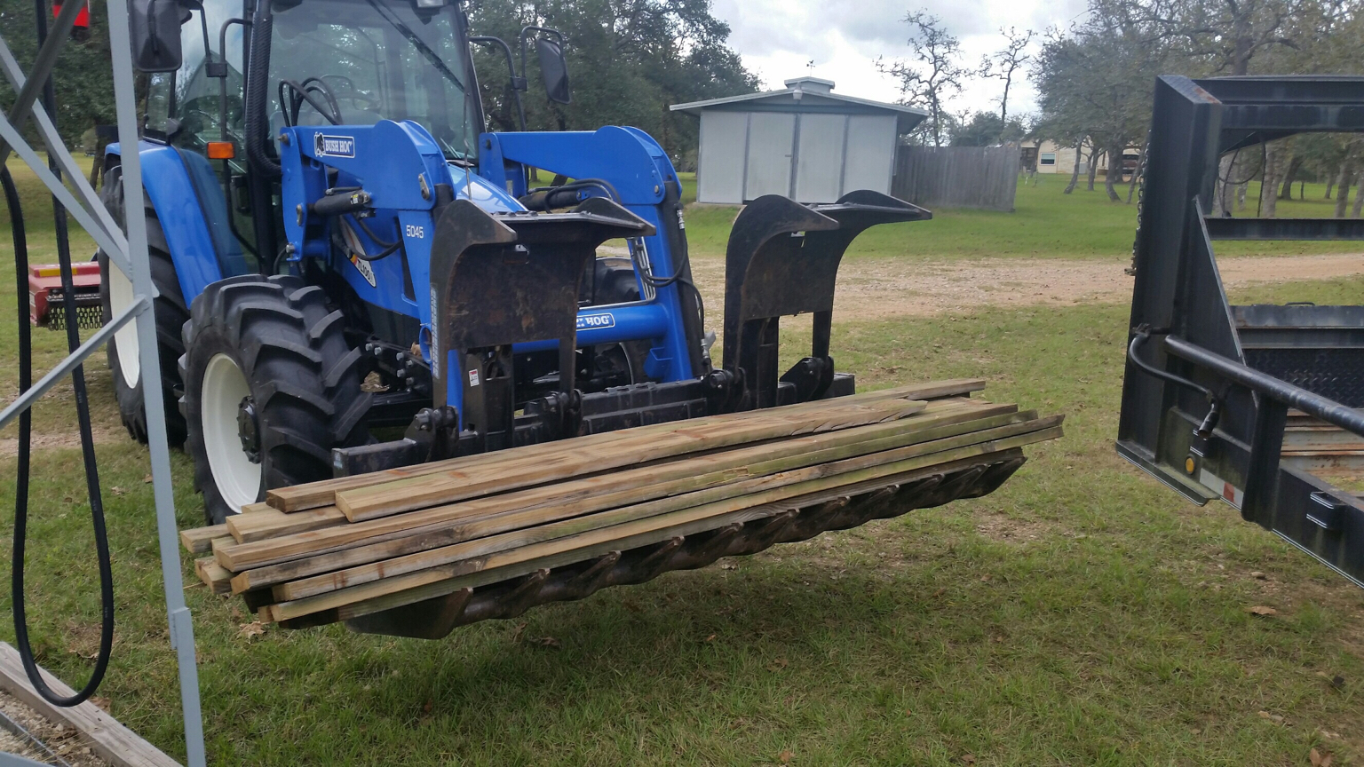

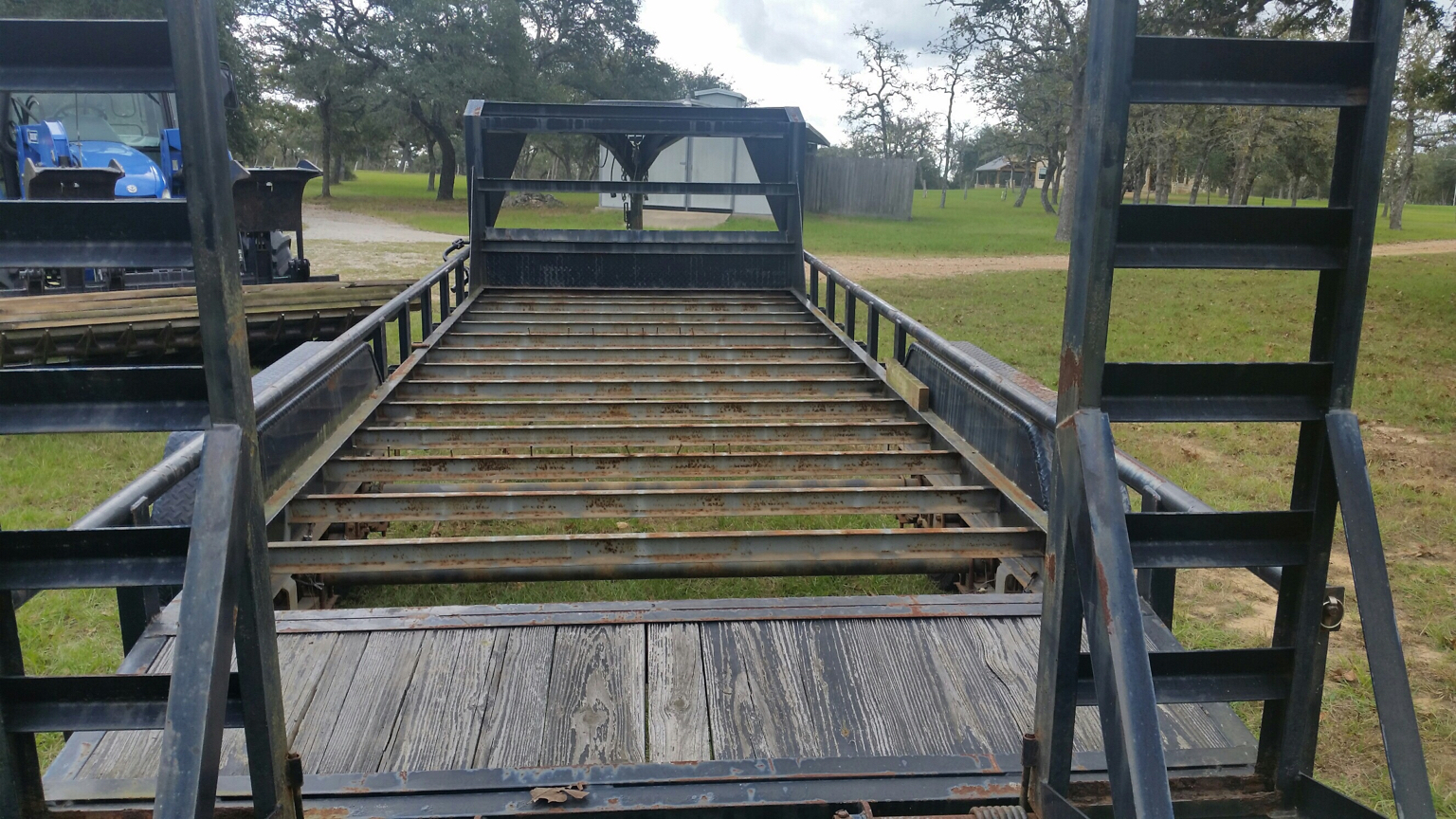

Loaded my 50 HP Tractor on my gooseneck trailer on Monday and broke thru a deck board doing so. The cross bracing is on 16” centers so, no issue.
Decided today to remove the entire deck and replace same with new grade 1 PT 2 x 8’s. This trailer is about 11 years old so, not unexpected that the original deck boards were failing. Doubt if they were even grade 2.
The original deck boards were secured to cross bracing with 2 1/2”screws with non-coated Torx head screws. They are kind you must pre-drill hole for each screw.
I’m looking for ideas on coated #12 x 2 1/2” self tapping screws, Torx Head, similar to the TEKS Coated screws.

Consider pre drilling and using stainless carriage bolts with poly lock nuts on the bottom.

Thanks Kyle. Pre-drilling and crawling around under trailer, is the step I’d like to avoid. McCoys has some ceramic coated self drilling trailer deck screws but ...they are Phillips head screws. I consider them fair to install, terrible to remove in 10 years. I know there has to be similar coated screws with Torx heads?
The original screws, on this trailer were rusted but, a few (maybe 1/2) could be removed with impact driver and Torx bit. Some just broke off. On others the head was badly rusted and bit just spun.
Will be grinding off the screws I couldn’t remove or broke, manana.

Rick, consider square drive screws. Our Canadian neighbors call them Robertson drive screws. Other than time consuming. I would pre-drill and tap all the holes. Then put anti-seize on all the screws when installed. You will need good quality galvanized screws for treated wood.

Rick, sounds like you're doing a really good job on the trailer, so hopefully you won't have to repeat in 10 years.
