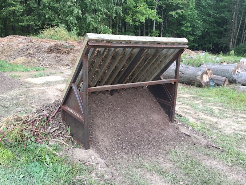

Here's a pic of the soil screen frame with the 1" screen on it:
I actually made an error in my previous description ... the 1" screen has the most 2 x 4's in it ... looks like one every 6" O.C.
I think I did that because I was going to be using it to screen stuff that had some pretty good sized rocks in it and felt it needed the support.
Looked at the gravel screen yesterday (buried behind stuff in the barn) and I think the spacing was 12" O.C. rather than 6" because there really isn't any large rocks in it and I can control the rate at which I dump it.
You can see some of the grass/weeds that gets caught in the screen.

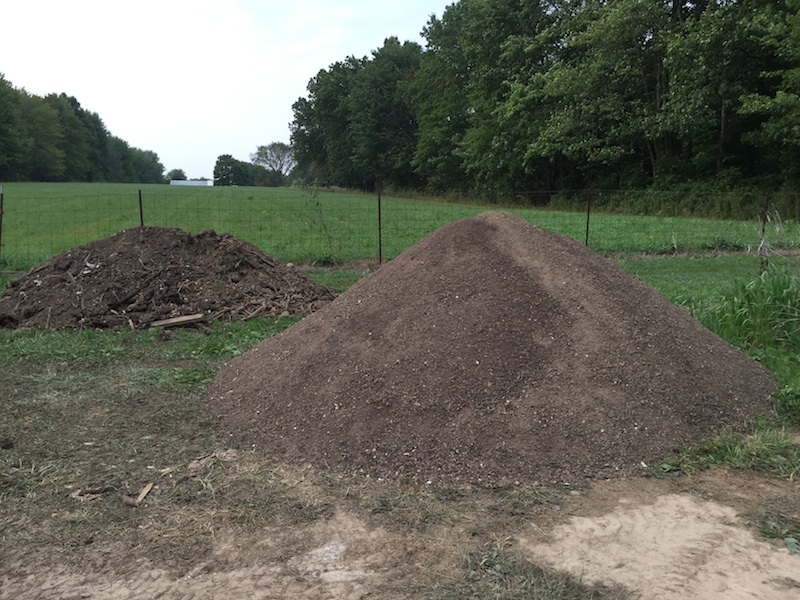

Here's the results. The screened pile in the foreground is about 5' tall and 10' in diameter:
The pile in the background has been through the screen several times and still has a lot more in it that could be sifted out. The majority of the screened material isn't any larger than probably 1/2" to 5/8" generally.
The frame that the screens sit on was built from 2 x 2 x 1/8 wall square tube, 10 gauge sheet, and a couple of pieces of 3/8" x 3" (?) x 6' long angle for the two runners on the bottom ... plus a few short pieces of 1/4 x 2 bar stock to keep the screens from sliding off. The 10 gauge is probably overkill ... 12 gauge would probably be fine ... but it should hold up long-term. (Same deal with the 3/8 angle runners ... 1/4 probably would have been fine)
Based on my experiences using a wooden frame for the base (and having to rebuild/repair it a number of times), metal should be much more durable ... particularly if you are going to move it.
Will try to get a few more pics. Let me know if the have any questions.

Those are some impressive results, RS. Lots of nice topsoil in that pile, all for some scrap and a little elbow grease.:thumbsup:
Gotta question for you, though. I noticed on the 1" screen, the 2x4s in the middle run from top to bottom. Wouldn't that orientation prevent some material that would otherwise make it through the screen from going through as it rolled/slid from top to bottom on top of the 2x4? Would turning the screen 90 degrees would prevent this and give you a higher yield?

RS, thanks for showing the pictures of your soil screen, you have given me some good ideas there to spend a little more quality time with the welder. As well as soil, I have many tons of roughly broken tarmac to sort for repairing tracks and something like that could probably seperate out the bigger chunks that need crushing nicely.
Main question now is how high up on the to-do list I can sneak that in while maintaining something resembling marital bliss. It is always a fine line between getting the no-real-harm eye roll, or the long stare that has consequences ... no apple pie :laughing:
