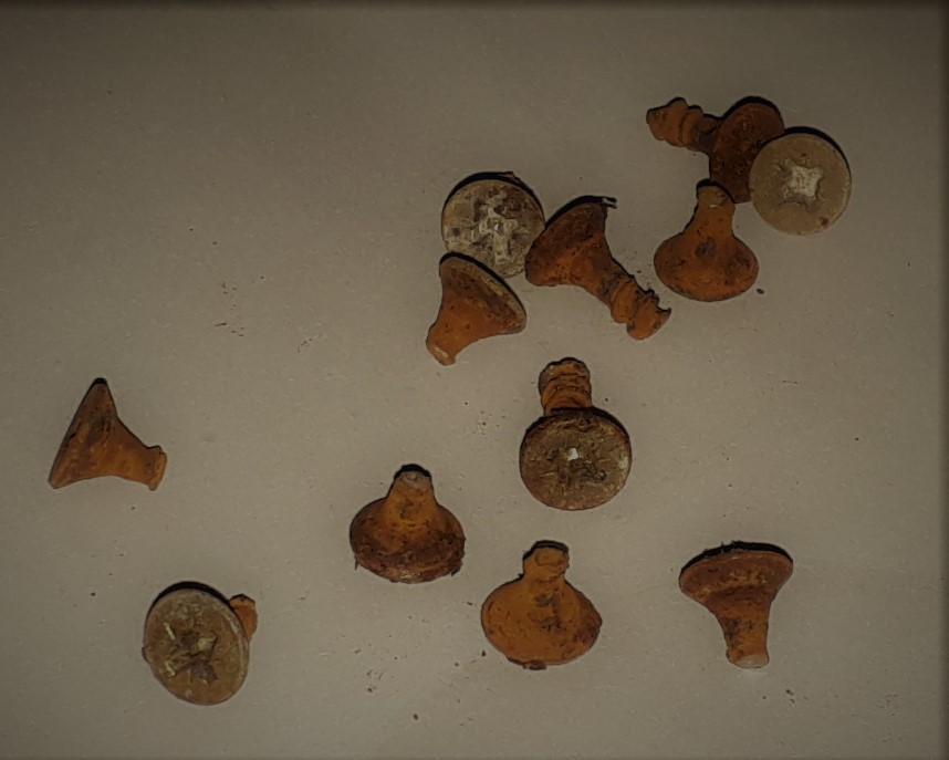

No chance for me to get on here earlier in the day as I had to check on the sheep at first daylight and got back just in time for the arrival of a local joiner, who is also a friend, to help me sort out a mess.
A few weeks ago I noticed that the screws securing a window hinge had rust on the surface. That should have been impossible, as they were supposed to be stainless steel, as I had discussed with the people who made the windows a few years ago. When they were fitted they looked stainless, but I never thought to take one out and test it. Didn't think I needed to, as any company making windows from oak (to keep the planning department happy) would surely know that it corrodes ordinary carbon steel ? They knew, but evidently they didn't care. :mad:
Our windows are quite small, about a metre square (which seems an odd measurement for 18th century openings), but there are quite a few and each far too heavy for one person to handle. It has taken a full day to change the screws on the first 10 windows as almost all of them broke as soon as they caught sight of the screwdriver. Another year and those windows would almost certainly have been falling out of their frame. Hoping for another wind-less day tomorrow too as there are more to do, although thankfully those left are all at ground level.

OMG, Eric, I think I recognize those screws. Over here, they're used to install drywall, they're made as cheaply as possible, and yes, they're carbon steel. They rust easily, and break at the slightest hint of over torque. Were I you, I'd be having a rather stern conversation with whoever installed those things to hold up your heavy, and no doubt expensive, windows...:muttering::pullinghair:
   / Good morning!!!! #84,017
We have the same screw here. SS screws can be had at just about any big box store. Even deck screws would be better.
