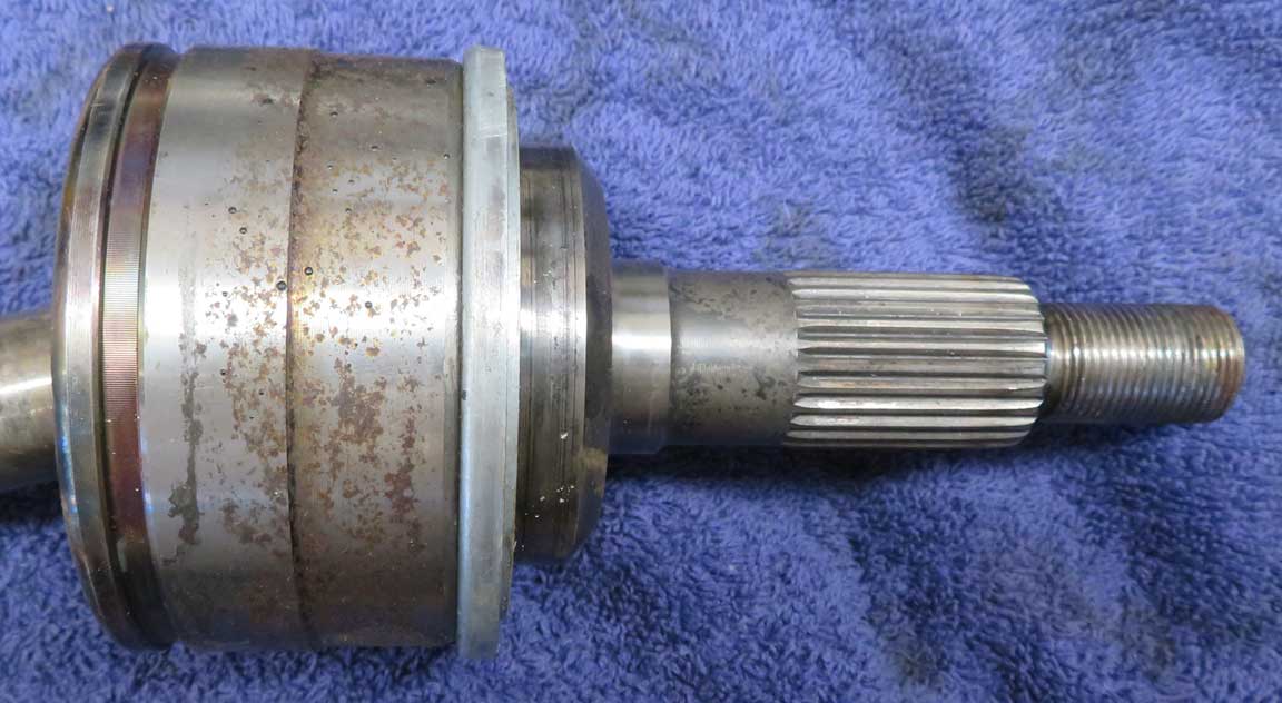

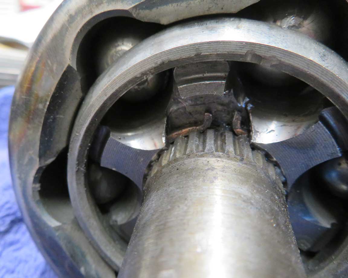

RNG, I'm trying to see what your jack shaft or half shaft looks like?
Here are some better photos, Kyle:
These are the jack shafts. The stubborn CV joints are on the right ends, I was able to get the CVs off the left ends with only a minor wrestling match involving a big hammer and a drift.:confused2:
These CVs are all one piece that includes the splines that drive the front wheels.
This circlip drops into a groove in the shaft when the tabs on the circlip are as shown. Supposedly, moving the tabs apart expands the circlip, forcing it into a groove in the ID of the CV and releasing the shaft from the CV. Seems to me, even with the circlip in the position shown, I should be able to drift the CV along the jack shaft enough to cause the circlip to bind, but I've been unable to move the CV even that far. Just received a 10 ton porta-power, so I'll maybe give that a try tomorrow.:eek:

Be careful there can be a lot of flying metal at that force.

RNG need to know if the bottom of the retaining clip is moving out of the shaft groove, have that issue with some of the circlips.

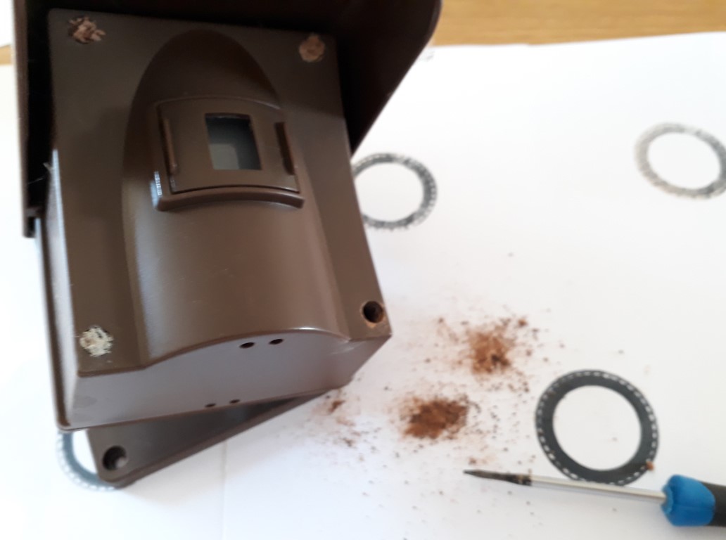

We have a sensor outside to detect when a vehicle pulls into the yard. It has been going off way too often, so I thought I would change the sensitivity switch setting, only problem was I couldn't get into the cover - some insect had filled the 4 screw holes with their very effective home brew sand and cement substitute.
