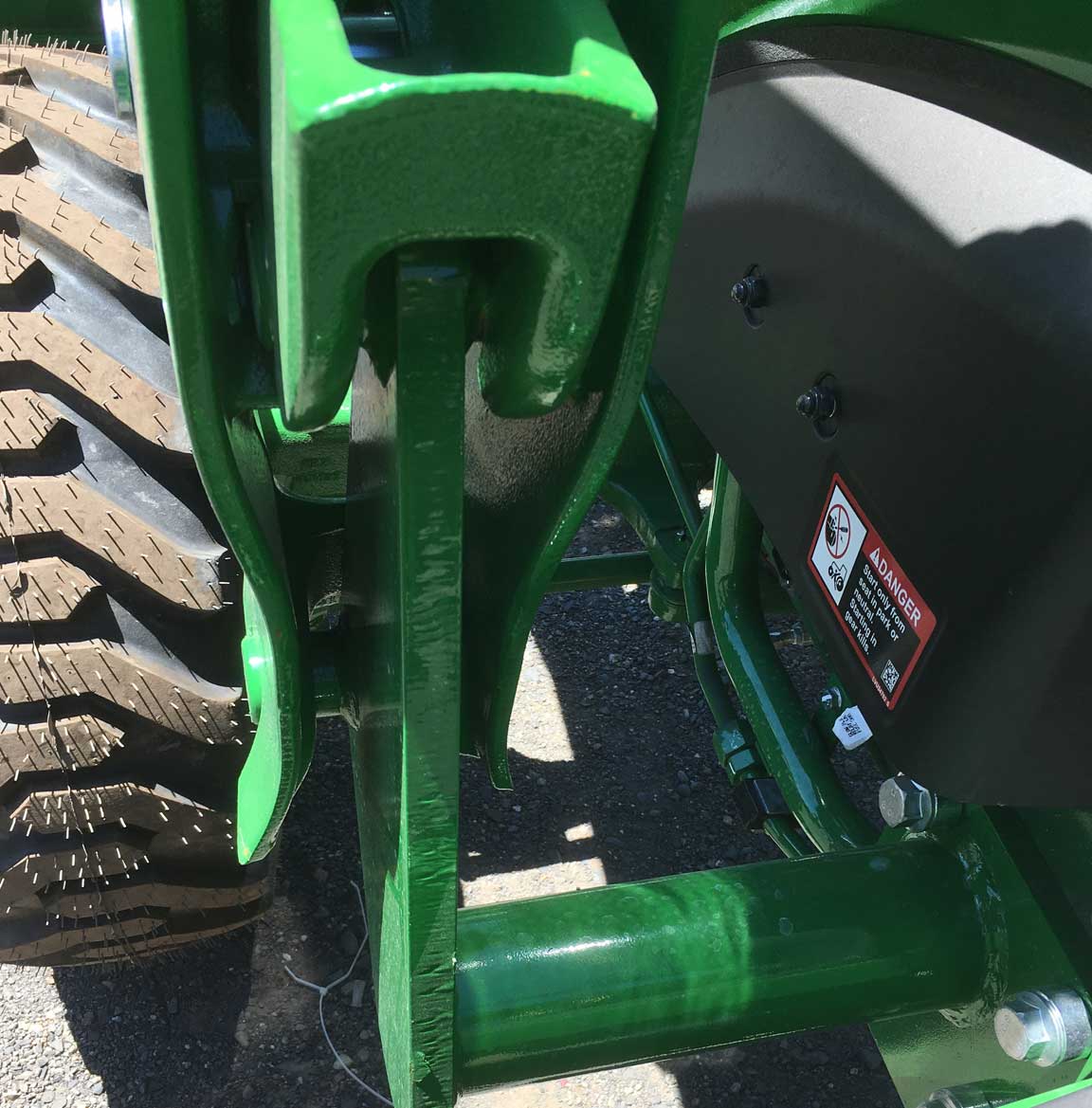

The R can be had open station as well, and that's where my focus has been so far. Basically the same tractor as the M, but the loader on the R can be disconnected by flipping a couple of levers and disconnecting the hydraulic lines, and it has a rotating seat and the Hitch Assist, which allows you to lift the 3PT arms and jog the tractor forward and backwards from behind. It also has cruise control, a feature I've never found useful on the Kubota. I'm going to try to swing by another Deere dealer to look at an M and the loader mounts, and see how easy it would be to dismount the loader. I've done it several times on the Kubota, mostly to ease maintenance and repairs, and though I wouldn't mind removing a few bolts and disconnecting the lines to get one off, if it requires a forklift it would be a show stopper. There's about a $5K difference between the M and the R, a pretty Deere price to pay for a feature that should be standard (pun intended).:D
I was also not impressed the loader mounts. They use a vertical plate about an inch thick and six inches wide, maybe two feet tall, that is welded to a four inch diameter tube at the bottom, which is then welded to another plate that bolts to the tractor. The Kubota uses much the same structure, and I've already seen both arms break from fatigue loading from carrying loads of dirt or gravel in the bucket on a side hill. The tops of the plate flexes about a half inch side to side as the tractor hits bumps and irregularities on the ground. Other Kubota mounts use square or C section uprights and do not have the issue because they have much more lateral stiffness. Look at the photo and you'll see how flimsy the mount looks in comparison to the loader parts.:shocked:

I noted that in the lift height comparison photo of the NH and LS tractors, the NH loader started out higher because it's mounted on a higher tractor. But the loader arms are longer as well, but again that's more because it's on a larger tractor. I haven't needed more than 8' of loader height so far, so I'm not sure that's an important issue for me, but it's good to know that for my *next, next* tractor, bigger is available.:laughing:
An XR4155H (open station) was just quoted at $34K. It would cost $1500 to add port forward for a grapple and top'n'tilt, and another $500 for wheel spacers if I decided to buy 'em instead of make 'em.. About a $20K savings, but no swivel seat, no Hitch Assist, no self leveling bucket. On the positive side, the loader and 3PT have lift capacities higher than the JD, the tractors weigh more (better ground engagement), and same foot control layout as the JD. Enough incentive to make the trip to that dealer and take a look. I wasn't at all impressed with the dynamics of the JD loader; maybe the LS will be more responsive?
In the mean time, the JD dealer finally admitted they do sell a loader with a self leveling bucket, but it would have to be ordered separately, and cost substantially more. I'm beginning to wonder if ol' John didn't pick green for a reason: it seems you have to be made of money to afford one. :laughing:
