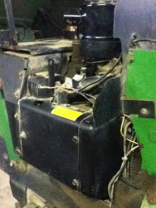

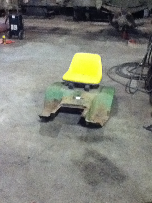

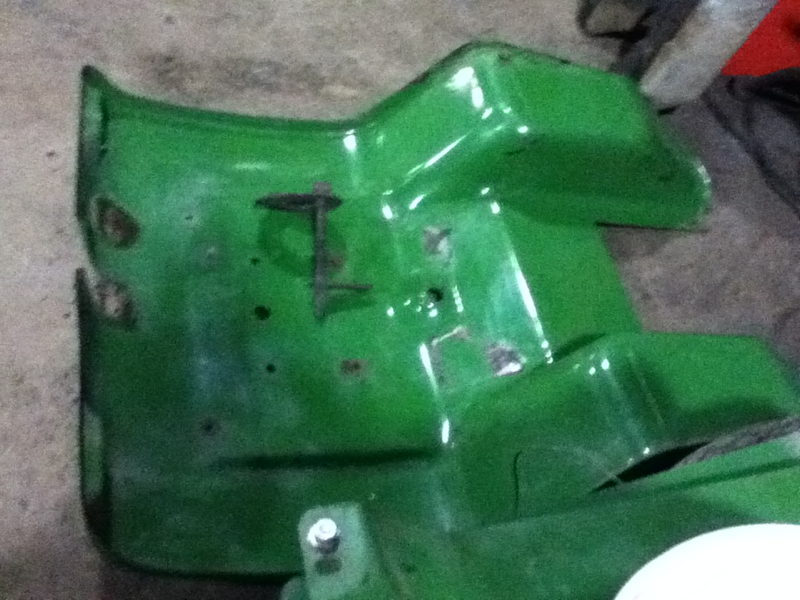

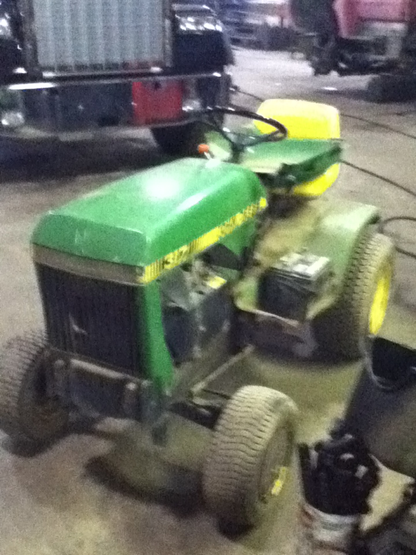

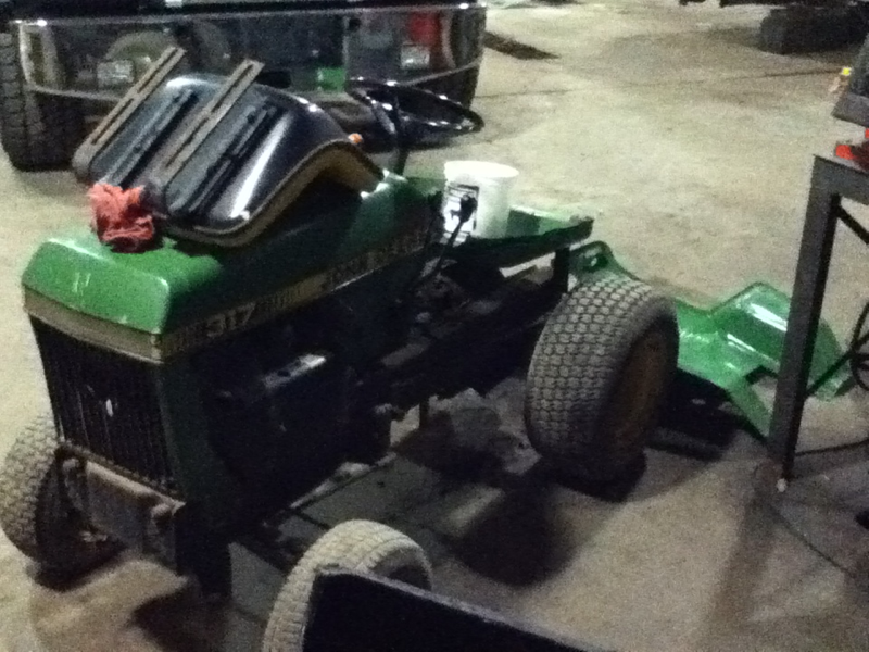

Ok, got more progress on it today, pulled the rear sheet metal off and cleaned it, got the battery, and found the backing plate for one of the brakes, The right hand side brake has some problems, gonna clean the seat up tomorrow, drain the fuel out of the tank, can I use 10w30 motor oil in it, instead of Turf gard?? Not sure of the difference... It really needs to be pressure washed, and my grandfather wants to basically strip it down after we get it running, and repaint it! Also need to get new lines for it, at the hardware store.. Probably get some of the decals too, and fuel and amp gauges.....
   / Good Motor to replace a KT17 SI?
#26

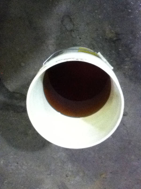

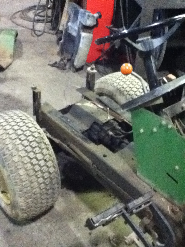

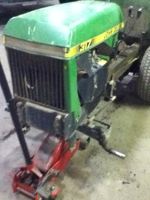

Got even more progress. Jacked er up and removed the front tires, and all 3 hubcaps, cleaned one of the front rims, and I am looking for those "star-rings" that go on the backside of the dustcap. Ive been looking online but havent found anything. Can I get that from JD? i drained the fuel, it was red.lol!!! Need to get the line, and also brake shoes from JD?? when i get the coil, i'll try to get it to start!! Thanks for everyones help so far!!!! Figured out how to put pics on!
