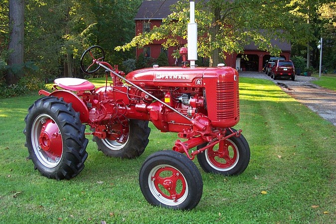

Mornin Andrew,
I have also bought paint from Valu-Bilt Tractor, a gallon of enamel is about $25.00 and fairly good quality. It will need to be thinned slightly and you can also add hardener for a lasting job. I use a Porter Cable HVLP gun and it does a descent job.
The last job was my 49 Super A.
